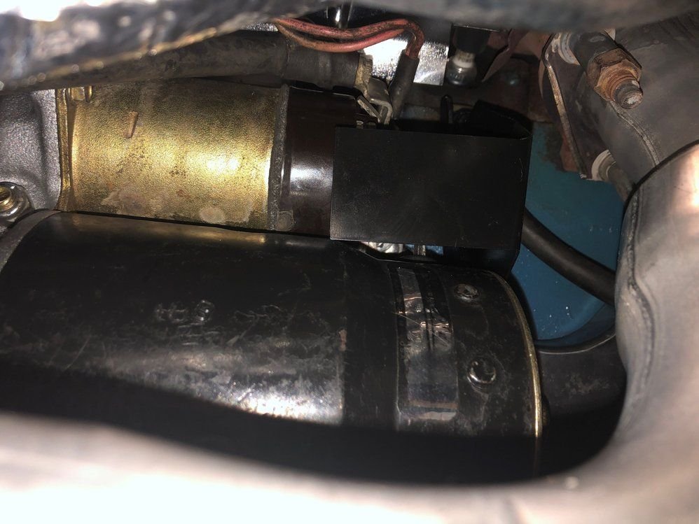

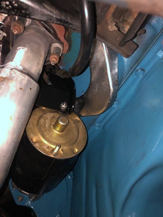

Took a look under the car and got more confused now. Bolt pattern is staggered so thinking it's a 163 tooth flywheel. Worried that I won't find the right starter since they seem to have housing around the gear where mine goes into a housing kn the car. Anyone know which part I should look into buying?

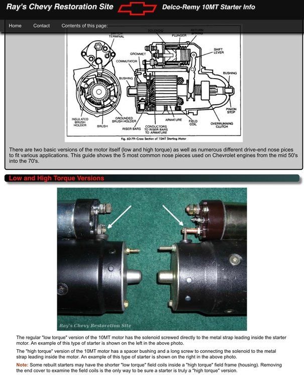

That's a staggered pattern (aka diagonal) Delco Remy 10MT starter in the above pic. this vehicle almost certainly has a 168 tooth flywheel or flexplate (there's no 163 tooth choice). The smaller flywheel/flexplate has 153 teeth but those starter mountings typically have a "straight-across" bolt pattern. While this "staggered" bolt pattern is typically for the larger diameter 168 tooth flexplate/flywheel.

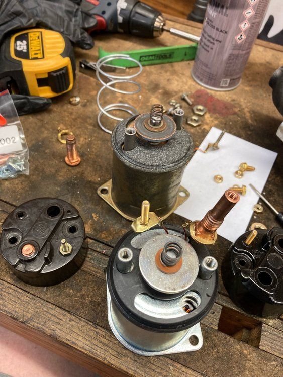

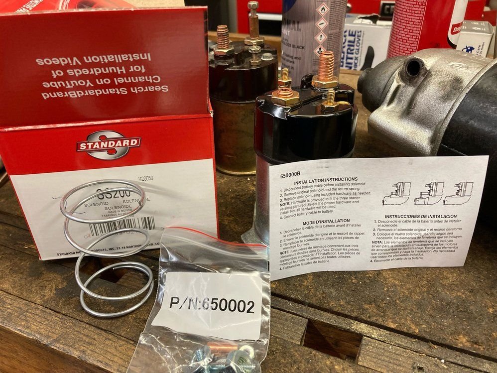

you can swap your brown cap to a new guts solenoid. Starter easily inspected too. I tried mini starter and failed because i was not willing to modify the wiring to fit mini. My experience here

i forgot op..i added oem heat shield as mine was missing as well. Pretty cheap from vendors, simple sheet metal but effective.
