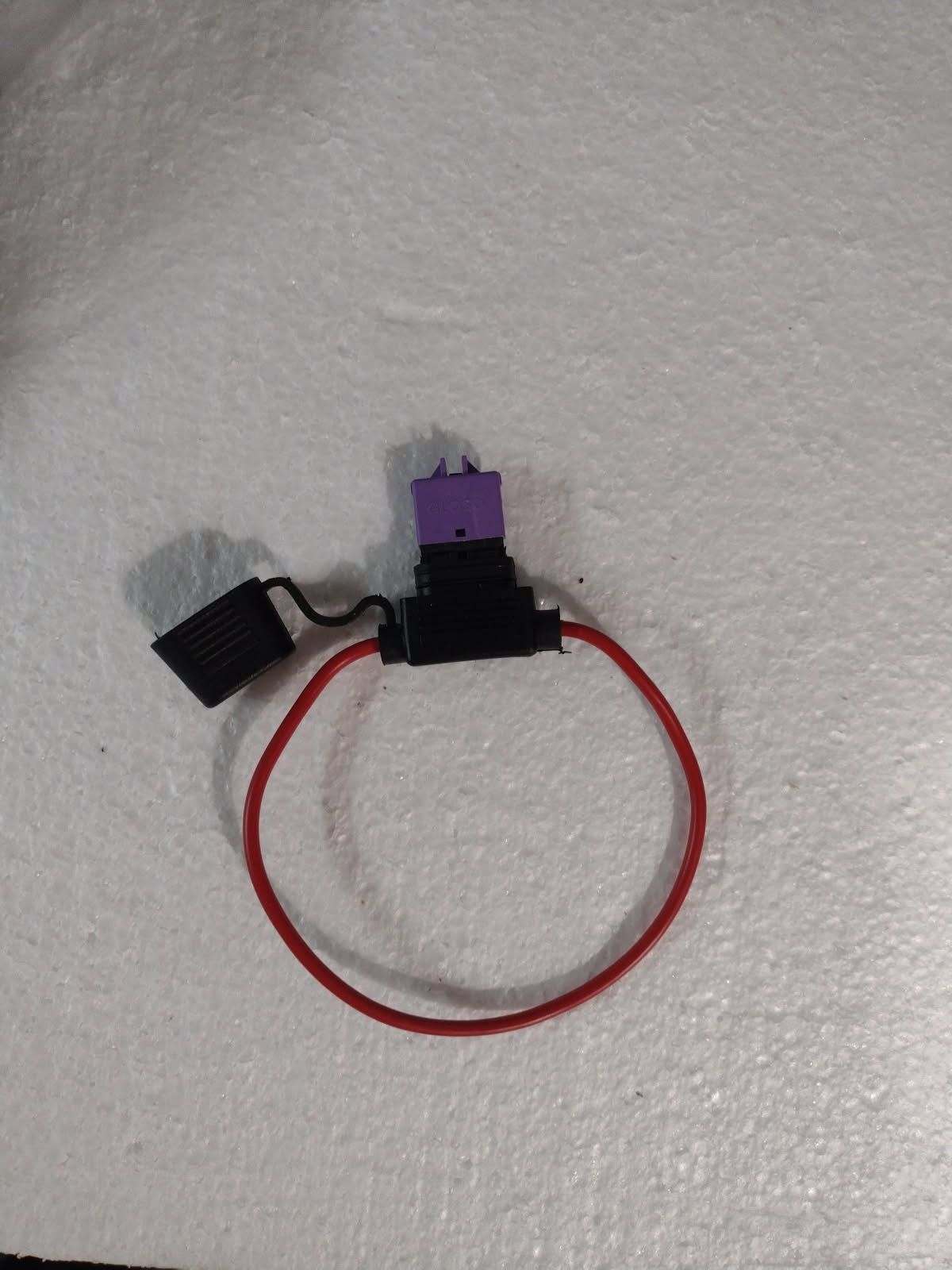

Instead of putting in a new fusible link , put in a resettable fuse/ circut breaker for testing .
Automotive Low Profile ATC ATO Fuse Car Resettable 3A 5A 7.5A 10A 15A 20A 25A 30A Standard Fuses Manual Reset Fuses Blade Circuit Breaker for Boat Truck SUV Motorcycle 32VDC Fuse
The fuse holder comes with 12 or 14 gauge wire sold separately. Makes life easier.
