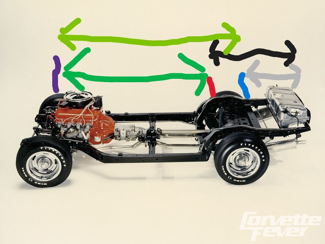

Default pic
i made you a pic showing a spring mounted front or behind . all that metal ,body plus fuel cell being further behind mounting point makes a difference.
With respect,
The red and blue lines have zero impact on weight distribution.
The only thing that determines weight distribution is where that weight contacts the ground: the tires. That's it. Anything in between will not affect weight distribution at all.

I only wish you could see it for yourself. scales don't lie the red line has more behind it and the blue line has less . i guess every dirt late model and every stock car running today is wrong I'll take my chances with facts like scales and personal experience. i wonder why they set the motor back so far . kind of thought it was to add more weight to the middle of the car but i guess if it was over the front springs it would be the same . but I'm sure it added no more weight to the rear tires right? Only because it doesn't matter if its closer top the rear spring mounts so it couldn't possibly have different percentages.
By moving the motor, they moved the CG of the car relative to the tires. By moving the mounting point of a spring, you aren't moving weight anywhere, relative to the tires. Not sure why this is so difficult for you to understand. The only thing that matters is where the weight is relative to the tires.
If you saw a change in the scales, you changed something other than just the location of the spring mounts. You moved weight, you added weight, or you subtracted weight, but SOMETHING else changed other than JUST the spring mounting point relative to the tire when you did it.
