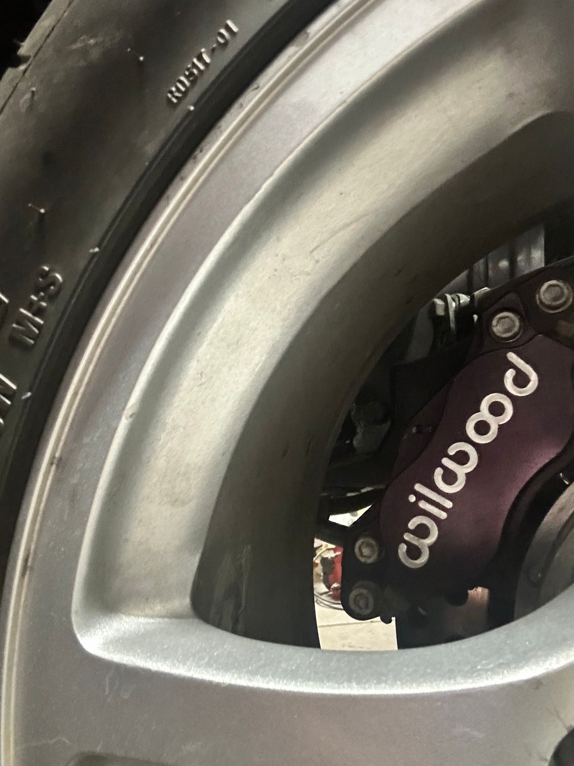

Default What no bear brakes
That’s right wilwood makes a super light caliper with aluminum hat and thin drilled rotor. I’m not stopping a tank just a light car.
I’m even conscious of how much a tire weighs aluminum lug nuts aluminum weight jacks , hubs and spindles.

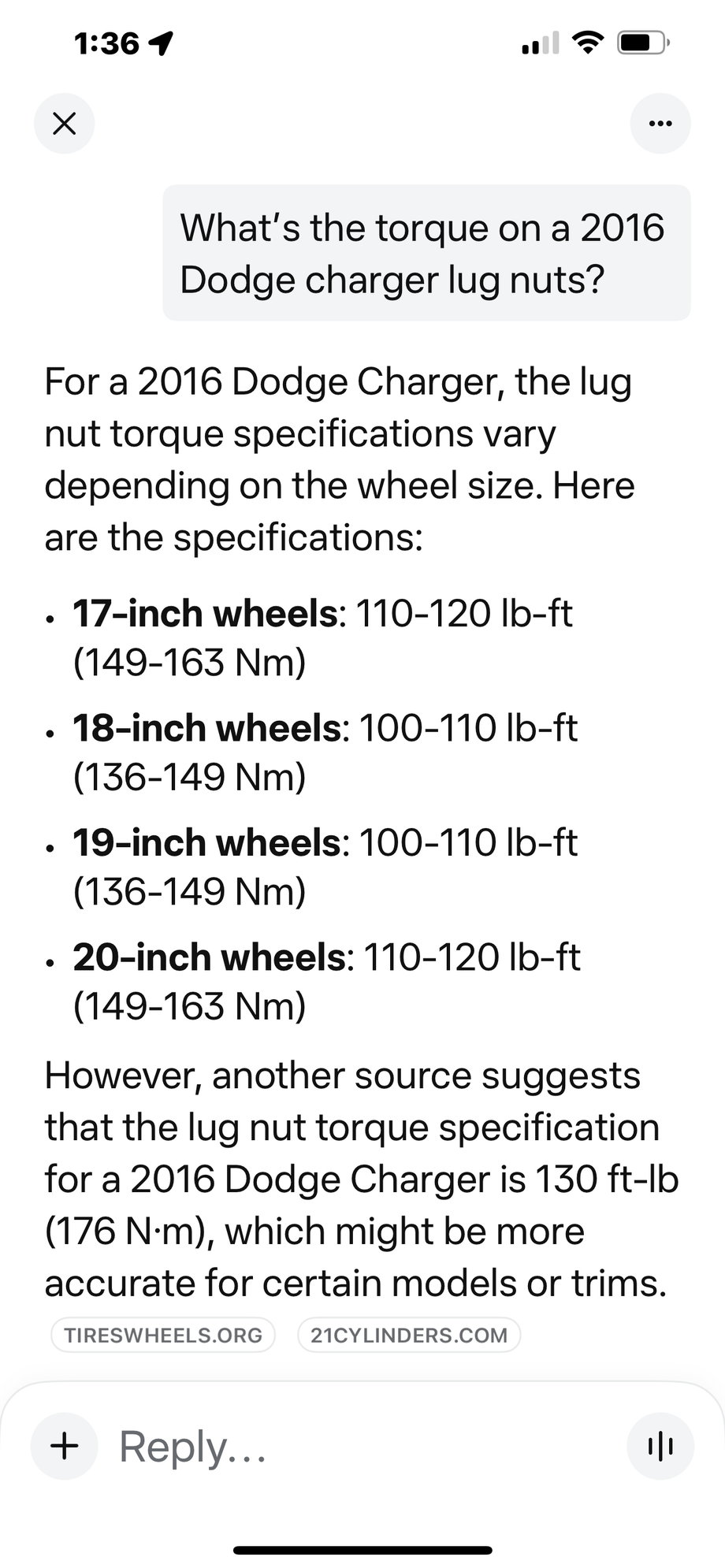

Default AI says
Just so you understand my theory
Old Sep 25, 2025 | 07:02 PM
  #46
CSIROCZ's Avatar
CSIROCZ
Joined: Nov 2019
Posts: 185
Likes: 113

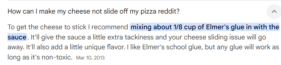

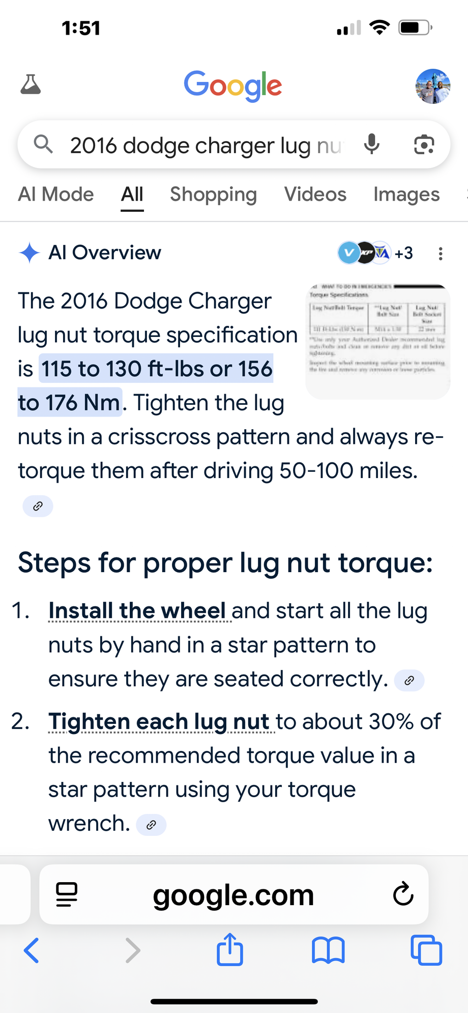

Funny thing about AI: the more one knows about it, the less one trusts it.
But since you trust it, lets see what google has to say:
Which one is right? Those of us who've taken a high school physics class know*.
*And for the record, my education and professional experience go WAY beyond that. But that's all that is necessary to understand this very basic concept.
