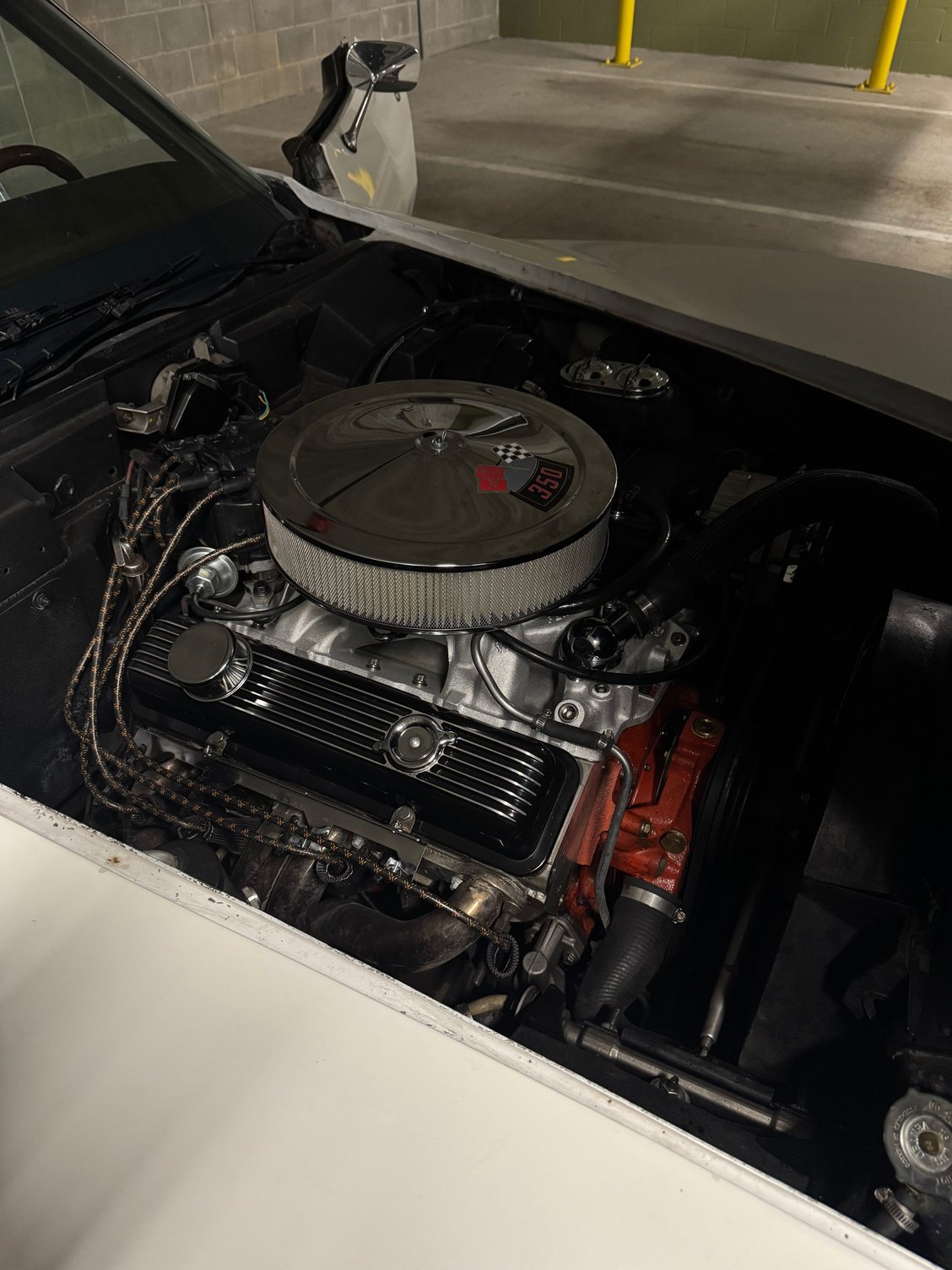

I have a 76 Stingray that I just installed a modified 1986 4 bolt main in. The intake is higher than stock and now I have to use a 2 inch air filter for the hood to close. That just seems a bit too restricting to me. Am I wrong?

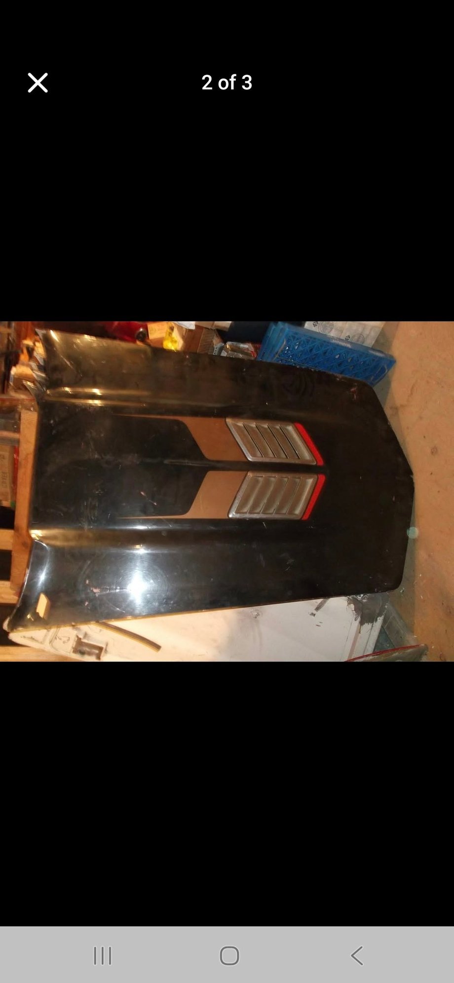

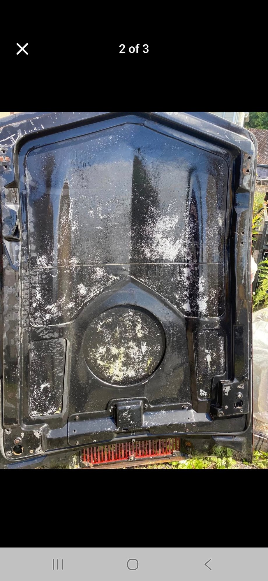

There is a hood from a 1974 454 for sale locally but the seller told me it would not fit on my 76. Is he wrong about that? Pics of the hood below.

This is the hood for sale. Will that 1974 hood fit on my 76, or not? Also included is the street scoop I was looking at. I favor the scoop if it is doable.

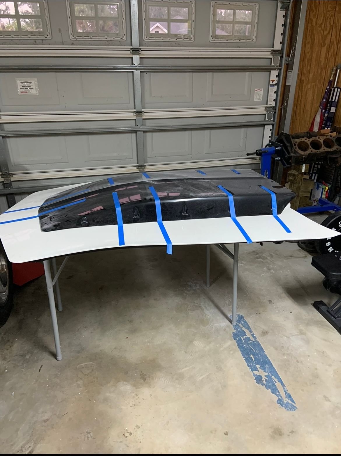

I considered one of those breathers as well. But, as mentioned above, the offset engine position is why I personally opted for a cowl. Got it from Jegs.
If I hadn’t already repainted the car I would have gotten a L88 hood and then gotten it all painted to match. But this was a good compromise for me. 4” clearance, easy install.

Here is the hood clearance resource thread.
The ‘74 hood will bolt on just fine, but provide no extra clearance since they’re nearly the same exact design. I would list your intake part number as well as the air cleaner. A picture would be helpful.
I run an Edelbrock 2601 air gap manifold and a 3” air filter. With a proper drop base and dome on the top I have enough clearance above the carb to not affect performance while still fitting under a stock ‘76 hood.

Is it fiberglass or plastic? Is it just bolted on? I assume you just cut a round hole for the breather?

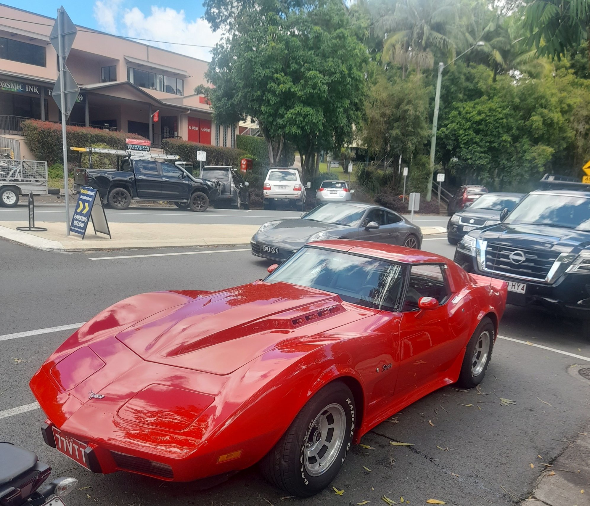

On another note, anyone know what this hood is from? Year? I find the 76 hood to be a bit "blah" to begin with. I will be painting the car once I am done under the hood, but I want to do something with the hood as well. I like the lookes of this hood. I can get it for $150. Probably 100 because it has been for sale for a while.
Old Sep 10, 2025 | 10:58 PM
leigh1322's Avatar
leigh1322
Old Pro Solo Guy
Posts: 8,082
Likes: 4,431
From: Marlton NJ
An LT-1 height intake manifold should fit a stock 73-79 hood.
If you use a GM AC 2.0" drop open element air cleaner.
Almost all other aftermarket air cleaners bases sit higher.
The 73-75 hoods have a working cold air package built into the hood.
That stopped in ~76 IIRC.
Taller intakes than the 4.57" LT-1 do not fit well, without compromised flow air cleaners.
C3 Corvettes and 70+ Camaros have the two lowest hoods around, in the musclecar years.

fiberglass bolt on, and there’s a decent size rectangle cut out underneath. Plenty room for a taller intake, NOS plates or a supercharger snout.
That's kind of a neat hood.
A cowl induction style similar to the chevelle or camaros.
And I like the vents.
The L88 hoods have a 2" rise at the back.
IIRC a 76 has about1"
The 2" rise fits a decent hi rise manifold even on a BB, and 1" more room than that on a small block.
So an inch above the LT-1 SBC intake.
