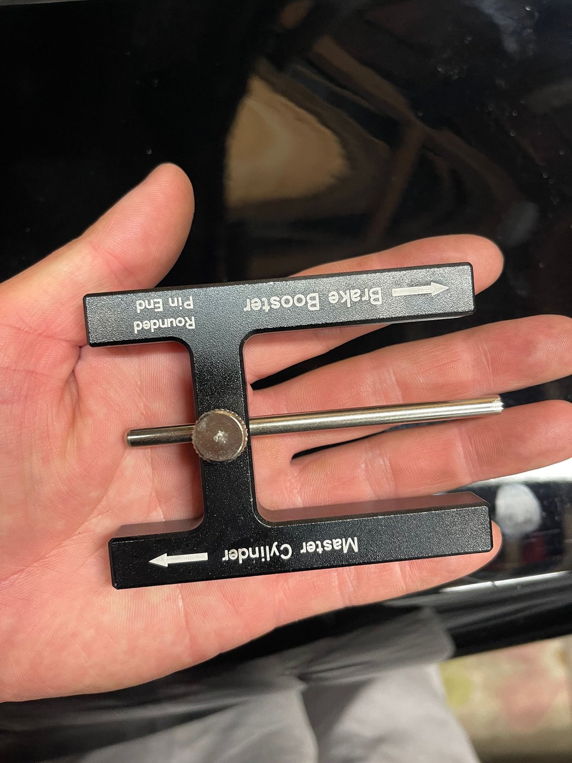

You need this tool. Either the gap is wrong, the check valve is bad or the booster is bad.

Amazon also sells that gap tool, which may be a quicker and less expensive route to Japan.

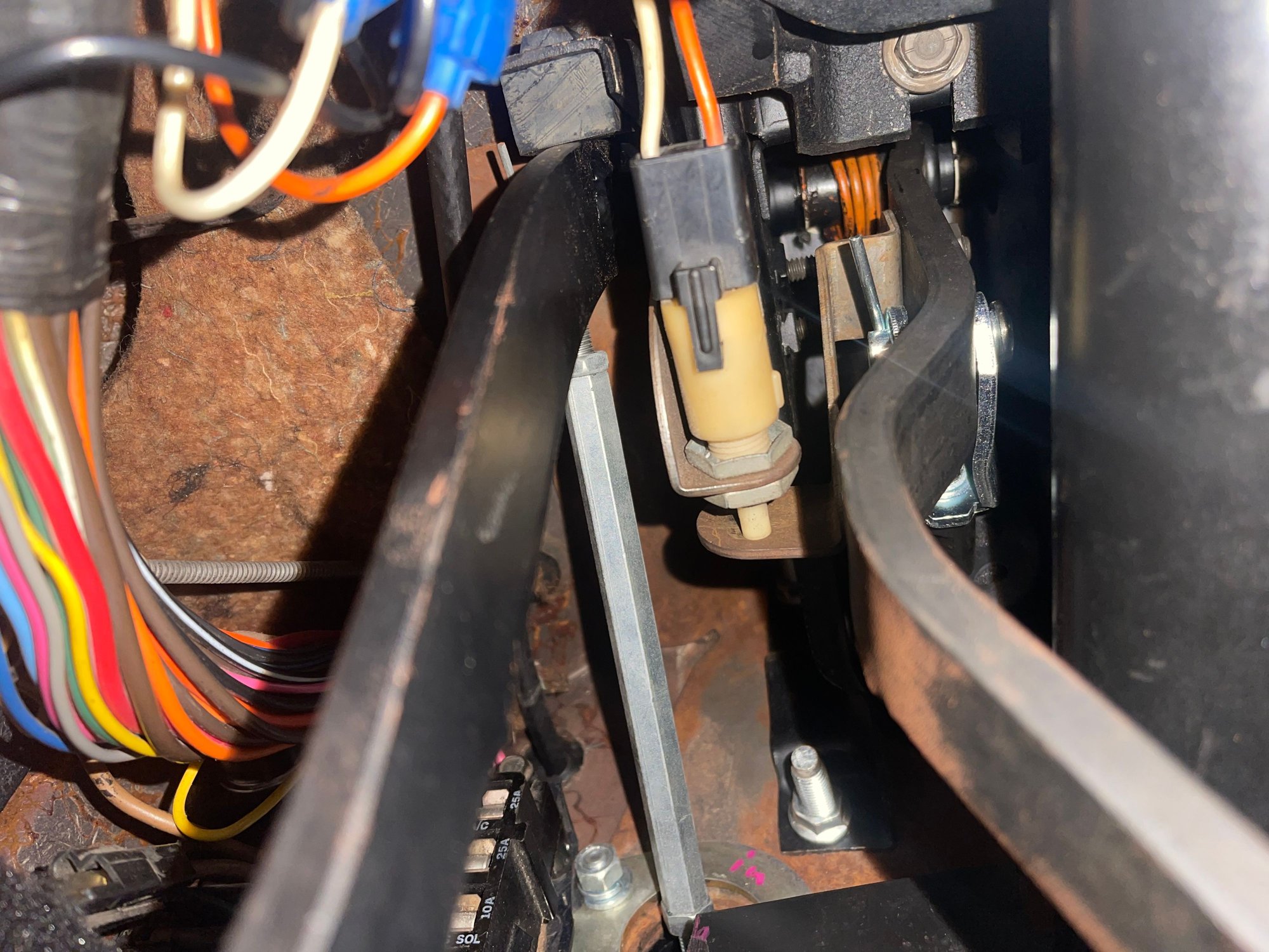

] There are two holes for the booster rod on the pedal. It's hard to see, but I took a photo. The booster rod is attached to the lower hole.
Old Sep 21, 2025 | 10:03 AM
HeadsU.P.'s Avatar
HeadsU.P.
Joined: Aug 2017
Posts: 8,336
Likes: 2,810
From: Cool Northern Michigan
Yuichi,
Ok. Good job on the photo.
You have two options for brake pedal / booster rod travel distance.
I do not know which hole is needed for your 1971.
One hole may be for std manual brakes.
The other hole for P.B.
Maybe somebody else will chime in to help.
But regardless, you are not using original equipment. That may or may not be a factor.
Another thing, is the Tuff Stuff booster rod adjustable? You can not see if the rod has threads on it unless you remove the master cyl.
Does the instruction book mention adjustable booster rod?

There are two master cylinder bore sizes
1.0" for manual brakes and 1.25" for power brakes.
There are two height mounting options for the booster rod on the brake pedal under the dash.
The high position is for manual brakes, it gives you more leverage, but also more pedal travel.
The lower position is for the power brakes, it is very stiff unless the booster works.
Your too firm comment sounds to me like no booster function.

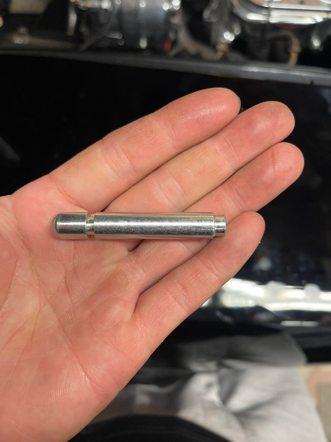

I removed the master cylinder and measured it. The rod is not adjustable, can I adjust it on the pedal side?

That's true, there are a lot of problems. The booster rod is only a little long, but is it okay to cut or grind it down to adjust it? Sorry for asking so many questions.
Yes, shorten it.

I bought the tool and measured it and it's 5mm long so I'll try shaving it down.
