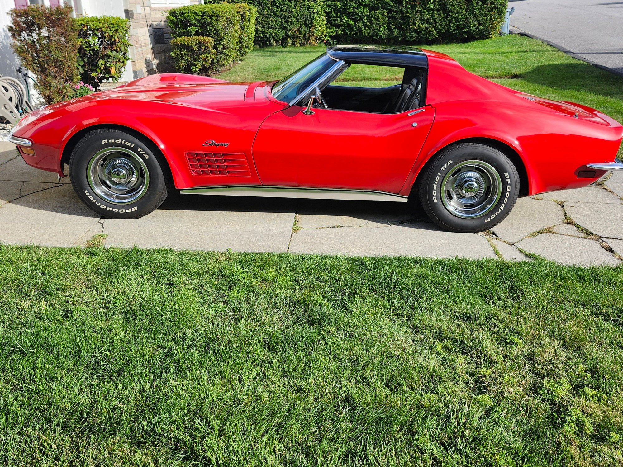

There is only one show left at Patriot Place this year, but if you ever get adventurous and venture out of Newport county stop by and introduce yourself. Thanks for your comments. My car is shown below.
