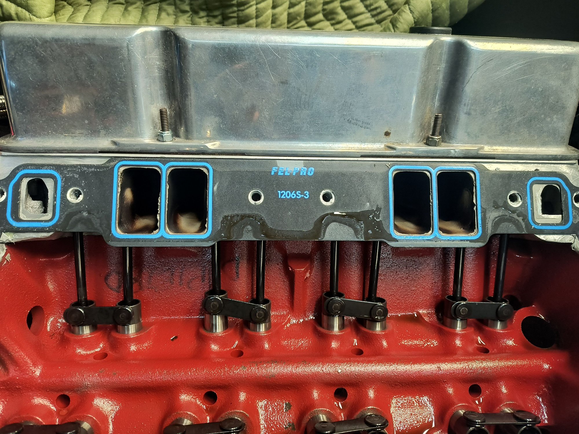

I am looking at the gaskets, I never noticed oil seaping up near the intake ports, I had the engine builder put my manifold on, looks like they dropped my head as it had a small dent in the corner, not visible in pic. But I also don't ever recall seeing this much oil on the gaskets before, wondering if any is sealing into those cylinders .

Has your block ever been decked ? Have the block surfaces where heads rest upon (decks) ever been milled aka shortened ? If so how much was removed ? Do you KNOW your current "deck height" ?
I ask only because it's commonplace that decking a block often requires concordant milling of intake manifold ( to help it realign with heads' intake faces ).
A slight angle-mismatch there can cause persistent leaks between intake & head.
I'm NOT saying yours is leaking, but it seems you're investigating any/all possibilities.
Yes, if a head were dropped on a corner, that could raise its intake gasket surface enough to prevent intake from laying flat against head; suggest check it with straightedge.

Back in 2005 the block was decked to zero.. I have many times over the years pulled the intake, cam swaps and never seen that.. that was the first thing I noticed when I removed the intake to pull of my proflow, today I pulled the roller lifters out there were a few with no oil in them, I try to depress the lifters with the pushrod some were extremely hard to depress slightly.. I adjusted my valves, started the car and it was clanking, it sounded like it was just a few, but the car was running horribly.. I am thinking the lifters are bad, this is the second time adjusting them, each time several were extremely easy to go 1 full turn after preload... I also for the heck of it put some intake sealer on those ports, normally I don't ever use it on the intake side, but I had to see if that could be a problem. It wasn't..so I can I be sure that my lifters are bad before replacing them????
