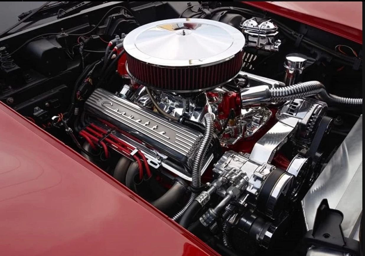

I did exactly the same thing in my 80 L48. The trick, though, in addition to the loams, is that (like in the image) I have headers. It's easy to drop the (cut to length) plug wires between the pipes, and protect them with fabric sleeves (like in the image)
I'm not sure if you can do that with rams horn manifolds, unless the loams stick out a bit.
You don't need to use the RFI shielding, and you don't have to pass wires through the engine mounts, though.

I want to thank you all for your comments. Last week was brutal at work, I end up working over 70 hours and did not had time to read your post until just now. That is definitely a sweet wire routing job in the photo. Piersonpie I assume by looms you are referring to what appears to be fabric or the plastic tubing I see as the wire turns 90 degrees down towards the sparkplugs? Bikespace, you have a point. I don't have headers on mine, and I will have to investigate if I can do something similar with the OEM manifolds. Do you have a picture of your setup? This is probably going to end up like Ziogeo stated, "taking the original OEM route", I hope not. I would love to have something similar as in the photo. Rebelyell, I know you are correct saying that heat rises and that is a concern I have. Do you think that routing next to the valve covers will eventually damage the wires, or even worst yet, cause misfiring issues?
Again, thanks everyone!
Keep them roaring,
CAT59
By looms, I mean the aluminum guides that mount next to the valve covers. Here's an example loom at Amazon (very much NOT an endorsement). The ones on my car are nicer, but I can't find a link for them. I'll try to get a photo tomorrow. Perhaps you can find a solution that lets you run over the manifold plug wires, but probably not. Your best bet is to install headers. They turn a spark plug change from an hours-long ordeal into a 15 minute exercise.
The fabric is typically called "titanium spark plug boots", or something similar. Here's an example boot set from Amazon, similar to what I have on my car. I've had no issues related to cooked spark plug wires from my setup, but I'm not road racing the car, either.

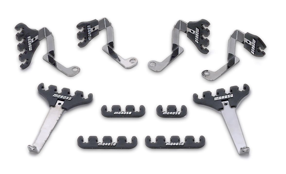

Ahrmike I have read about other guys in the Forum having a lot of issues with standard wires, so If I take the OEM route I will definitely get the self crimping wires. Not looking forward to this, everyone says is real PITA. Bikespace thanks for the photos and the info. I will eventually go headers but, for now the wife thinks the Vette is to loud as it is, if I go headers it will become louder. I am going to have to sweet talk my wife into this one 🤣. I was looking around the engine block and the space is very limited to installed the looms. As you stated I was looking at the possibility of installing the wires higher than the valve covers using something similar to this:
Maybe if I do some engineering thinking and do some bending and so on, I may be able to get something going, what do you think? I have looked for photos of wire routing without headers installed but, I have not been able to find one. If you find a photo like that, please send it my way.

I was hoping there would be an easy over-the-rams-horns solution. Installing headers might take less time, though.
Since you'll likely need to work from under the car to get a few of the spark plugs anyway, you might want to follow the 82 routing from the thread @Ahrmike posted for now, but still use the looms you found (not zip ties), if the stock guides are missing or damaged.
