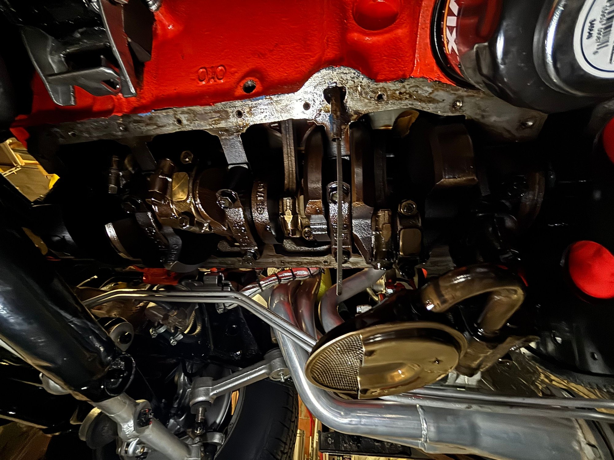

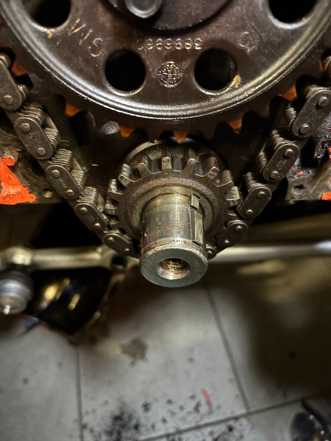

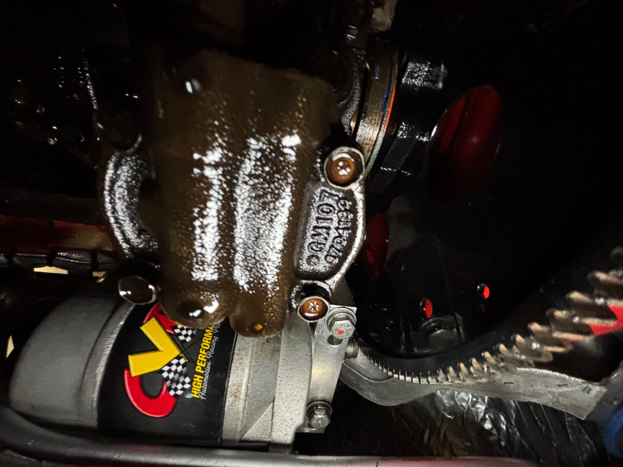

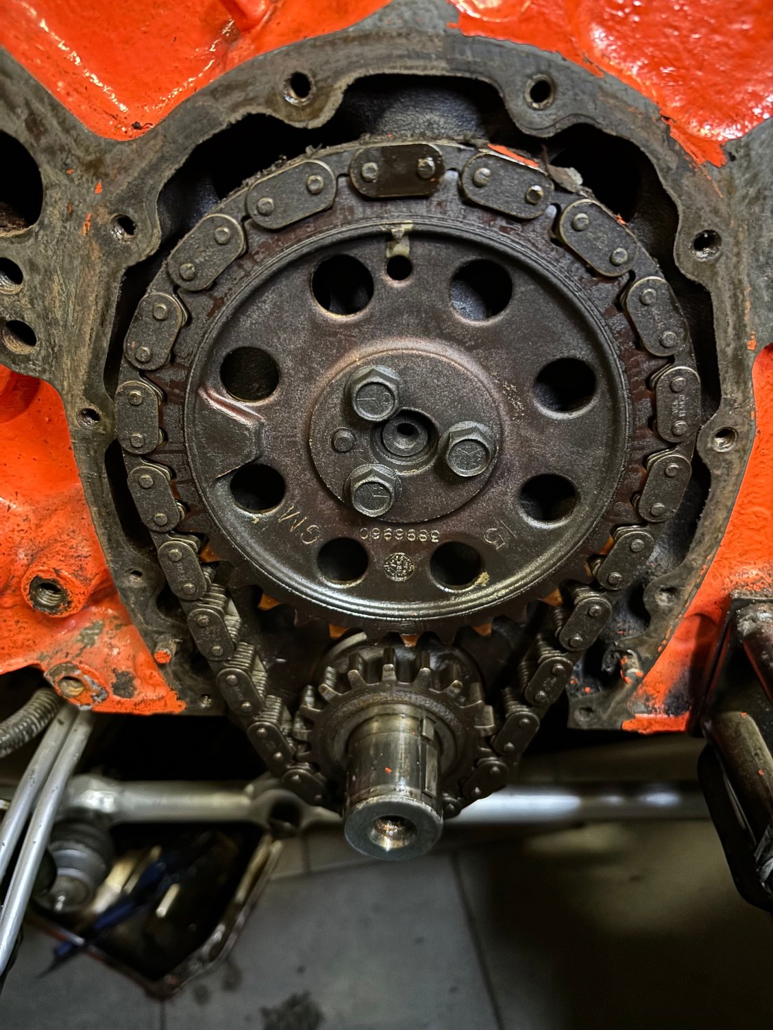

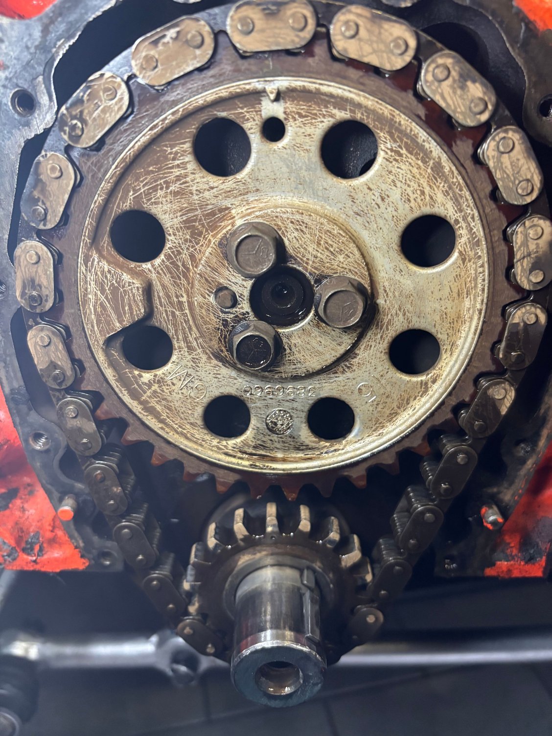

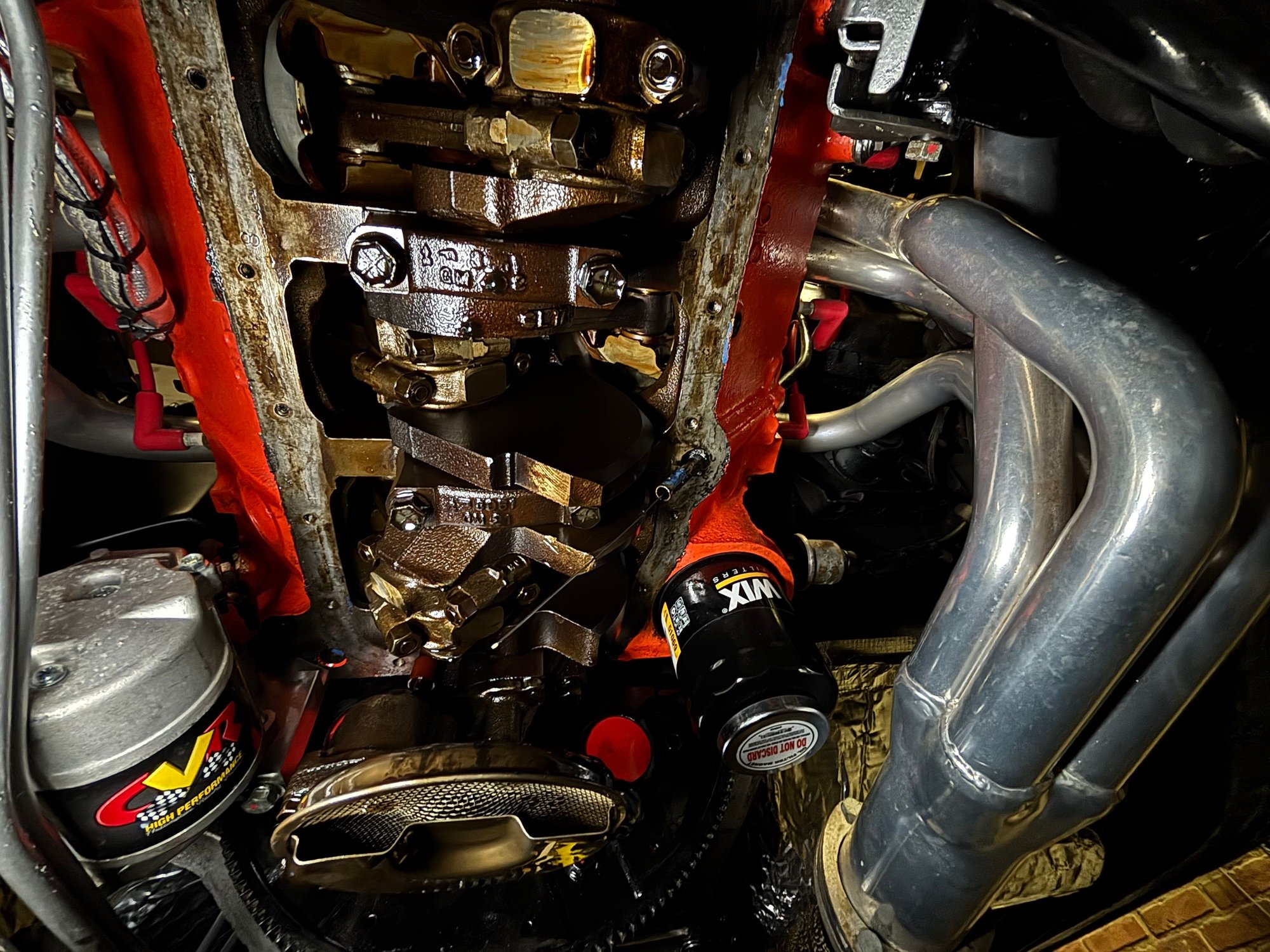

I removed the oil pan and timing cover and did some cleaning and scraping.
Here are some pictures.
(Everything seems original.)

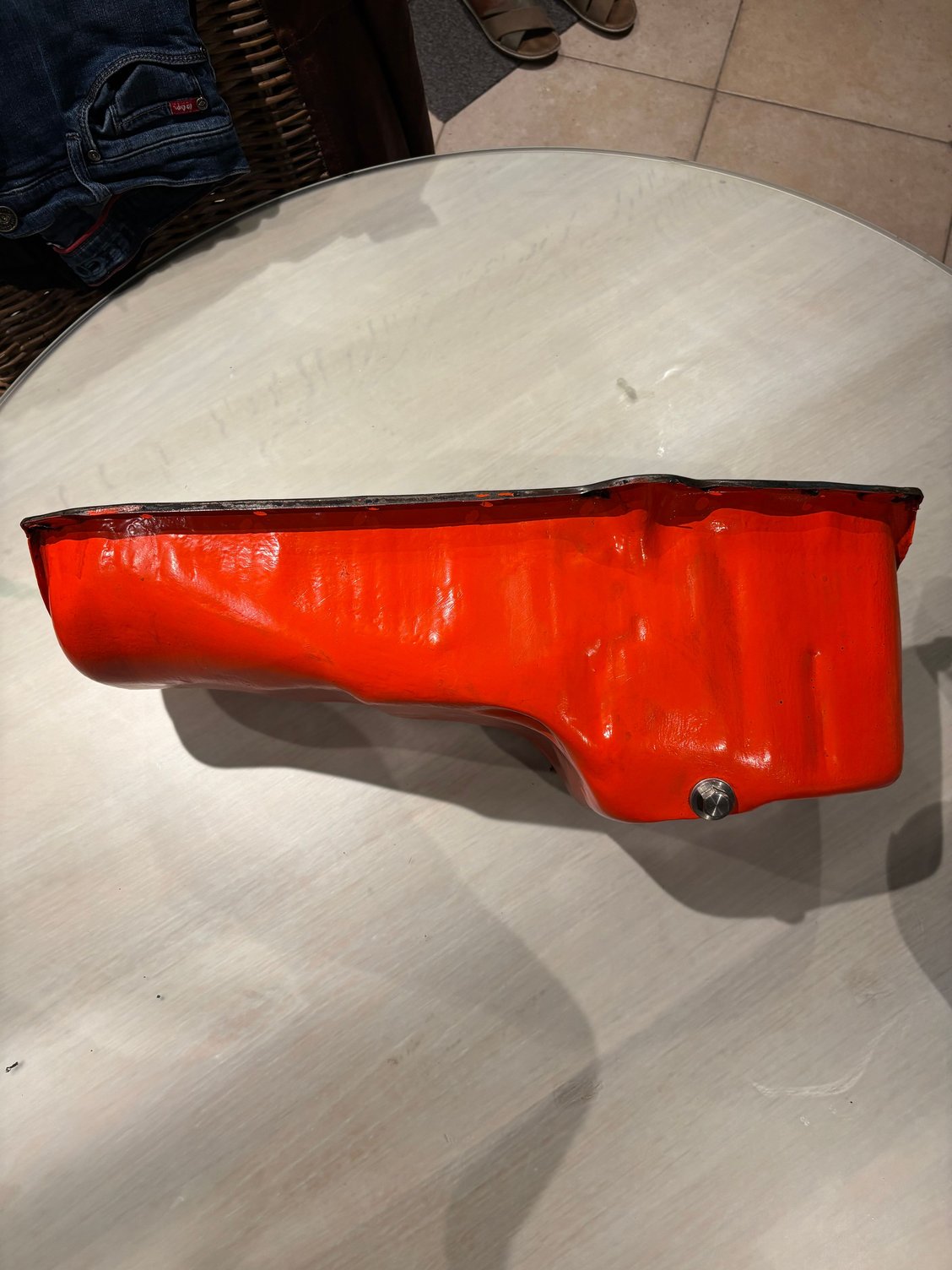

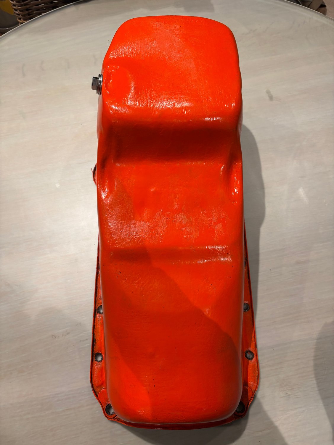

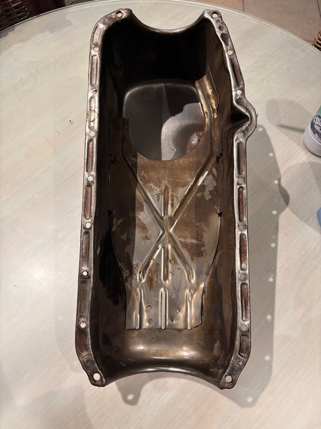

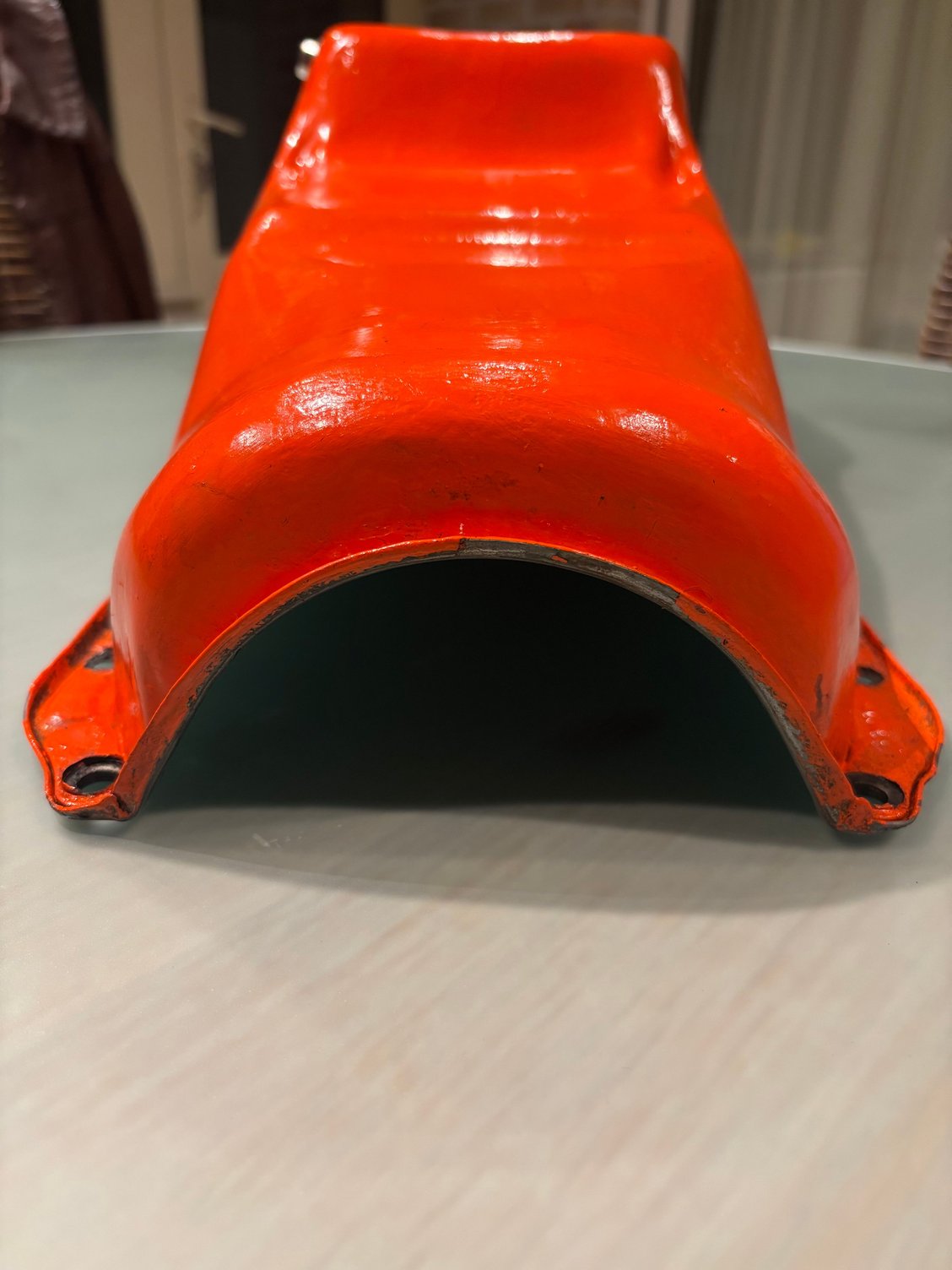

1. How do I know if my oil pickup needs to be replaced?
2. I placed my oil pan on a glass table. It seems not perfectly straight because it wobbles a little bit. Can I fix this with a hammer or some tool or isn’t that a big deal and will the blue 1-piece Felpro gasket fix it?
3. Can I just remove the chain and sprocket by loosening the 3 bolts or do I have to do/check something else before removing it?

It all looks really good!
If the pan doesn’t sit perfectly flat on a glass sheet, it’s probably best to leave it alone rather than trying to make it perfect.
If it’s off just a little, it will pull down flat when you torque the bolts using the proper sequence.
Its more important to make sure all the material around the bolt holes isn’t deformed because the bolts were over torqued.
When you put it all back together, don’t forget to check the bore on the new harmonic balancer and check the snout of the crankshaft.
You might need to slightly bore the balancer to properly slip onto the crank.
Some people don’t and it can make installing the balancer a nightmare.
Remember to use the proper installation tool and not a big hammer.

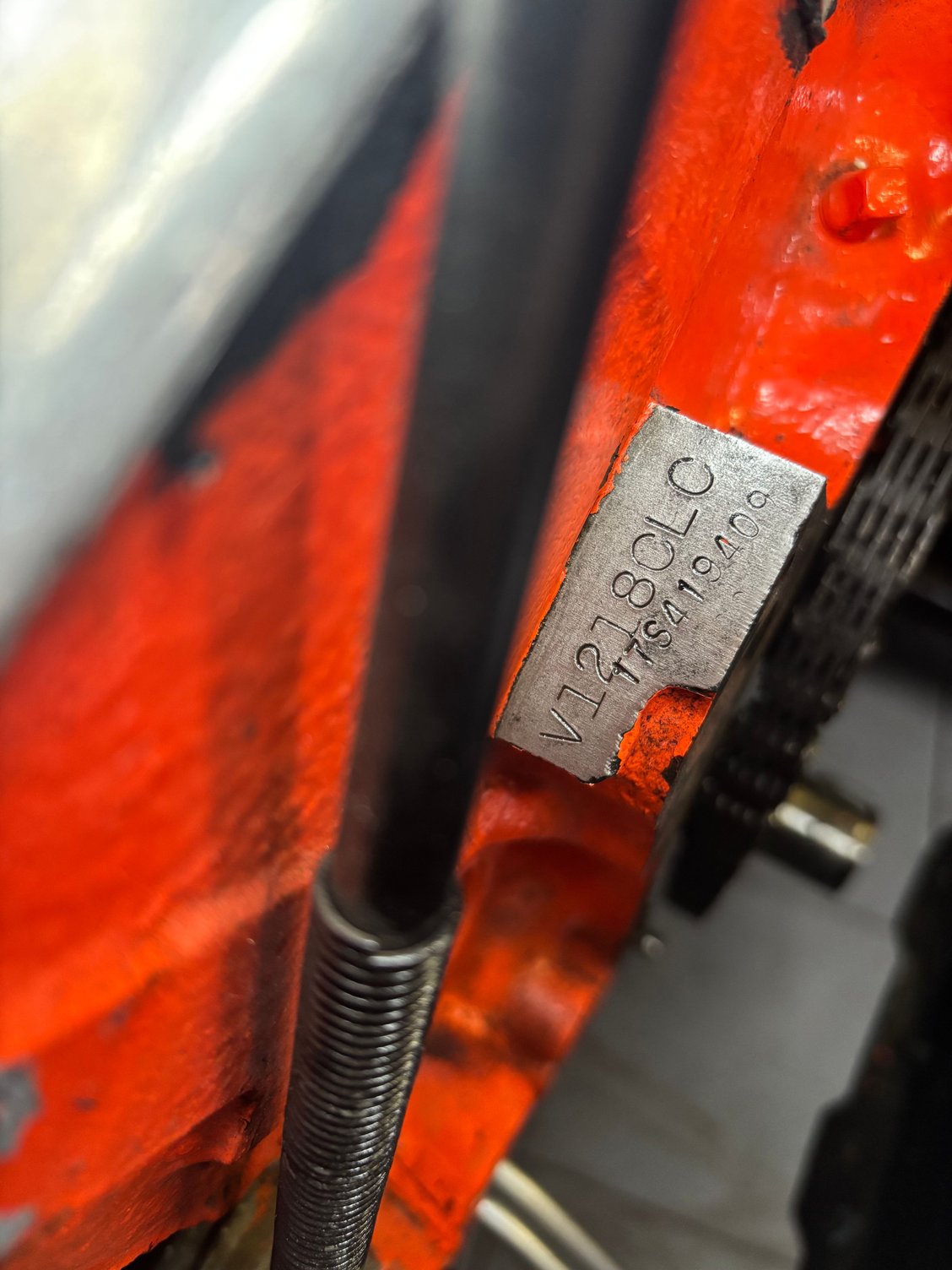

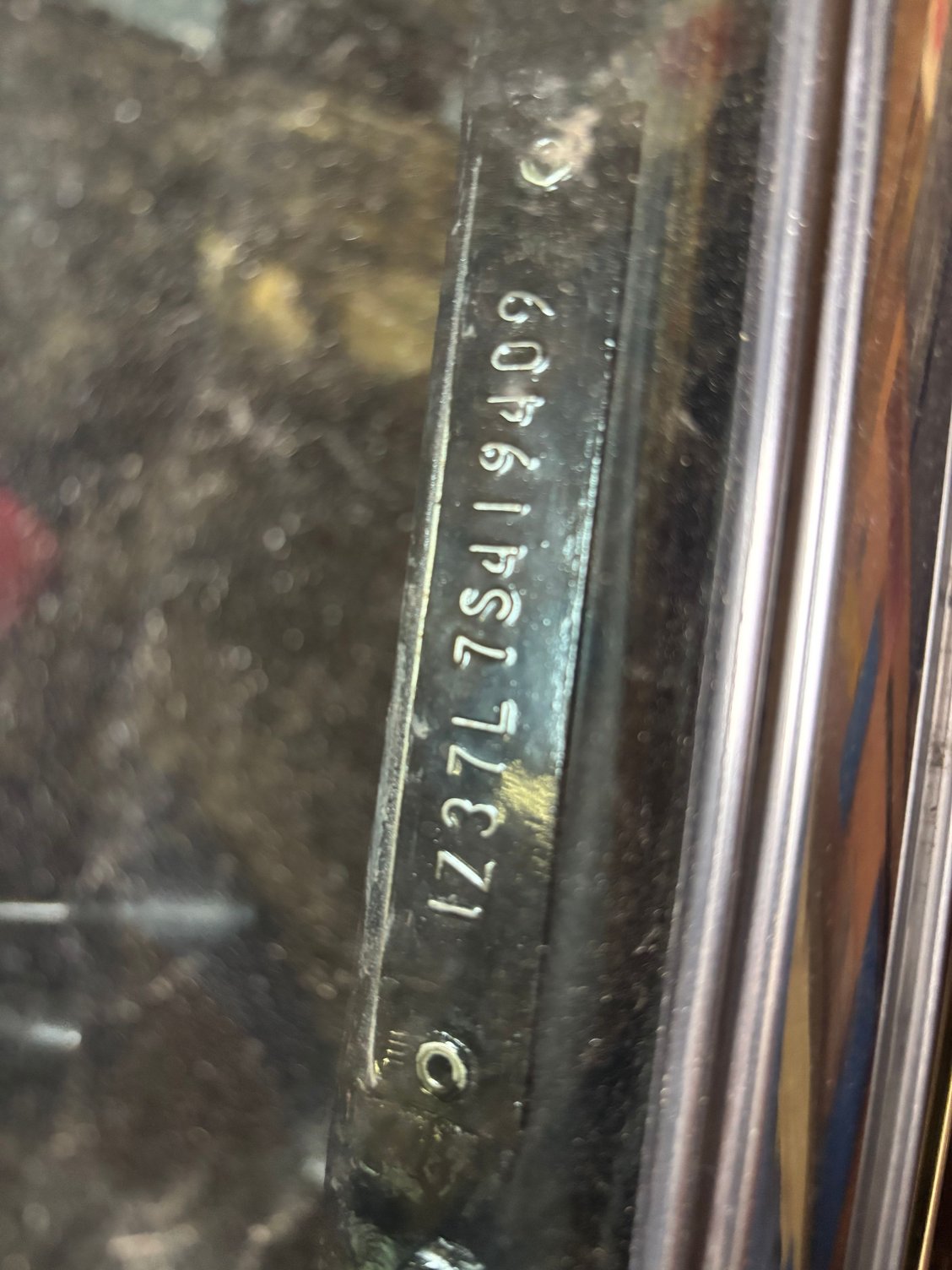

Are you Certain that motor is original to this corvette. ?
Can we see a clear, hi-resolution pic of stamp pad, just forward of passenger head ?
I do believe that pan is Not a corvette pan.
Have you found any Plastic chunks/debris in pan or in pickup ?
I cannot be certain, but I do believe that Cam sprocket has the Nylon cladding. It's so dirty I cannot tell if that plastic cladding is broken.
First, Set the motor on TDC #1, Then Remove sprocket's 3 bolts. Then sprocket & chain can be wiggled free.

I'm GUESSING that pan is from a light truck or sedan or crate motor etc. ALWAYS choose pickup to match BOTH pump And pan.
And, it's quite difficult to remove ALL varnish from screen.
You CAN phone email with Melling Tech; they will help you choose correct pickup. Sadly, George Richmond may no longer be available at Melling.

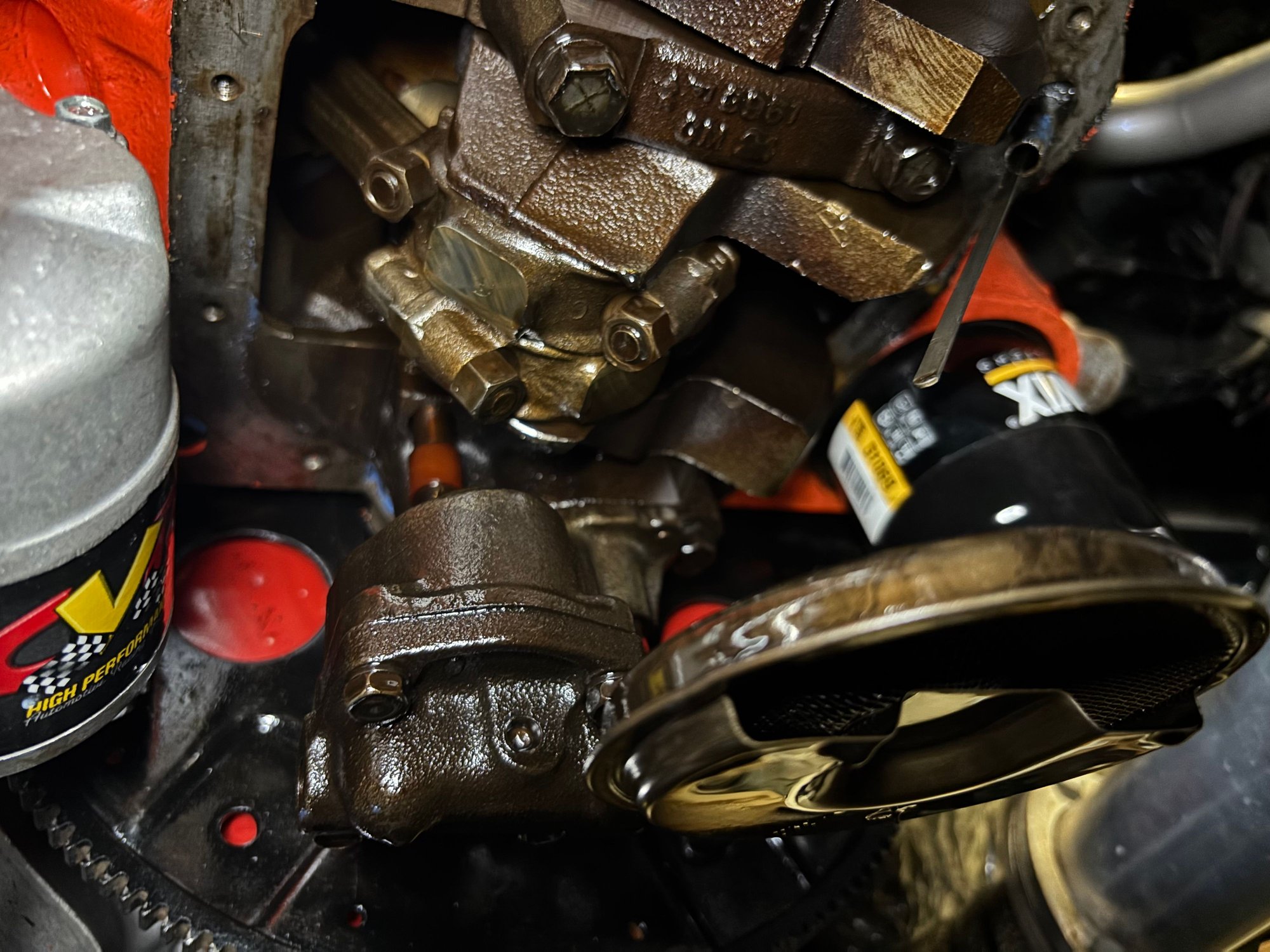

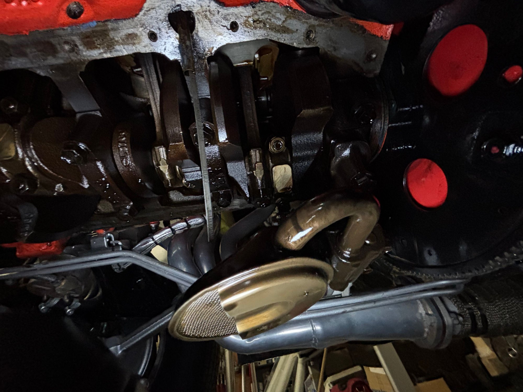

Based on above pics alone, (resolution/focus & lighting not ideal), I'm seeing a few discrepancies-conflicts.
Inside motor is mostly dirty w/ long-term, cooked sludge coating. BUT, screen is remarkably clean !
Plastic Nylon Oil Pump Shaft GUIDE aka RETAINER appears in place, But perhaps not cracked.
Is this motor Not OE to car ?
OR
Was OE vette pan damaged /leaking and then replaced with Current pan? Thereby, the Current pan could not fit with Vette screen-pickup, So, the pickup was recently replaced with a Non-vette part (which might help explain why screen seems remarkably clean when compared to remainder of motor's insides).
*Not conflict: but note this motor has a cast crank and 2-bolt main caps. Well lit pics from underneath pistons, focused on underhead, may disclose cast or forged.

Here are the numbers:

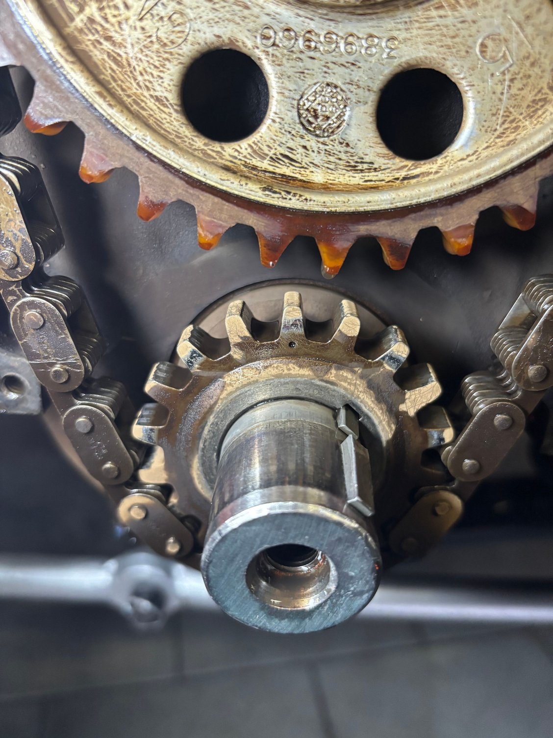

Some more pictures:

Oh, that Cam Sprocket is certainly an OE-type Nylon-Clad, aluminum die-casting. And, unless you're selling car in near future, suggest replace timing set.
On the surface, it seems this motor is OE to the car.
Casting dates & numbers of block and heads may help complete a profile.
? Has this motor spent much of its service life on a lube diet of Low-Detergent OR No-Detergent motor oils (OR suffered Very Long oil change intervals) ?
* while pan is off, suggest R&R that Nylon oil pump shaft guide with a steel one.

I just degreased the sprocket some to see the material and casting numbers on the sparts. It was oily before the cleaning. I think it had good oil changes, but I’m not certain. I did one myself a couple of years ago.
