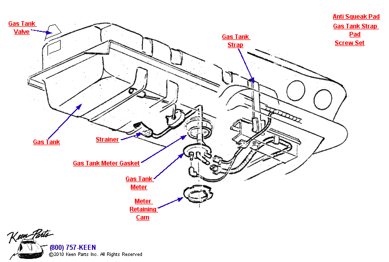

If all accessible hoses have been replaced it could be your rollover vent valve at the tank is cracked or the short rubber hose are shot. It is a bear to get to though. On my 1971 is on the front top of the tank on the drivers side.

I see what you mean.....thank you very much for sharing this diagram, appreciate it man....

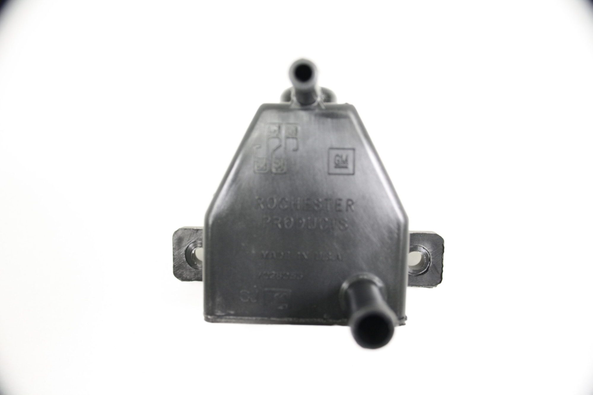

FYI,
The fuel separator valves (pictured above)were no longer used in 1978. 1974 was the last year this valve was used on a Corvette.
To ECS cannister
