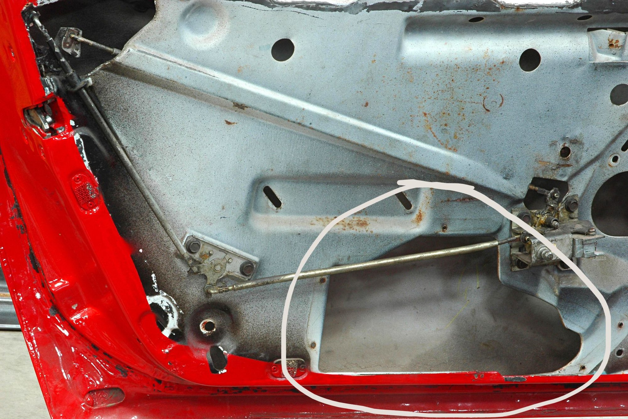

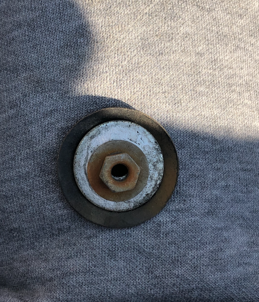

How to fix: I took the door panel off. With the door panel off I looked down inside the door to see what the problem could be. Identified it. Unscrewed what seemed to be an access service slot. Saw washers and bolt laying on the bottom of the door (in the pic). Put my hand up and screwed it back on. Window operates just as before.
the washers and nut
the washers and nut

here is where the little access service panel is. removing this gives access to reach inside to put back the nut
