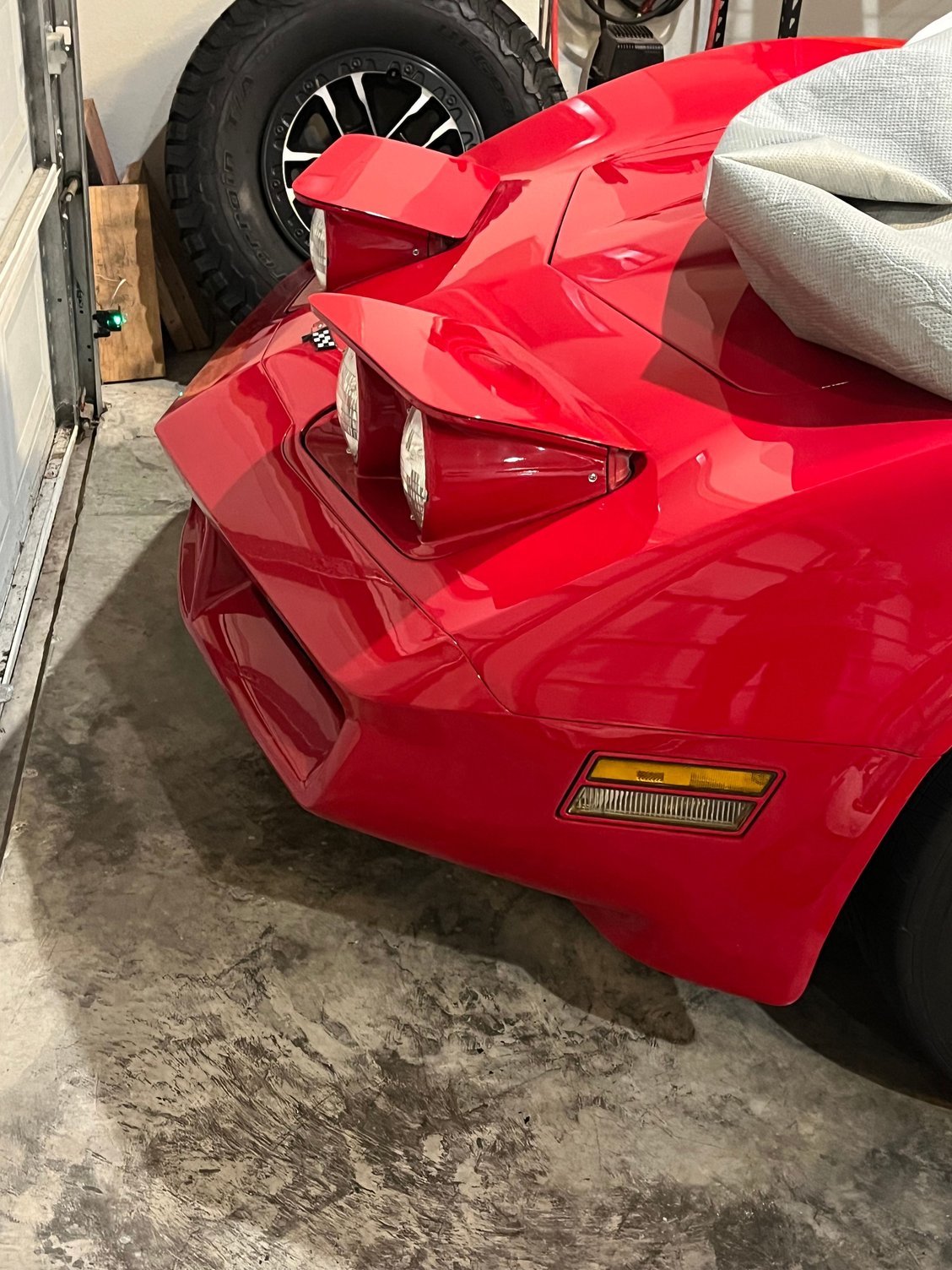

My 80 has ACI front and rear bumpers. Both required a lot of work for proper fitment. The front was way off in many areas. I put a J&D Corvette rear bumper on a friend’s 81 and fitment much better than the ACI. Maybe just differences in the car itself, not sure. Lastly, I have a new old stock Ecklers front that I’ll put on my 82 at some point. It appears to have a lot less molding marks compared to the ACI front. Not sure if Ecklers made their own bumpers, or if they are still available.

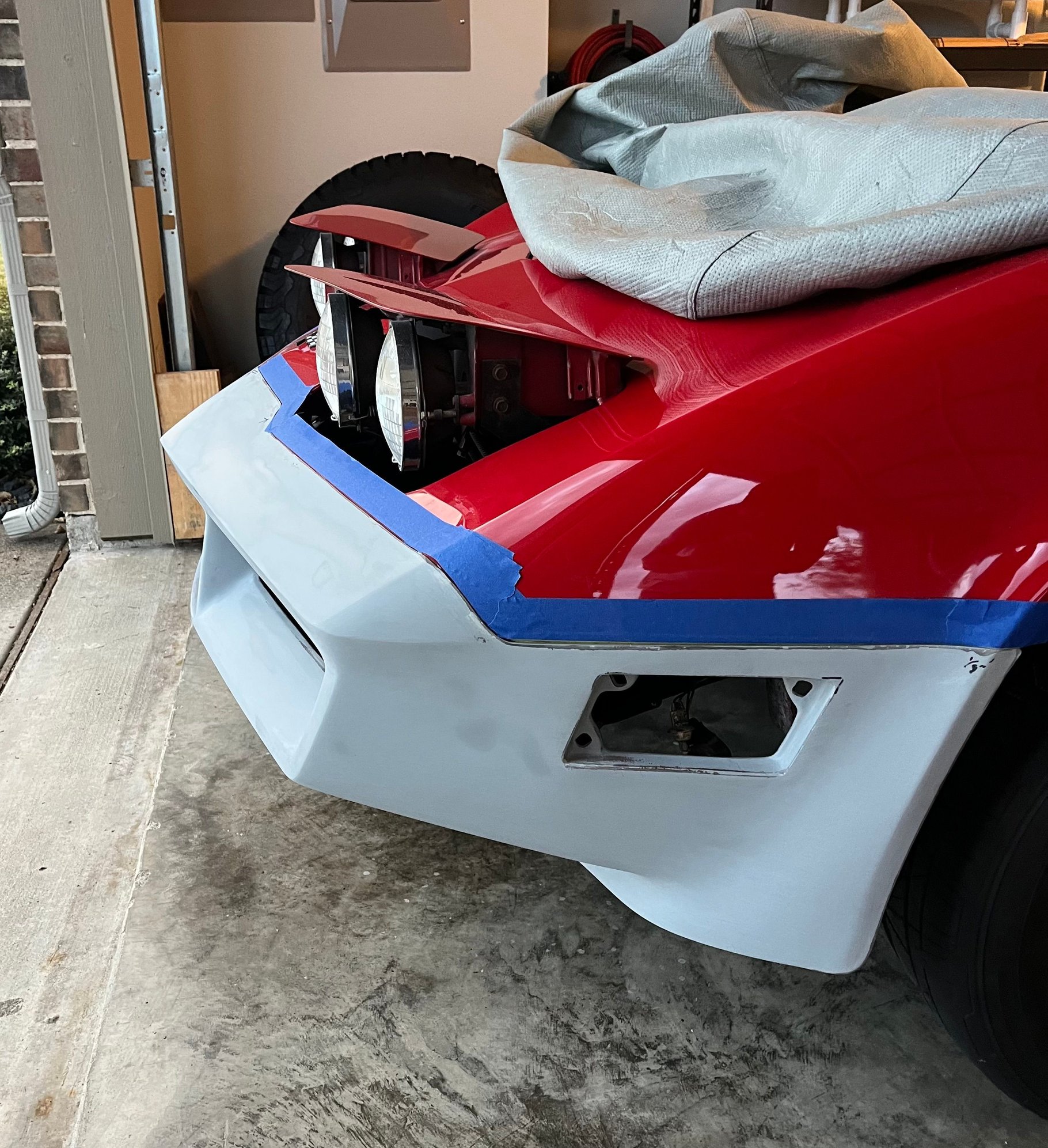

Circling back now I have my new old stock Ecklers fiberglass bumper installed. I have about 25 hours of body work to get the fit and lines right. Both ACI and Ecklers front bumpers need the most attention on the top and side corners. I also took some extra time to tighten the gaps along the edge above the turn signals.
