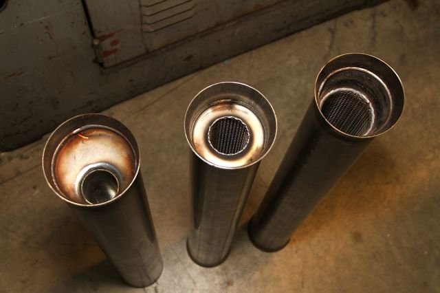

Originally Posted by Piersonpie
That seems incredibly restrictive. I have Doug’s, which are probably slightly different, but even the quietest inserts have an inlet much larger than that.
I have had all three inserts in the picture.
The quiet inserts far left, were way too restrictive. They chocked the engine and made it much slower. How restrictive? I jumped on the gas and the back pressure caused the header and side pipe to separate.
The “glass pak” in the middle, were louder, but not what I was looking for.
The Max-Flo far right, allowed the car to breath best and gave the best performance. But I had to lean over and shout at the passenger for them to hear me. They are loud!
