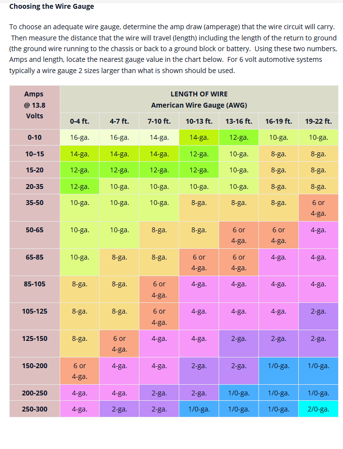

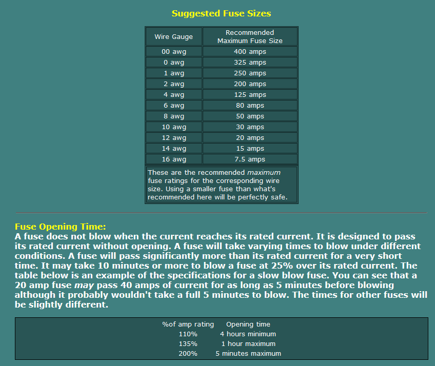

Here's a wire and fuse chart-
Depends not only on the amount of current but also the length.
Another variable is heat- under the hood- the general rule of thumb is to move up tho the next size as the heat adds resistance.
chart-
