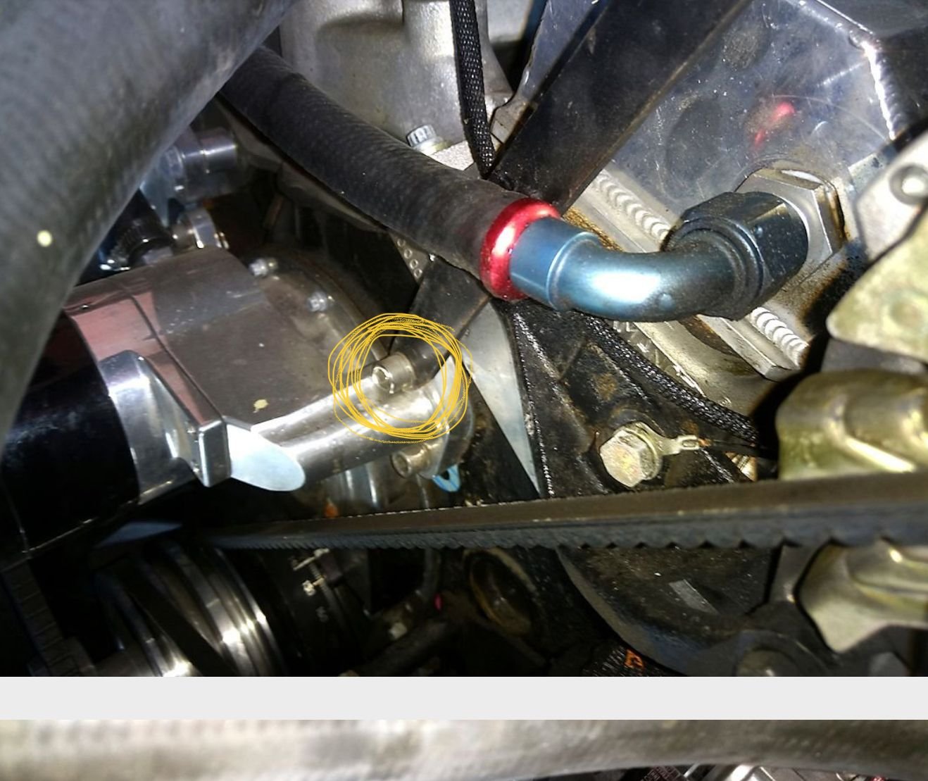

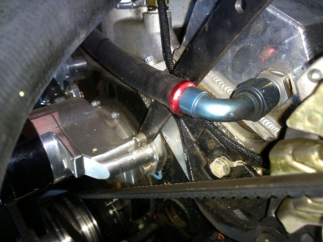

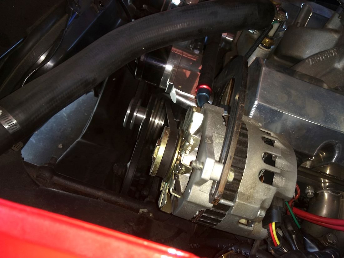

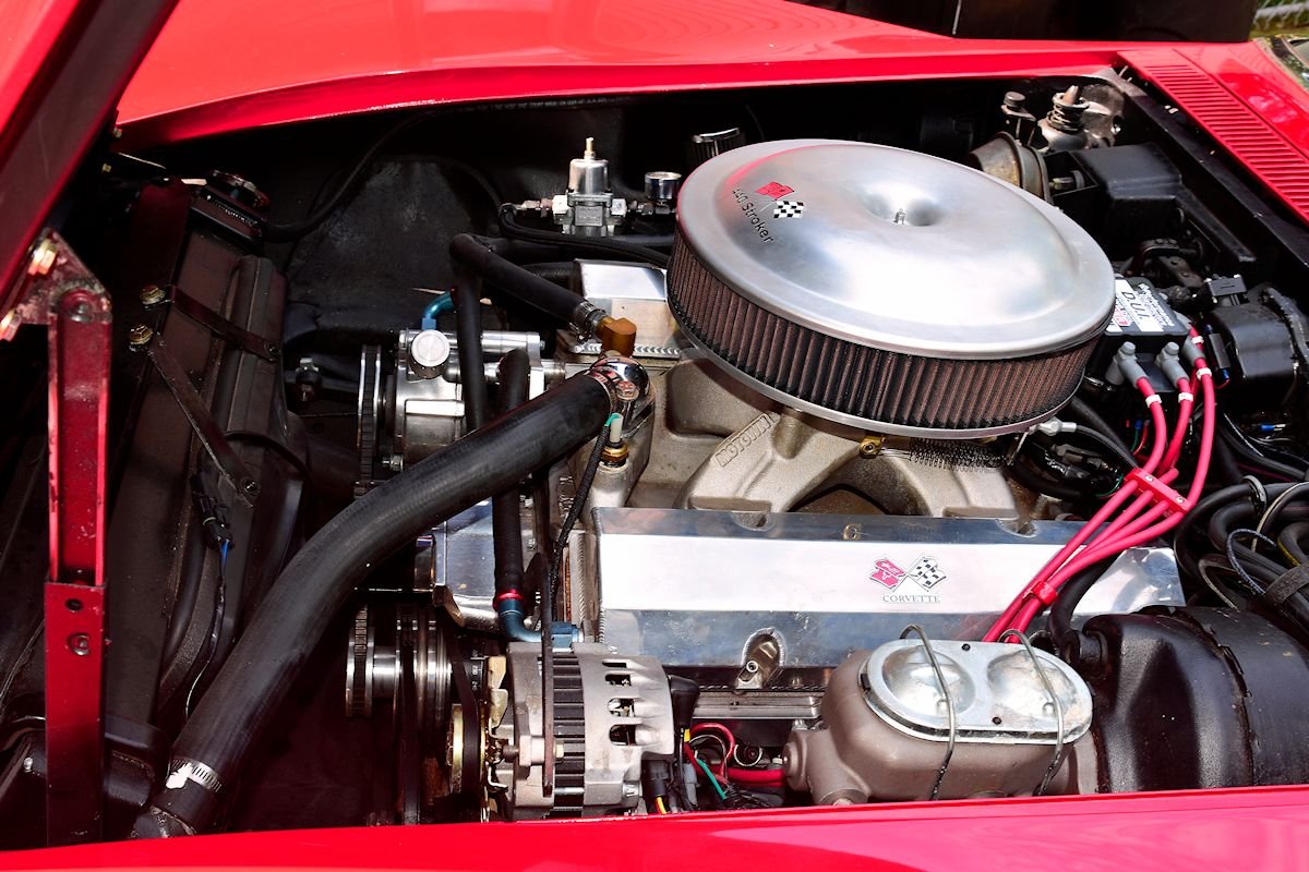

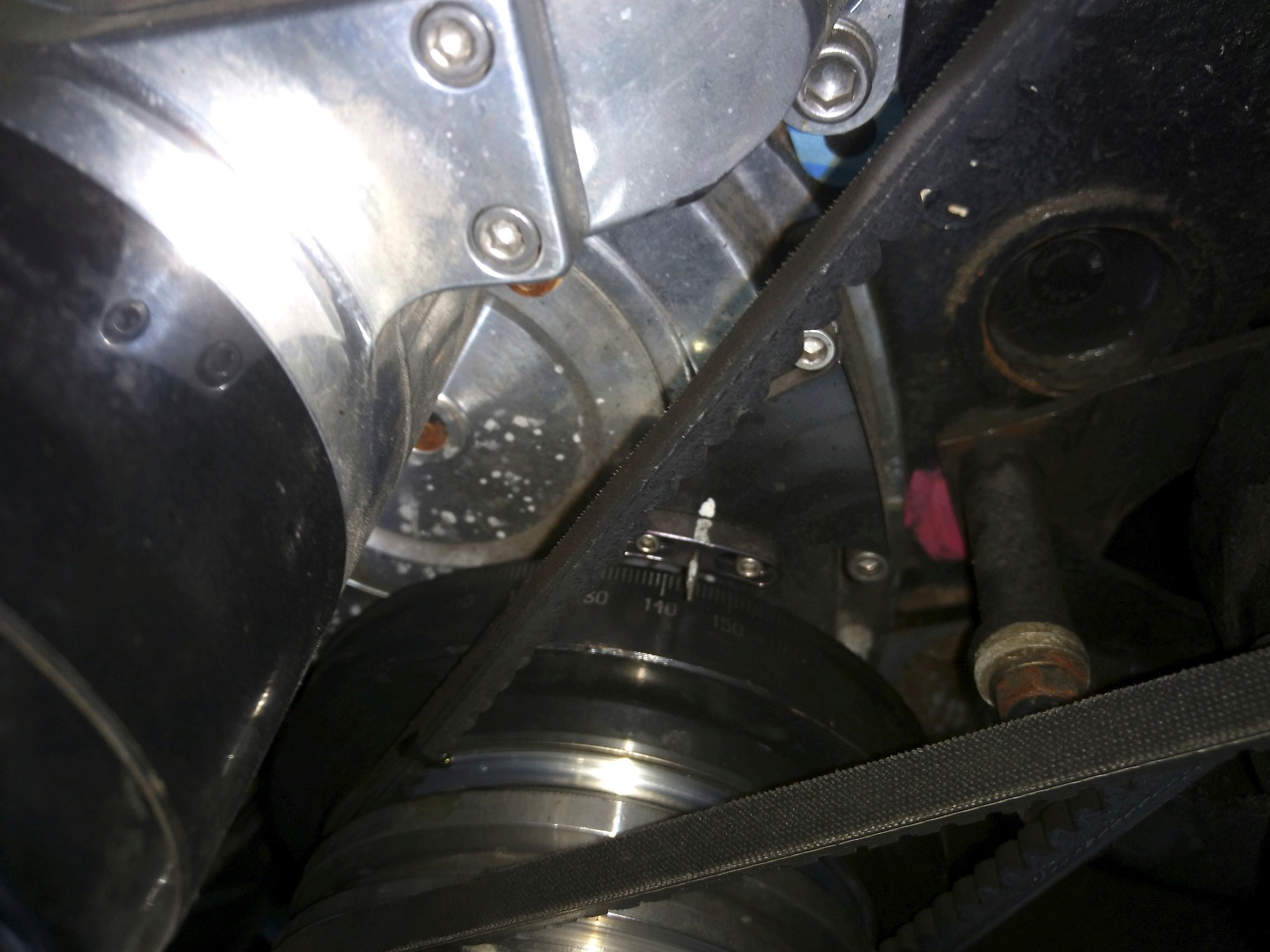

I have a small block (440 SBC) with a Meziere electric water pump in my '69. Yes, it does fit the alternator belt in the stock location, just get the right length to adjust the alternator properly. There is a Meziere model with heater hose valves if you want to retain the hoses (I have that one). I have power steering and no problem with fitment. Also, I have an electric fan and a 140 amp CS130 type alternator works fine. BTW, that's a vacuum pump on the right side, not AC.
Some Pics.....

Oh man @C3 Stroker , you really saved me! That’s great to know!!!
I’ve deleted my heater (Florida), so no worries there. Nice looking set up you have. I bet she screams! I had a 383 in my ‘69 (long gone) and it would lite up 9.5” wide drag radials, so can’t imagine what kind of a wild ride yours must be when you goose it. Thanks again, very much!!!

litevette I have the 55 gph pump, and generally runs at 180 degrees on 90 degree days, never overheats.

@383 Stroker did you have to give the bracket a shave to mount it on the water pump there?
Old Oct 26, 2025 | 11:22 AM
C3 Stroker's Avatar
C3 Stroker
Posts: 3,926
Likes: 739
From: Youngstown Ohio
No, that's the same spot it mounts to with the stock pump. No change.
