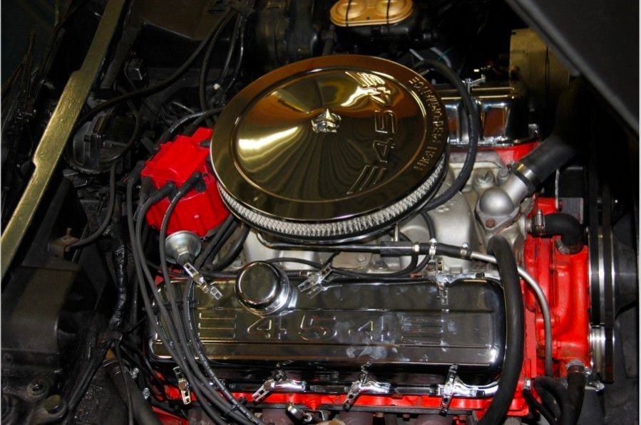

A properly clocked points distributor should not even be close to pointing towards the firewall. It should be pointing towards the passenger side of the car. HEI same thing, see post 3.

Old Nov 24, 2025 | 05:23 PM

FWIW: No OE GM HEI distributor has a mechanical cable tach drive; None. HEI w/ tach drive are aftermarket only. All GM coil-in-cap HEI caps have an OD that's Much larger than points cap OD.
Might require a '75-up OE air cleaner assembly for the Much-larger diameter HEI dist cap to not bind. Or some aftermarket air cleaner assembly. The OE HEI air cleaner assembly bases have substantial flat "dent" to afford clearance for HEI cap. Also, some amateur oval track race air cleaner bases for 14" filters have a substantially offset opening for carb AND a "crooked bent" threaded rod for lid. It essentially moves entire air cleaner assembly Forward (in reference to threaded hole in carb) an inch or so. Speedway, Allstar etc sells those.

Did you look at post 3 which shows an HEI distributor?
You can buy an aftermarket with a cable drive tach.
