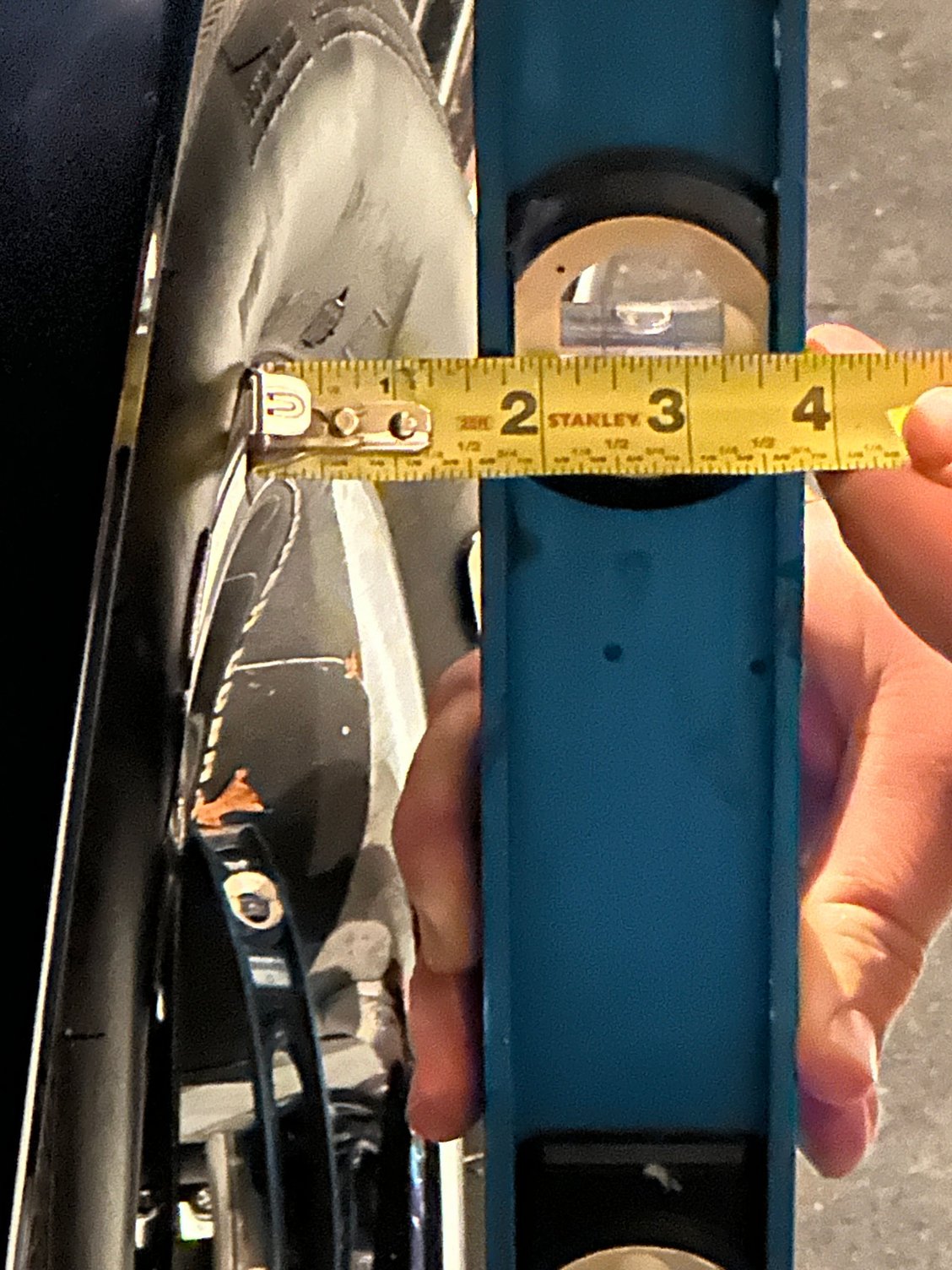

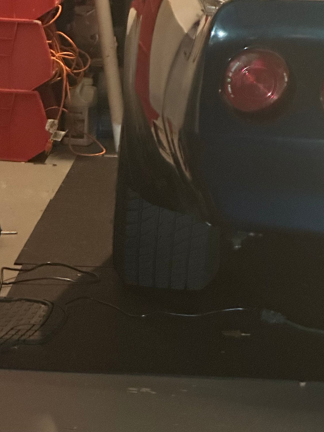

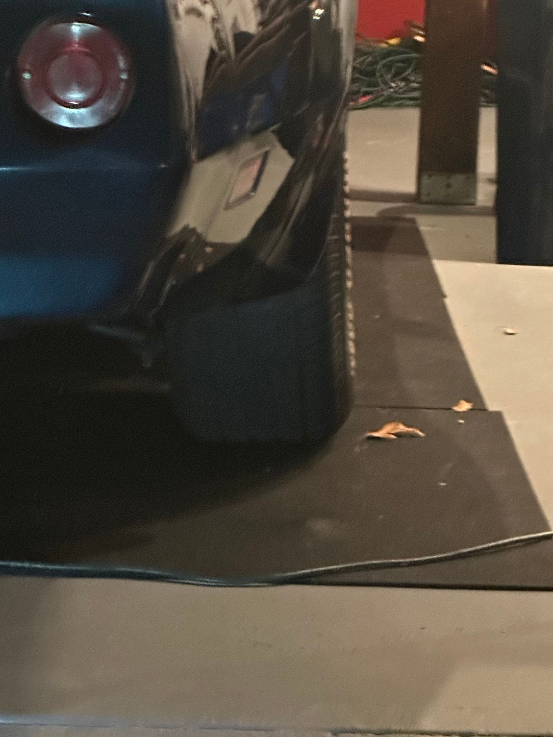

below are pictures of the chamber. 2 1/2 to 3 inches was a bad guess. Checking it with a level, the top of the passenger tire is in about an inch and a half from the bottom. The driver side is a bit less- 1.25 inch

Order new heim ends, and replace the poly bushing ends on your adjustable strut rods. It has failed, and that is the cause of your squatting. Even if you get the camber back correct statically, your camber will be all over the place when driving. Check your trailing arm bushings, too. You have so much camber, your trailing arms are twisted, and even your lower shock bushings appear to be failing.
Poly is great almost everywhere where they have a single rotation movement. It is not suitable for strut rods and trailing arms, which have a complex movement. There was also a bad batch of poly bushings that made the rounds perhaps 20 years ago. Perhaps you got some of those.
Here's the thread on DIY heim jointed strut rods, or you can order complete heim-jointed strut rods from a Corvette vendor.
