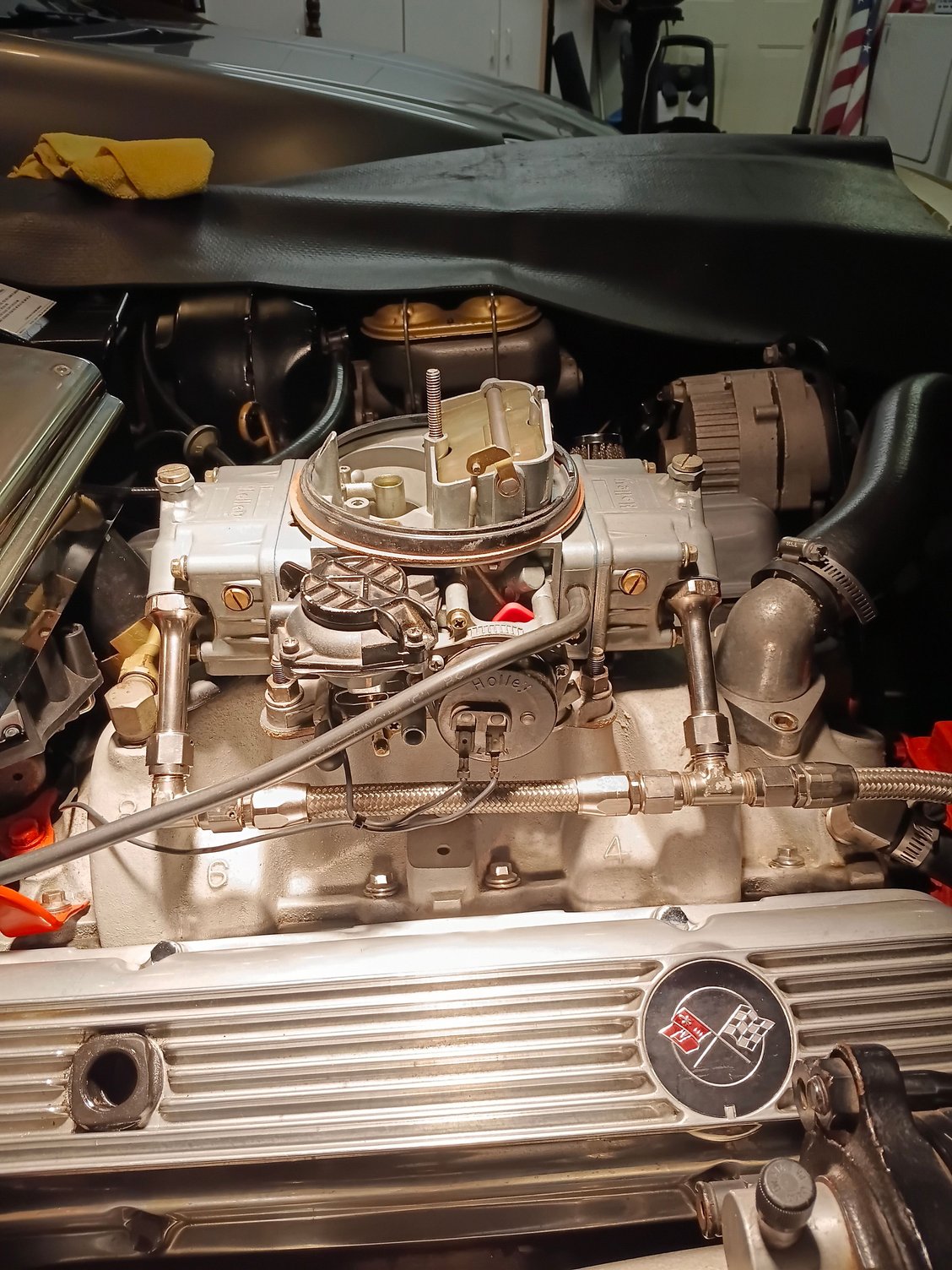

Thanks Lars...said that, with the help like youself and others (on this site), it has made this particulr issue much much easier to solve!! Again Thanks!! Said that....after solving a couple more issues....I'm pretty confident she will make it from Sana Monica/Chicago and back i.e. 100th Anniversary Route 66
btw: When I found this LT-1 back in 2005...she was mostly all correct except for the missing 6239 carb and AIR hardware. With this site...back in...ohhh, maybe 2007 did I find both missing parts "correct dates". This was before I found you and your tunning papers ect. Said that...I sent that 6239 to someone that restored it. I did install that carb on the car...which I could immidiatly tell it was not correct. ;( Due to "at the time" time constraints.... I purchased this Sreet Avanger from 'Summit which has been good all this time....well untill recently, which is good now!! I'm thinking now, after complety rebuilding this SA, I now have confidence to completely rebuild the 6239. Needless to say, I am very curious to hear/feel how Zora intended this LT-1 to breath! If I can not manage it....probably/hopefully be able to send it to you? Cheers and fairwinds!!
Originally Posted by cagotzmann
Here is how I tested the secondary's. Used a video camera.
Holley 770 Street Avenger vacuum secondaries operation
Nice!! Yep, visually and audibility music to the ear!! Great job...said that...I was "a week ago" contemplating our Gopro due to not being able to get the paperclip tattletell to work correctly. I was able to fially get the paperclip to work by playing with the paperclip via neddle nose pliers "bend here, bend there" so as to make it tight enough to hold on...but inturn to also slip... Cheers!
