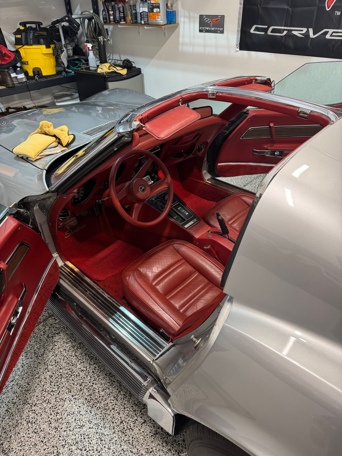

While I have no input of value as to your questions/goals, I do want to congratulate you on your new and very pretty ride. I’ve always loved silver with a red interior!
