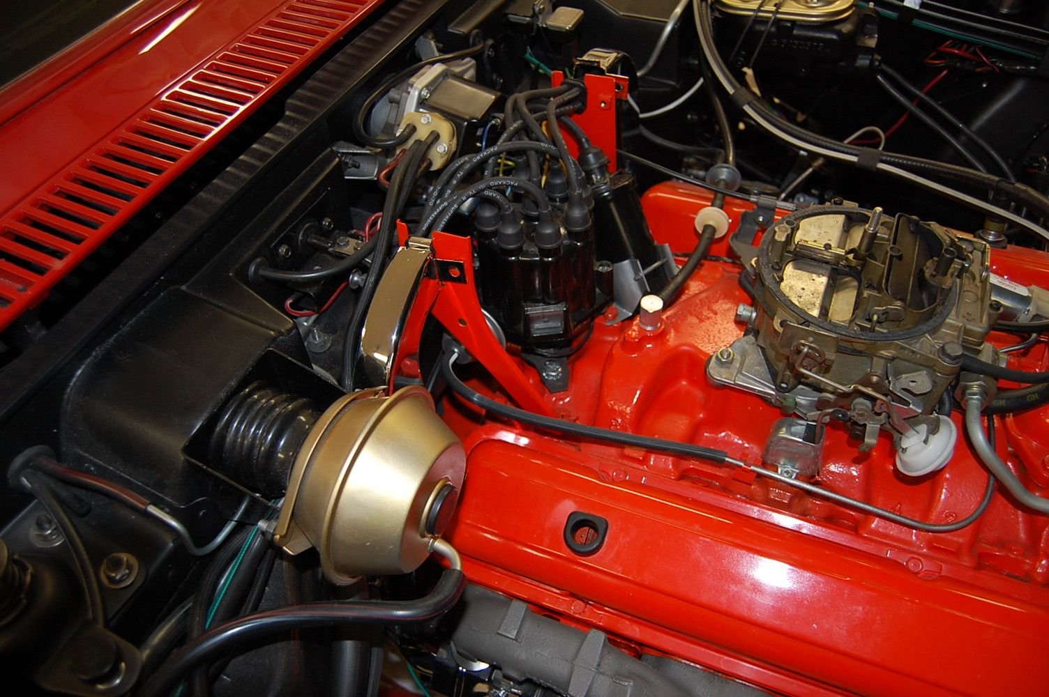

Hello kb,
Welcome!
Your 71 base engine originally had a 'Combined Emission Control' system.
If it's still on your engine but not operating properly it could be causing you some timing issues when the engine reaches operating temperatures.
Is its there?
Regards....
This system affects idle rpm when the engine is cold and when it's warmed up.
