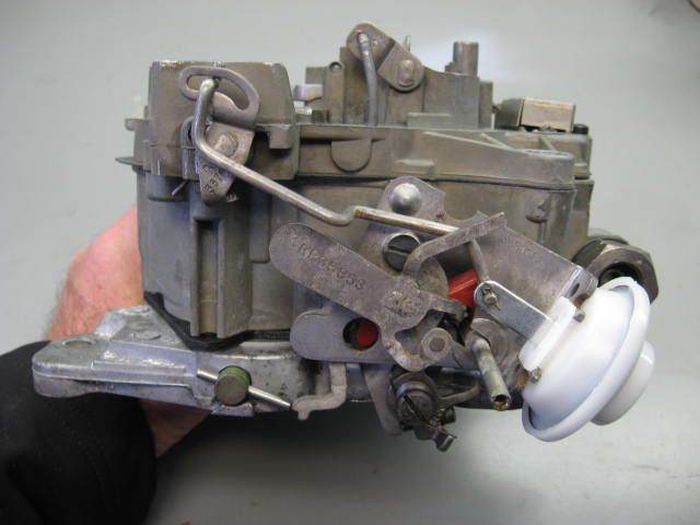

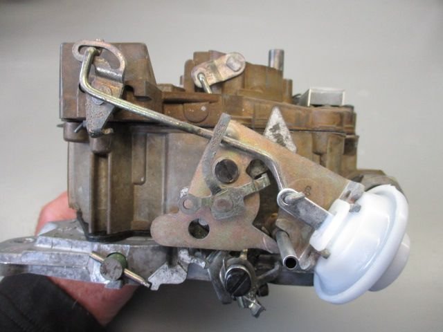

Originally Posted by Ky68Vette
Ok What mods are needed and is there a way to tell if it has already been modified ? THX
Highly unlikely that it has been modified (correctly) to mimic the big block carb specs. You can just measure the idle air bypass holes in the throttle plate to verify.
The differences between the small block and the big block carbs, and the mods that are done to turn a small block carb into a big block carb, are as follows:
  • Different primary jets
  • Different primary rods
  • Different secondary rods
  • IFRs changed from .035 to .039
  • DCRs changed from .052 to .055
  • Upper and lower IABs changed to 427 spec
  • Idle air bypass passages in throttle plate changed from .073 to .120
Additionally, the 1968 427 Vette carb is the only Chevy Q-Jet that has a reverse-rotation choke system. It uses a unique choke coil to operate the choke lever "backwards" using a "duck bill" choke counterweight. If your car has the original 1968 choke coil, you have to change it to a 1969-type coil to make a non-'68 Vette carb choke operate correctly.
1968 427 Vette choke system:
1969 small block carb system:
If the carb is running fine in its current condition, leave it alone and run it. It should run pretty good just set up to its stock small block hi perf specs.
