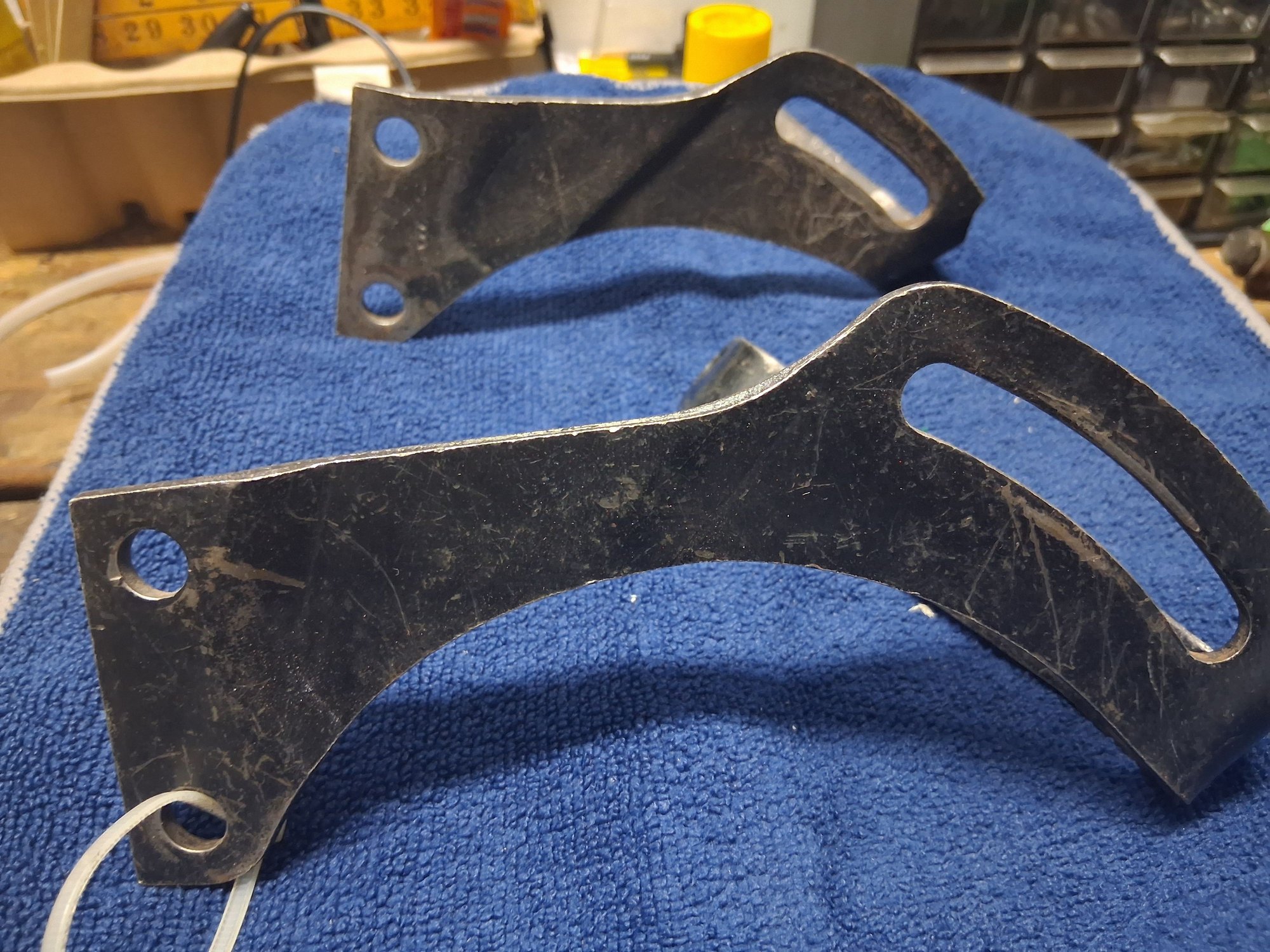

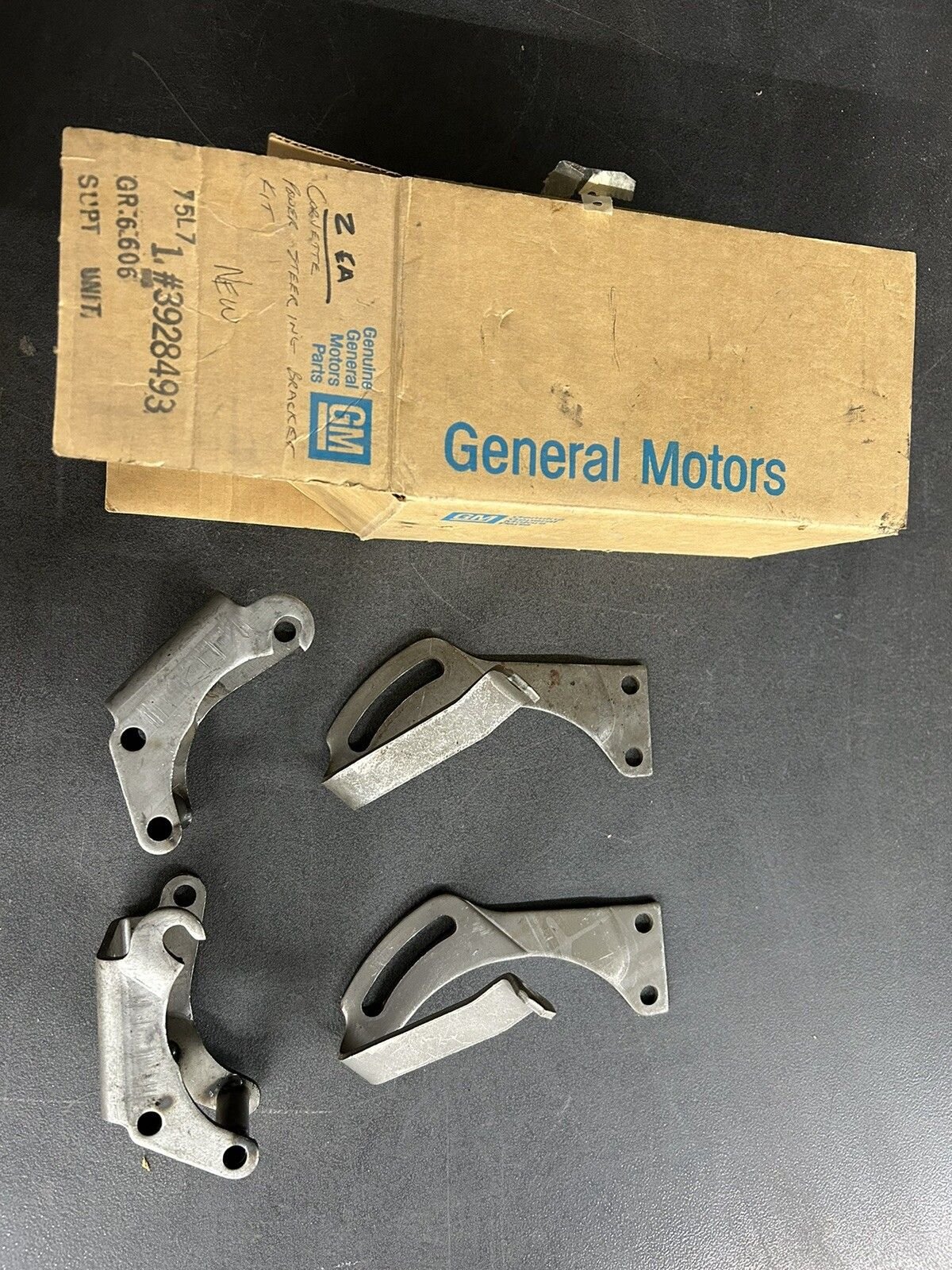

Originally Posted by alt66
There are 2 different brackets for that style see pic.The pickups from that era I believe up to 87 used the same setup.I can't see mine on my 72 but the cap clears to come straight off and it is an original numbers match car.If yours is out of adjustment and it is the short bracket need to look for the other one.From that diagram that is posted above it looks to me like it shows the long bracket.
3928493 is the GM part number for the p/s mounting bracket kit. Corvettes used the longer adjusting bracket.
https://www.ebay.com/itm/275900752378
