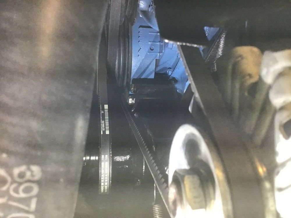

I could not remove mine when i got my car. Used a longer belt almost easy now.
here is a thread with your 77 size too.
https://www.corvetteforum.com/forums...ay-please.html
here is a thread i did some n this specific issue
https://www.corvetteforum.com/forums...ss-c3-fix.html

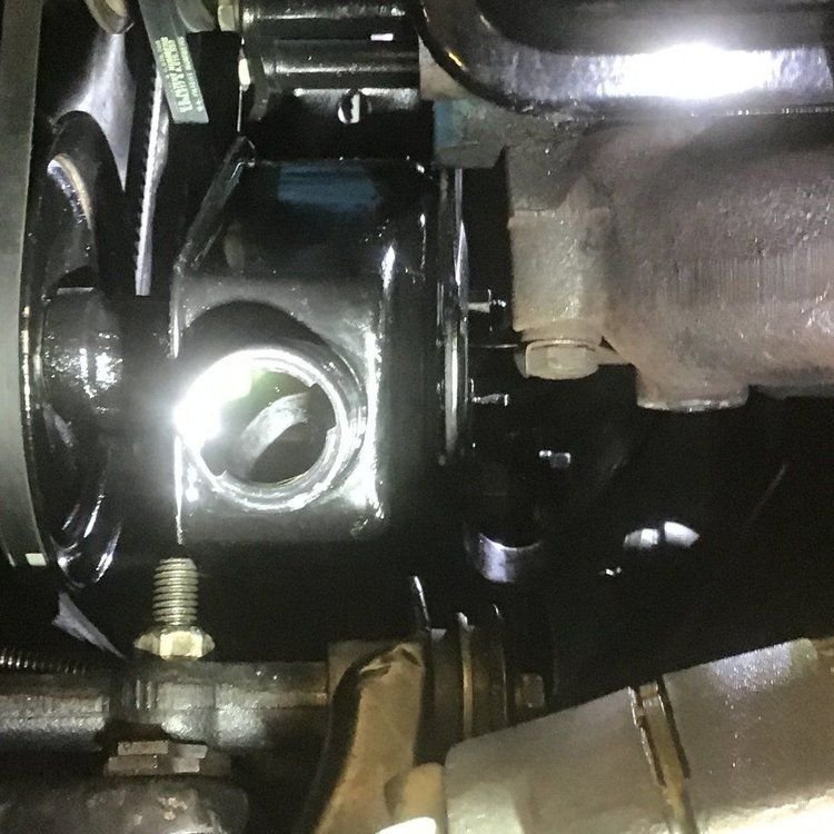

I wish it was this easy...mine does not come out any which way. It is a new pump, but same dimensions as the original. There is very little movement in the pump. The pump different than the one you have...maybe its shorter. That is why I am trying to see if there is another alternator bracket that I could use that would be less intrusive.

get a longer belt and try it.. make sure you have right belt to start with.. see advice in thread i posted for 77 given. add 1/2 inch on my 79 fixed my issue. and no it would not open with any angle at first for me.

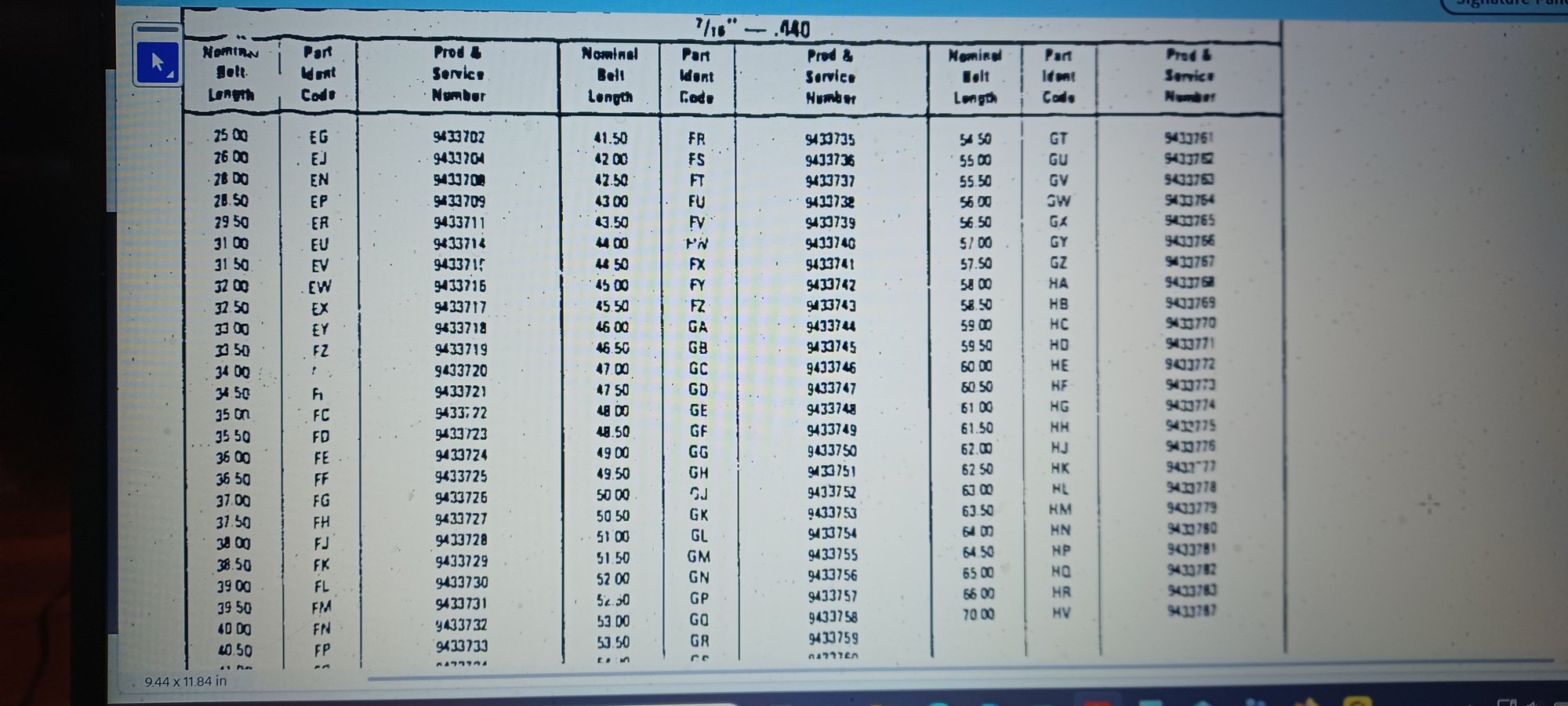

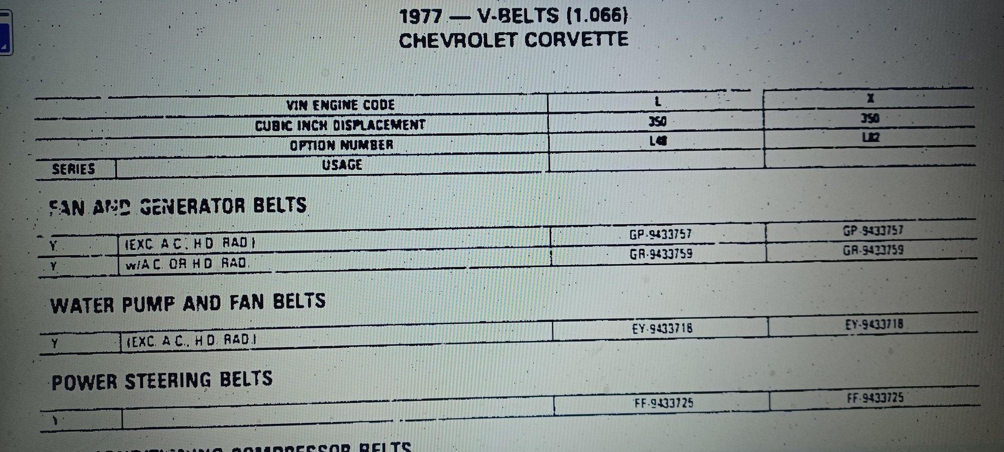

9433757 alternator belt dimensions 52.5 x 7/16
9433759 alternator belt dimensions 53.5 x 7/16
9433725 power steering belt dimensions 36.5 x 7/16

I just looked at mine & it sits more to the left than yours.
I think interpon is right....you need a longer P/S belt. Pull it off & take it to the parts store. See if a new one is longer..

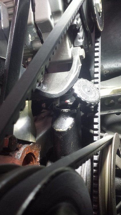

There are 2 different brackets for that style see pic.The pickups from that era I believe up to 87 used the same setup.I can't see mine on my 72 but the cap clears to come straight off and it is an original numbers match car.If yours is out of adjustment and it is the short bracket need to look for the other one.From that diagram that is posted above it looks to me like it shows the long bracket.
To C3 Power Steering Pump Bracket
