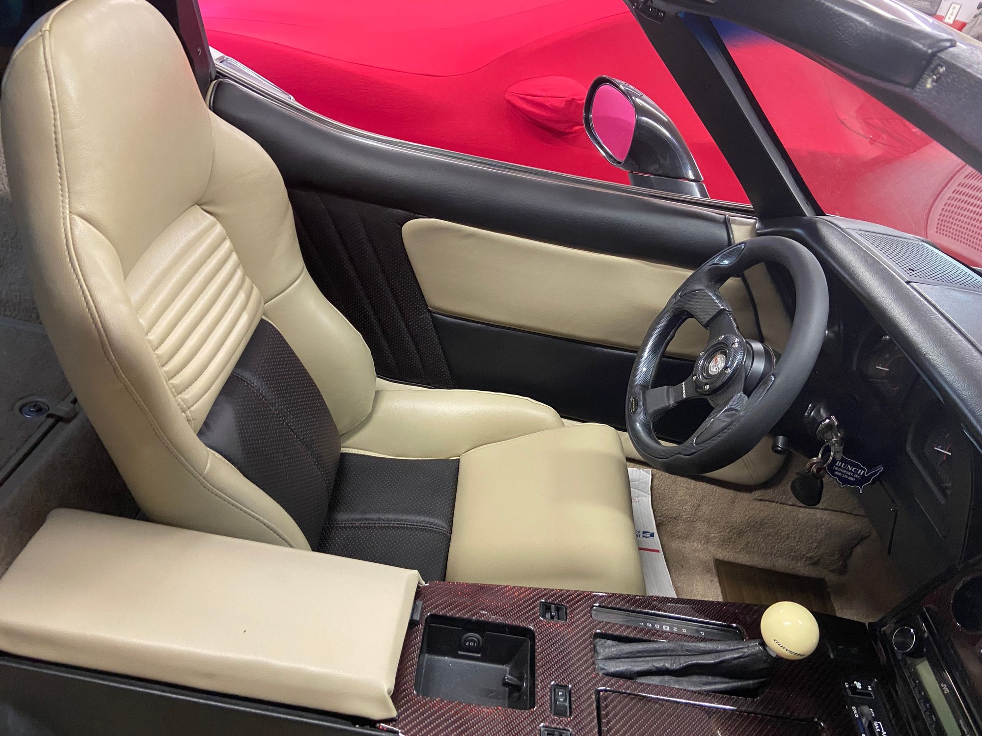

C4 seat fit fine oem existing track. You just need to make ( or you can buy) adapters to line up the C4 bases to the C3 track. I made mine out of 2" flat stock. Pretty easy and very happy with the results.

Those are real nice !

C4 console?

What steering wheel?

Thanks for the nice words. Yes the seats look nice and function really well. Not sure if you can see it in the pics but the center is black leather perforated w/ red. Same as the door panels. The car will be red, eventually. That is a C4 console. It took a lot of trial and error and fitting to get it to morph into the C3 gauge pod. Then fitting a B & M shifter just added to the "fun". Lots of CHANGING DIRECTION but it all started because I wanted cup holders! As in the C4, there are 2 under the flip up lid on the right. And the steering wheel is NRG 792926.
