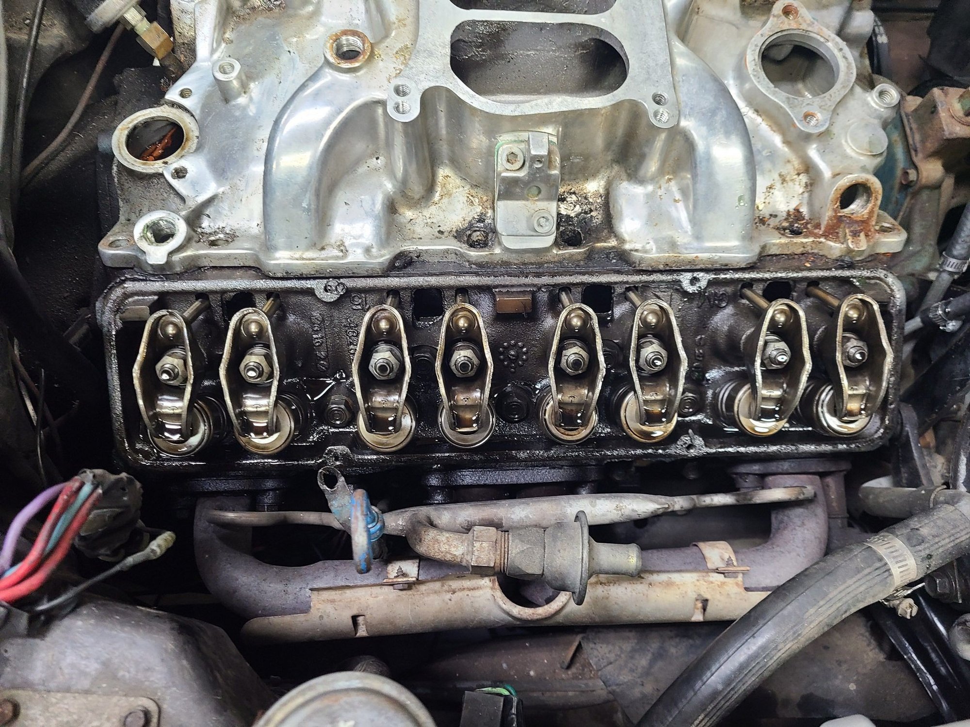

Got the valve covers off and one side looked like it might have the correct fasteners the other side had hardware store bolts. Doesn't look too bad in there so far just a few bits of gasket laying around.
JT

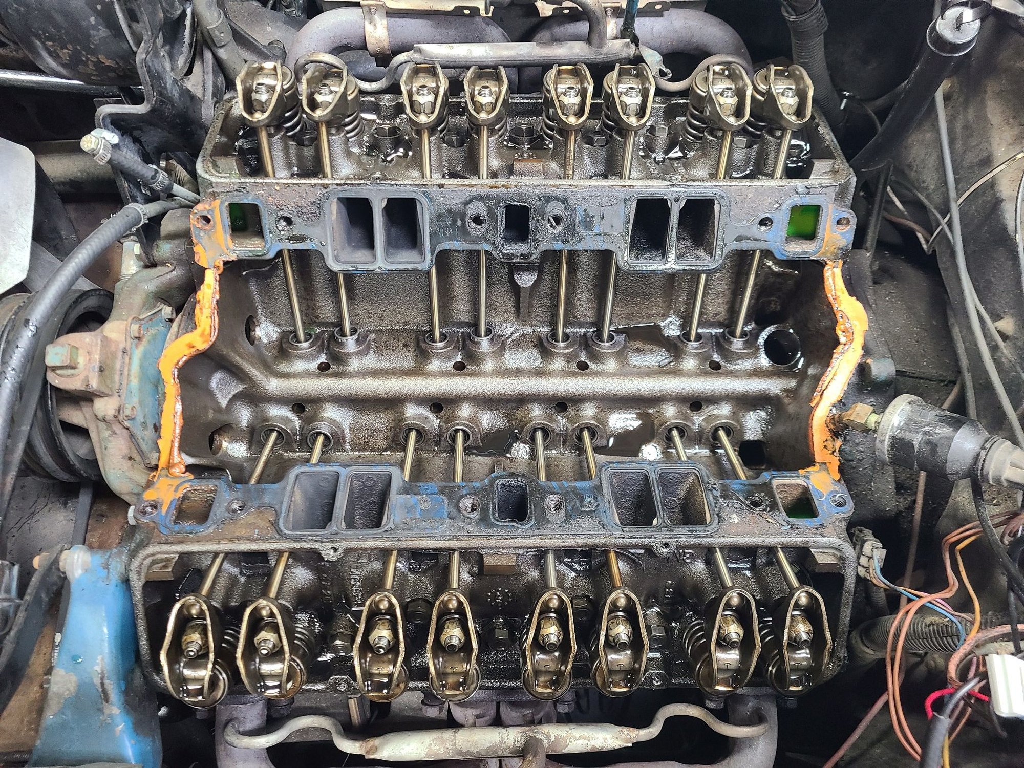

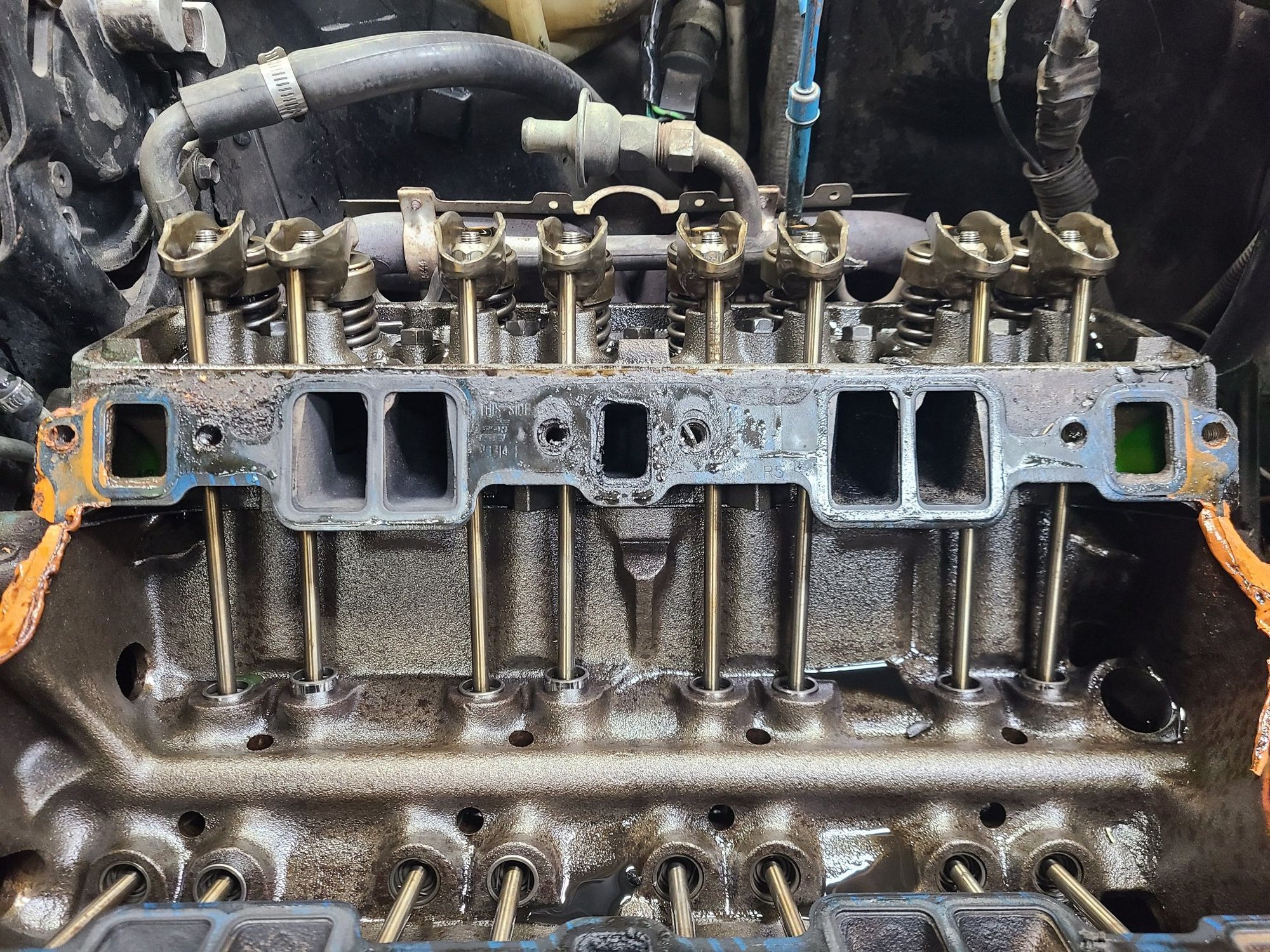

This is where I'm at today, my plan is to plug all the hole that go to the sump with some rags and clean off the gasket and gunk. Then it looks like I need to take the fan and fan clutch off at the minimum to be able to turn the motor over by hand.

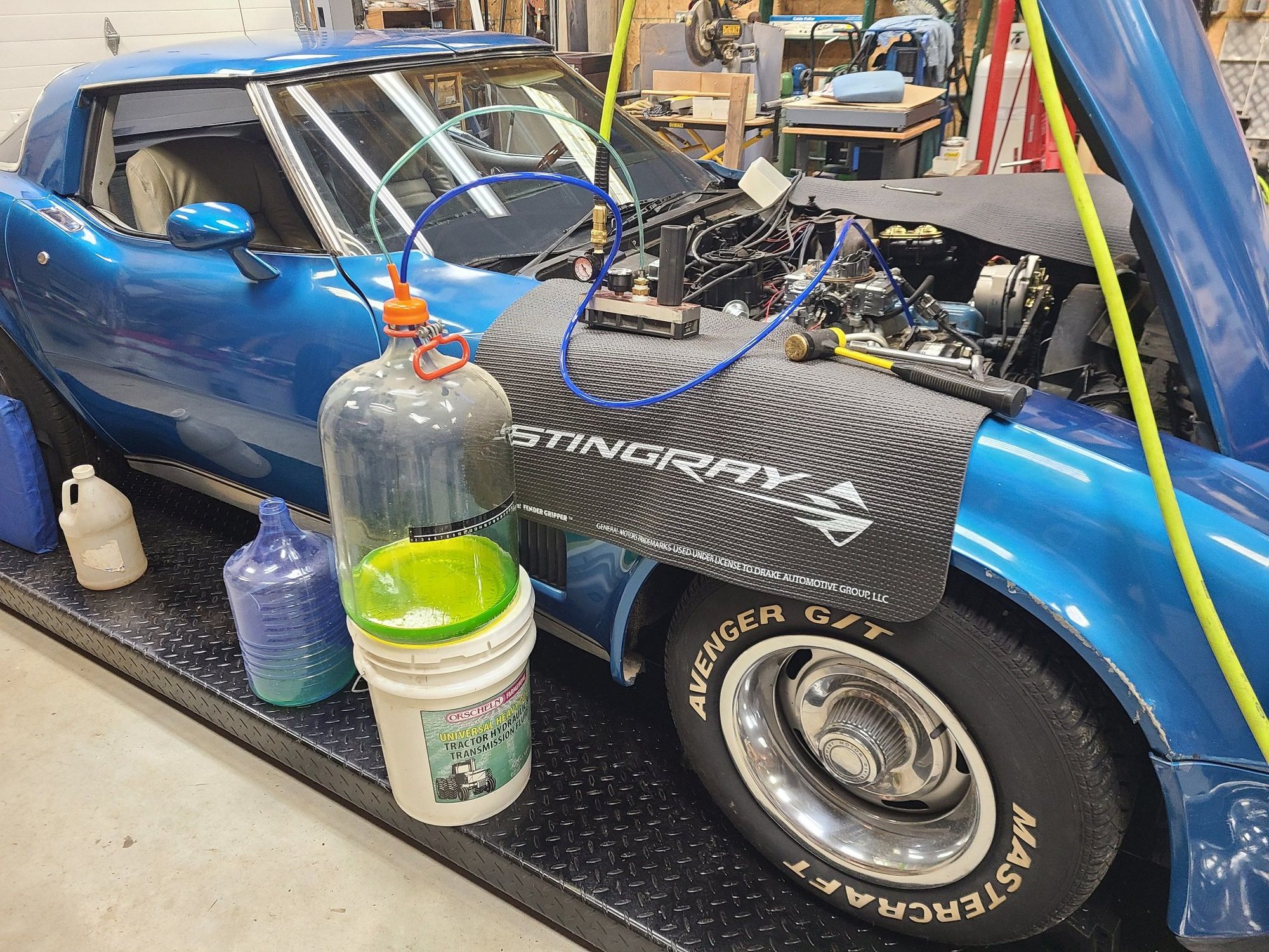

And I forgot to show how I sucked the coolant out of the manifold and some out of the radiator. The thing on the fender is a vacuum generator and the glass carboy is for making wine and the orange cap with another part is how you siphon the wine out of the carboy.
JT

where the Mr G breather is now, was probably an OE hose-pipe from base of air cleaner assembly >>> supplying air thru Pass head and into crankcase >>> then evacuating thru Driver head and out the PCV to carb base>>> drawn into intake plenum and into chambers then burned.
* have virtually same tires on mine. Both your Mastercraft Avenger and Jetzon Revenger manufactured same company. I've compared them long ago and they're in all ways identical.

I'm thinking at this point that I'd be better off just pulling the exhaust manifolds off then pulling the heads off. This way I can work on them on the bench and get more information about what I have for pistons and measure the deck height.
JT

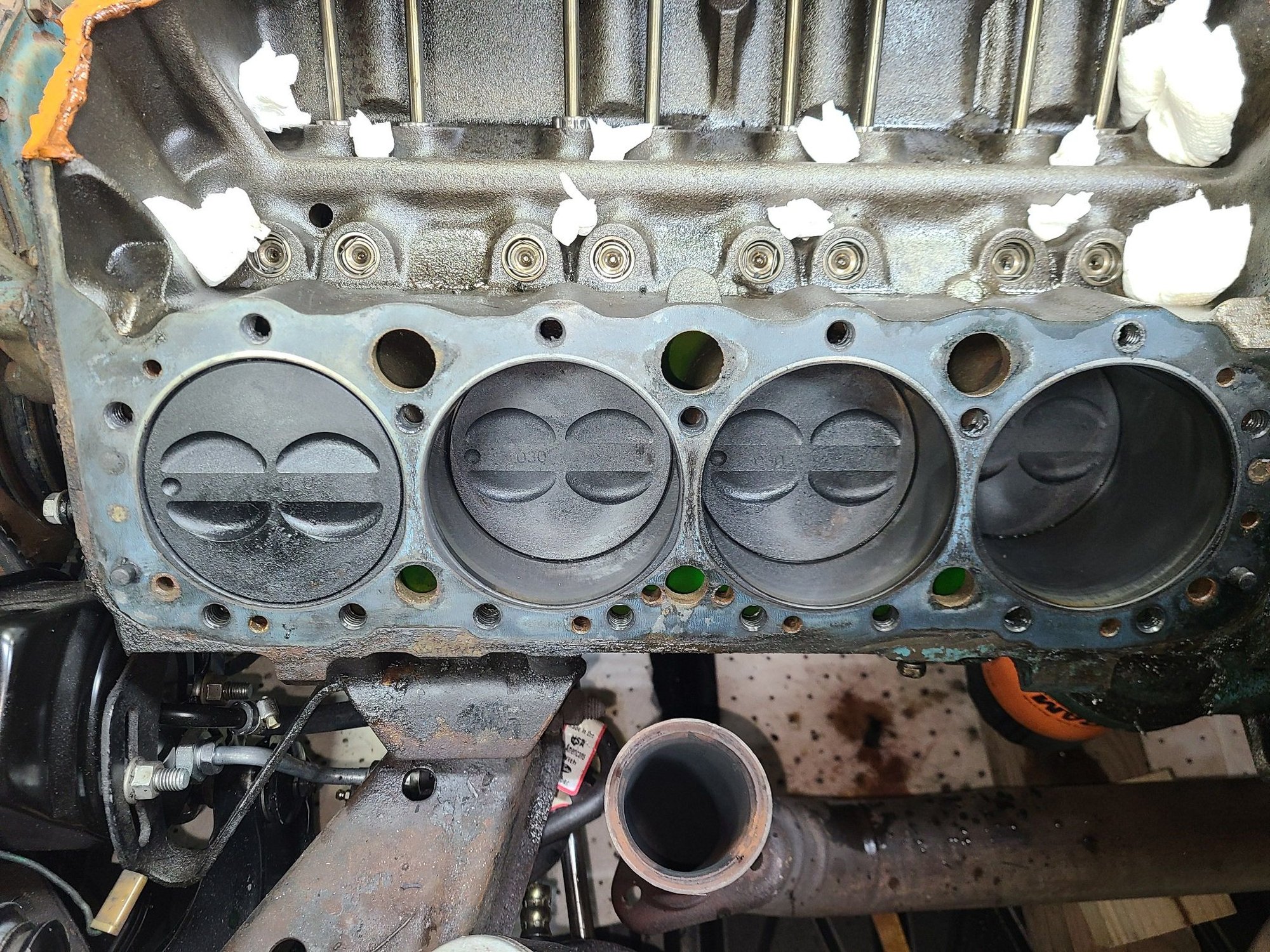

Ok I got the drivers side head off and the bore is 4.030" and the piston is 0.025" below the deck at TDC.
JT

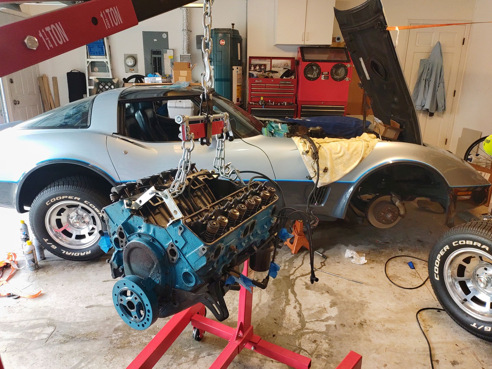

I'm glad I decided to pull the motor out as the deeper I look the more stuff needs replacing like the lower radiator hose, the heater hose from the water pump, the heater control valve, the dip stick tube is loose and wobbles all over. It will be a lot easier to fix Bubba's wiring modifications with the engine out.
Are there any heads up I need to know about pulling the engine and leaving the 700R4 in the car?
JT

The dipstick is pressed into the block but should have an additional support tab securing it to the block.
I supported the transmission with a scissors Jack with a block of wood on the transmission oil pan while the car is on Jack stands. You don't need to remove the hood but I disconnected the hood support to get the hood to open wider using a ratchet strap tied to some shelving in my garage. Removing the water pump gives you some extra room to work with. But the one thing that I would strongly recommend is a load leveler. Makes the job much easier.

I recall that I'd used a length of either 2x4 or 2x2 to bridge across C3 frame rails and supported front of TH400; simply jammed it in; where it remained for many weeks while car was on about six or eight jackstands. Seems, I may have pulled converter and that bellhousing's lower angle rested on bridge. This job was in a buddy's large quonset hangar and had use of Very large rolling crane (way more than a cherry picker).That's been quite a while back +20yrs. Sorry, no pic.
Remember lowering car onto wheels, (motor out but trans still in) and we towed it along strip to another buddy's hangar; where I built motor and dynoed it in his cell. Soon sold it and bought a roadster.

@Fly skids up! Thanks, I have a jack tray on the 4 post that I can use to hold the transmission up with. I'm going to get or make a load leveler I have the stock and machines to make one and I have a piece of acme thread rod that needs a home so why not. I was looking at the water pump and thinking it would be better off the engine. I hope to find a set of those wheels one day for my C3...

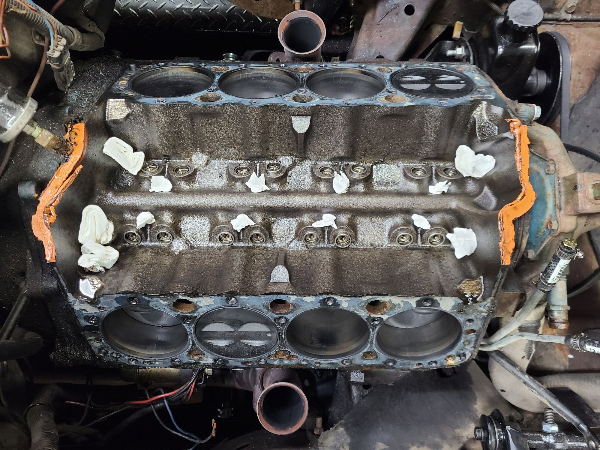

Both heads are off and oddly the passenger head bolts smelled like an old farm shop to me. My grandparents had a dairy farm and that's the smell I remember.
JT

This is where I'm at today.

Unbolt the 3 fasteners that hold the converter to the flexplate and slide it back as far as it will go. Once you support the transmission at the front you can pull the engine. Be very careful to prevent the converter from sliding forward and falling out. They make a big mess all over the floor when they slip off. Rope and a block of wood to press across the converter at a minimum.
