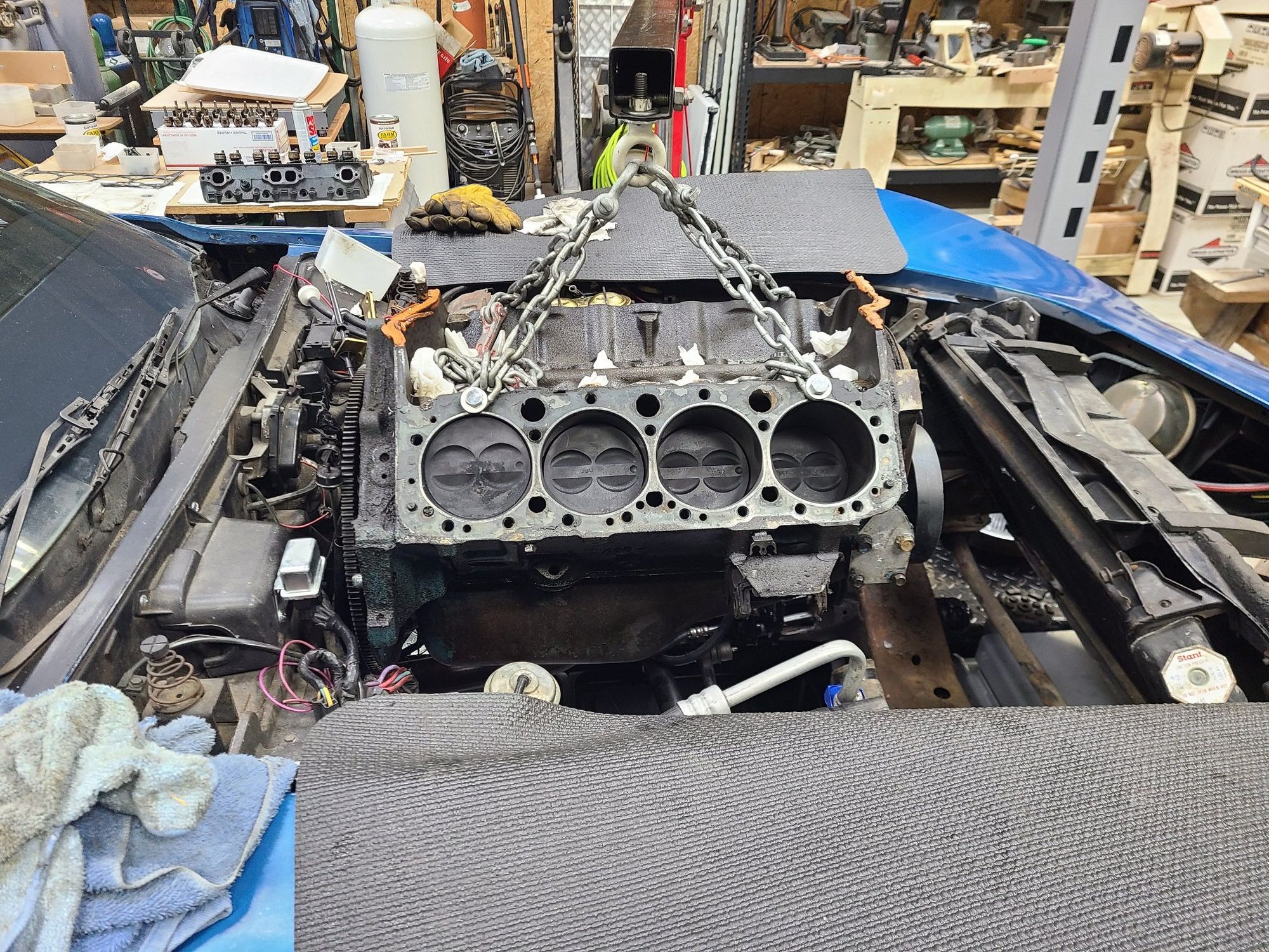

I have not pulled the lifters yet but I have pulled the engine.
Can you spot what fell off when I pulled the engine? You can also see the 2x8 and shims that I used to hold the 700R4 up as I raised the engine.
All in all I think it was a good idea to pull the engine and deal with some of Bubba's work in the engine compartment and be able to do what I need to do to the engine while it's on the engine stand.
JT
Motor Mount. How did you like swinging that iron over your pristine fenders??

It is was a nervous moment for sure.
Edit: thinking back at the moment of jacking up the engine I was so in tune to the engine hoist I heard every tiny creak the hoist made as I jacked the engine up. The pulling the hoist every so slowly over the fender so as to not screw up... and being very relieved once I cleared the car and the lift.

WAG
once-commonplace: fully-separated driver-side motor mount. Wonder why lock tab didn't hold it together ?.
Because the locking tab is only meant to limit parallel movement. Once everything's unbolted the two halves of free to move in any direction.
