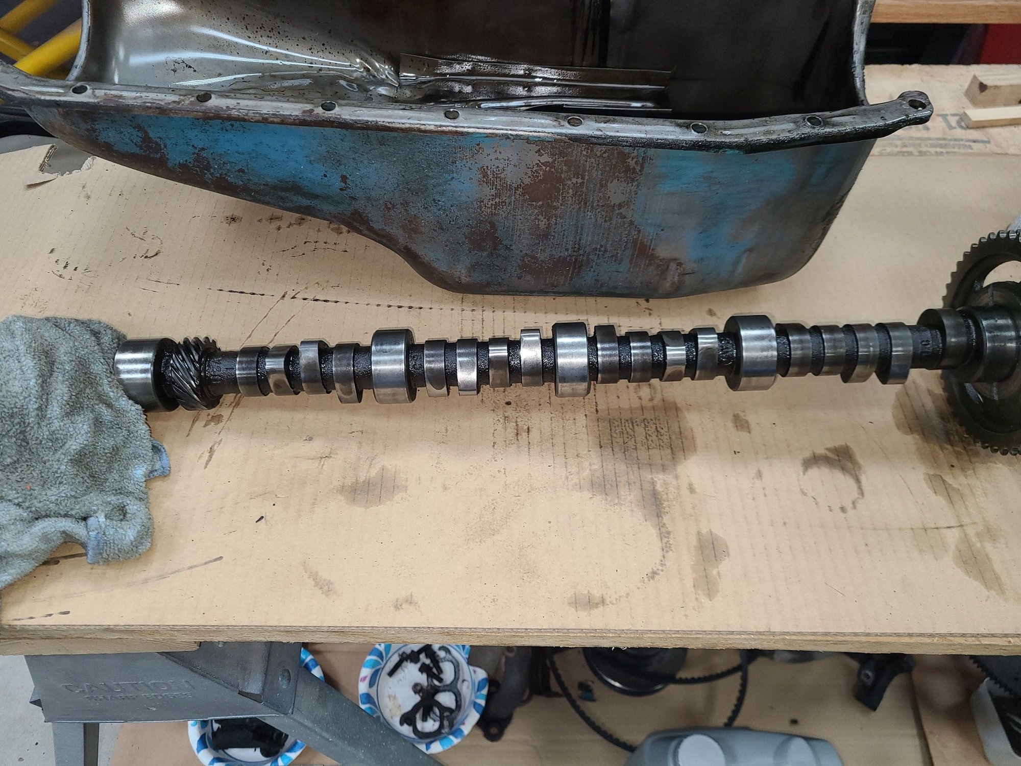

At this point it's wait and see what the cam looks like when I pull it out. How do I tell what cam I have?
Edit: I see some numbers on the end of the cam...
JT

You have the blue one.
It's as mild as the stock L48 cam. Very smooth idle. Pulls hard from idle. Done by 5000rpm.
The red one is the famous 268H cam. Very popular with low C. Ratio engines. More power & a little lope at idle. Great cam. Basically one size bigger than yours, maybe two.
You can do better on a cam, but it depends on your intentions.
What rear gear?
What trans?
Type of driving?
How much in town vs highway?
How aggressive?
Do you want an idle sound?
How high will you rev it?
What rear gear? Unknown, assumed to be stock. AI suggests it's 2.87:1
What trans? 700R4
Type of driving? Cruising to the malt shop
How much in town vs highway? 50/50
How aggressive? Not aggressive at all other than passing on a 2 lane road
Do you want an idle sound? Smooth
How high will you rev it? Unsure maybe 3-4k when passing
JT

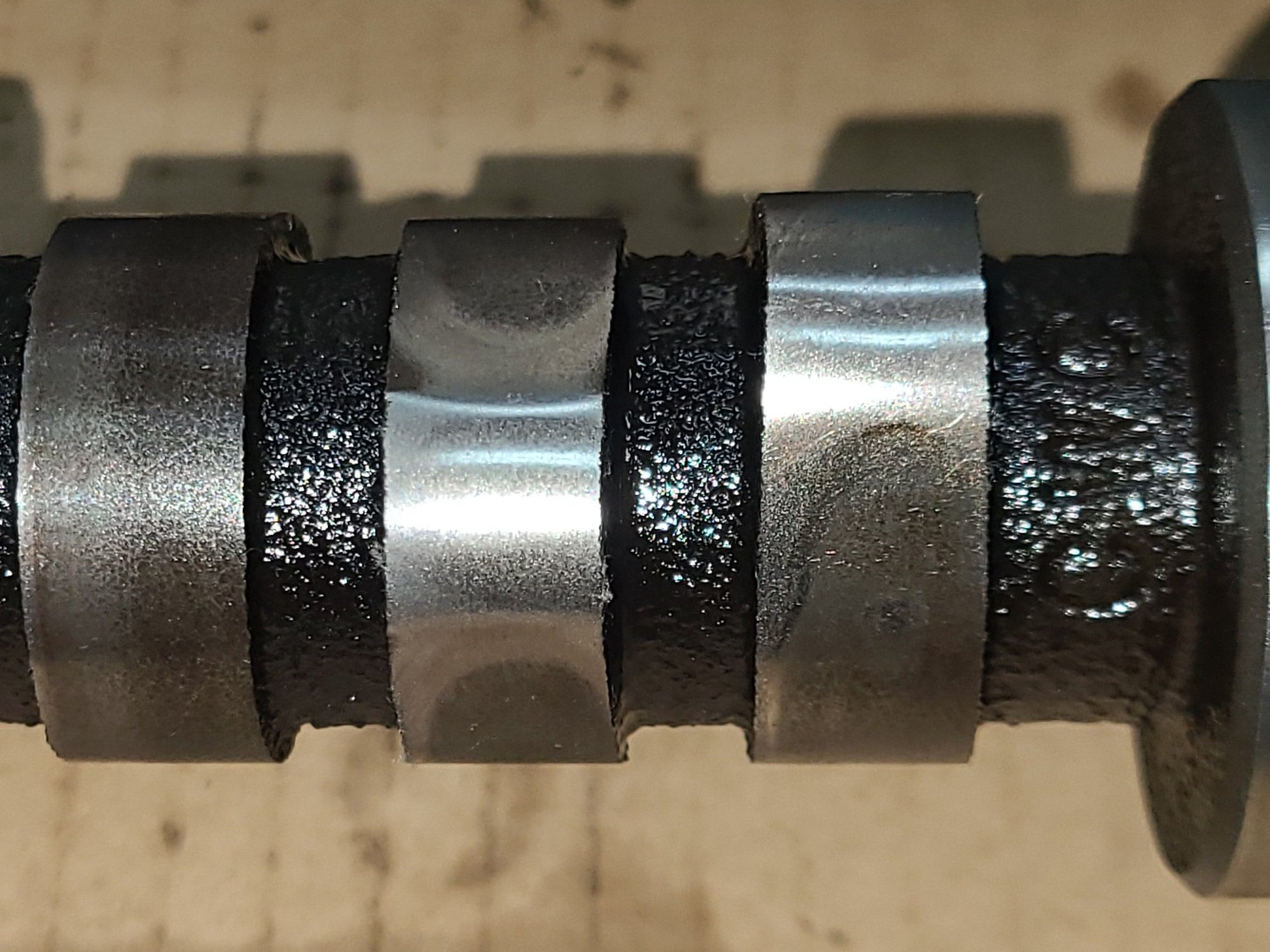

I removed the cam this morning and well it ain't looking good.
I can feel a very tiny burr at the edge of the worn area so I'm assuming a new cam and lifters is in the works for me now.
JT

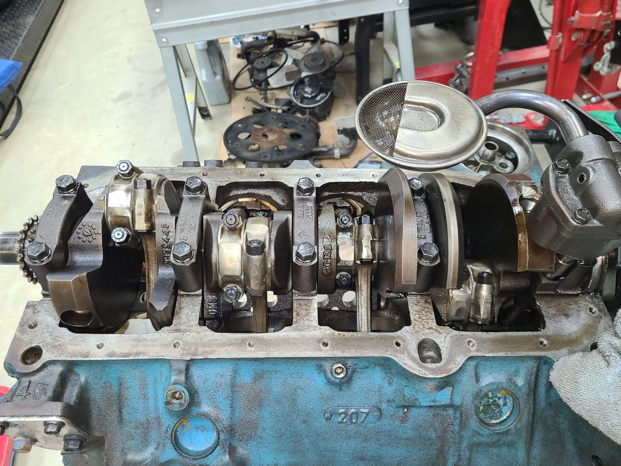

The bottom looks good to me, all the bolts and nuts are the same, the rod caps are marked with number and direction.
JT

If I was you I'd stop right here. That short block is in good shape as it sits, It had nice even compressions, you still have crosshatching in the bores and from that last pic it looks to me as the rotating assembly has been balanced ( the balance pads on the rods have been on the belt sander), and maybe even ARP rod bolts are installed. which is great.
If you have to put a new cam in it, I'd consider going to a roller....much more expensive, but way less headache down the road. Considering your driving style, I'd pick a cam one step larger than what you have in there now. The one in there now is pretty much a stock replacement, and with new aluminum heads that will flow better than the stock ones, a bump in compression and a better flowing intake would be a nice combination that would work well with a larger cam....all driveability would be better, but mid range would be much improved.

Here is my concern with the cam.
The blue circled areas look like they have nice lobes with sharp peaks.
It is the red ones I am worried about.
Do they look like they have the same sharp peaks? Or are they rounded off and going flat?
You can even measure the lobe height with a caliper. But when they go bad it is usually pretty obvious.
You could check the lifter also.
Make sure to keep them all in the exact same original location tho.

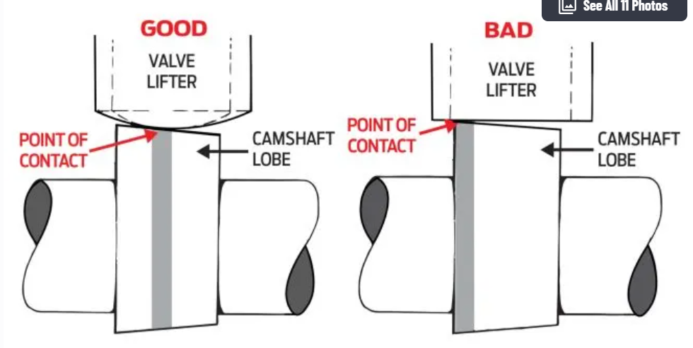

But put a cam surface of one lifter the the side of another.
It NEEDS to have a convex surface, and slightly rock, and only touch in the middle, not the edges.
Lifters will go flat or even concave when they wear badly.
Check all 16. Just don't mix them up, in case you are able to re-use them.
This photo shows how the lifter convex shape is supposed to work:
https://www.hotrod.com/how-to/check-...r-lifter-bores
