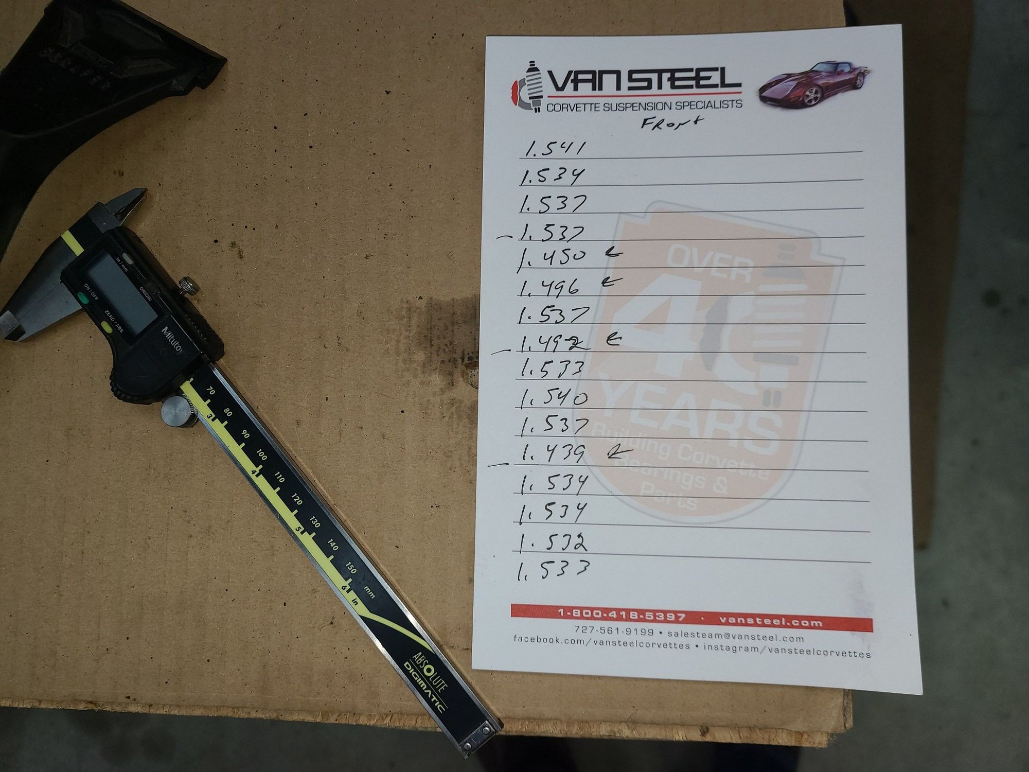

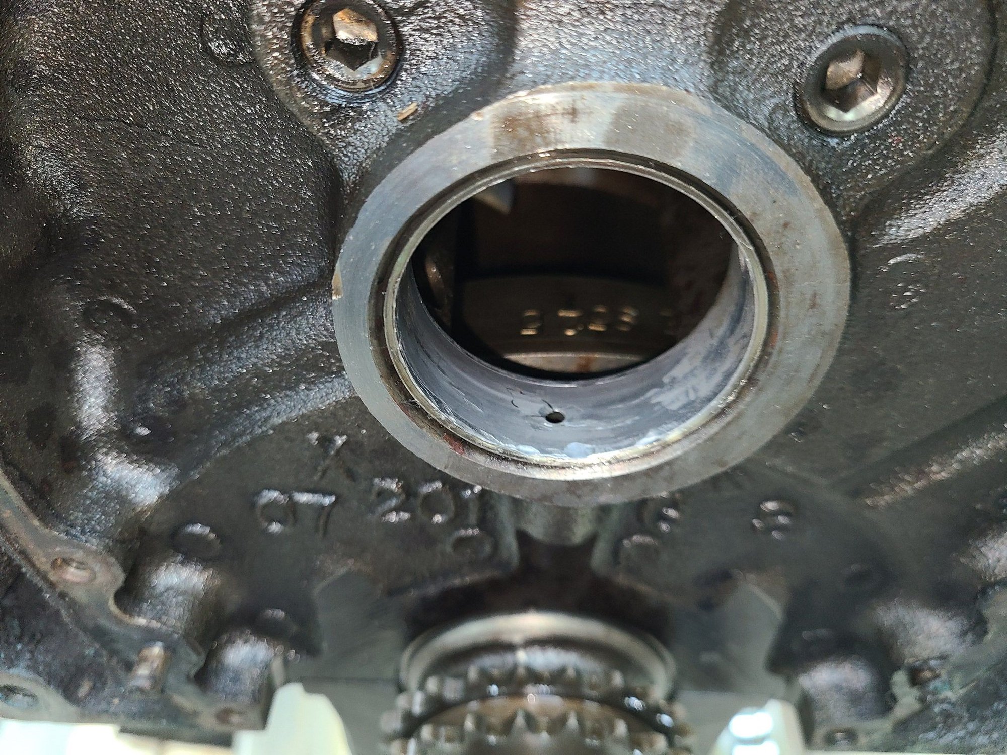

The front cam bearing is a bit beat up... I'll get out the bore scope later and check the rest of them.
I measured each lobe starting at the front and tried to measure in the center as best as I could.

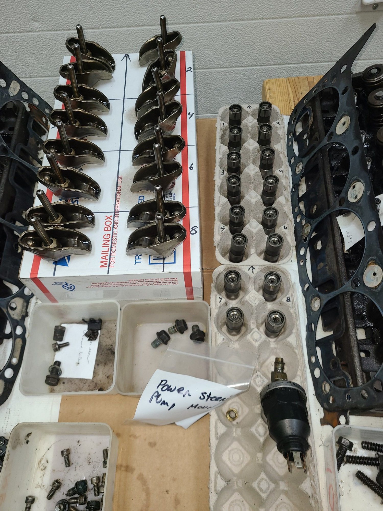

Yup I keep everything in order as it comes out
JT

That cam bearing is shot. The lobes on the camshaft don't look too good either. You can't measure lift with a dial caliber because the lobes are tapered. Jamie mentioned that also in that video. Pull the rod and main caps also and inspect those bearings too. When choosing a keep it conservative. Now comes the sucky part. Are you sure that you have 2.87 gears because the 82 steel wheel cars came standard with 2.72 and the 2.87 optional.

Your old cam and lifters are going in the trash due to wear without question. No need to carefully organize and hang on to them. Flat tappet cams and lifters will work as long as they are quality pieces and broken in right.
Roller cams bring a whole lot of other requirements along with them. There is nothing budget about the swap. Expensive cams, lifters, springs, rockers, pushrods, button spacers, etc. Valve covers might need to be addressed. Maybe the A/C compressor will hit the taller valve covers.....About $1000 extra added to the total bill before you are done. Lots to think about.
Oh, I'm not "sure" about anything on this car except what I've worked on. It probably has the 2.72 I was just googling it.
I was just measuring to see if there was some big differences which there is and I tried to measure in the center due to the taper.

* cam bearing insert # 1 has failed; garbage. The oil gallery plugs have hex heads; they're good but not OE. GM's final iteration of Gen 1 roller motor (L31 vortec) has a small (about 0.025") hole drilled thru center of both R&L plugs (not middle plug) to aide air purging to help quiet motor upon startup.

I tend to organize parts like this during disassembly just in case.
I think I'll take a nap and think about it.

For those following along the lifters on those lobes that were bad are all dished out.
Edit: I just looked at the rest of the cam bearings and they are shot, one even has a chip out of it!

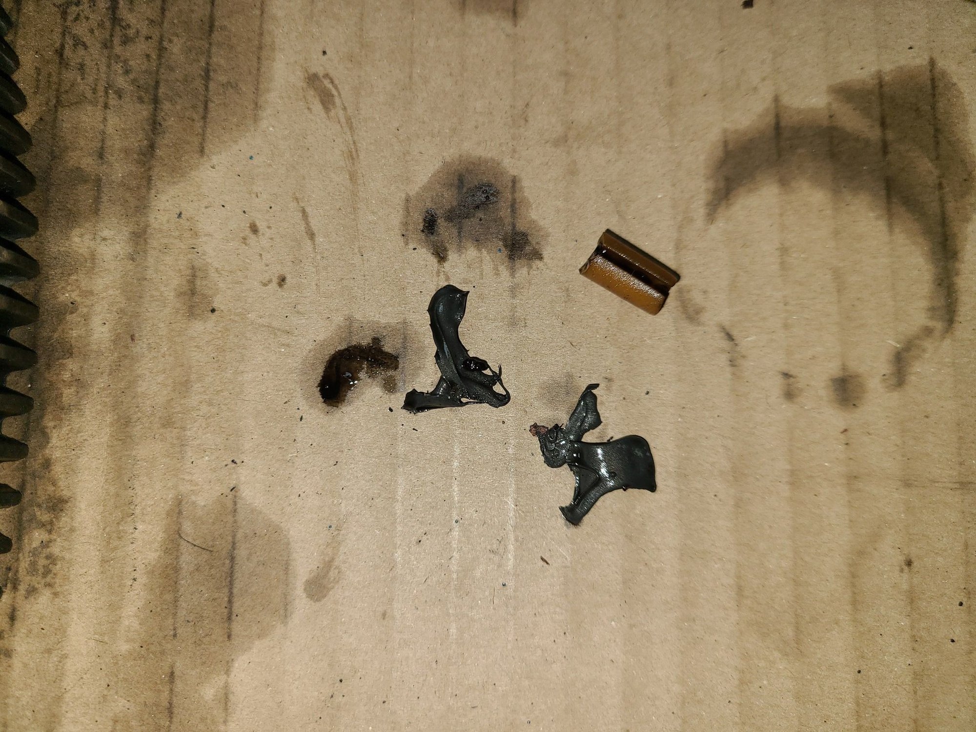

Did you happen to run a magnet through the stuff in the bottom of the pan? Cam/lifter wear forms an iron paste or blackish metal sludge that not only can run through the engine some but collects in the bottom of the pan. I would certainly pop some main caps off and look for any signs of wear, oil pump too... I run magnetic drain plugs to check for signs of it.

I shook this out of the oil pump pickup screen housing then tossed in the towel on this engine.

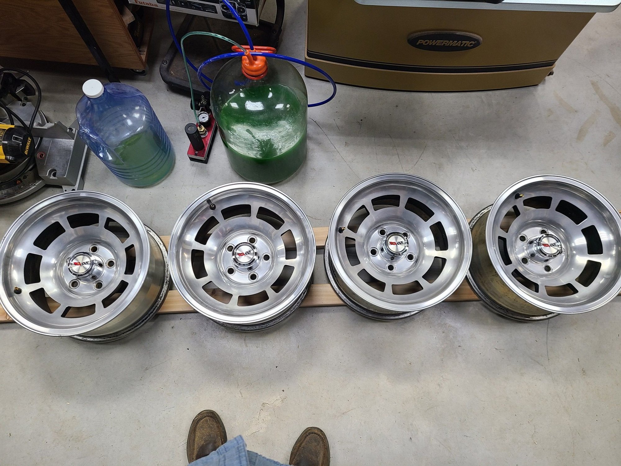

Speaking of wheels @1860army thanks for the heads up on the wheels they came in the other day.
The only thing wrong is the center caps are not clocked to the valve stem LOL.
JT
My pleasure JT, it's always a pleasure helping someone else spend their money...LOL... The wheels look in great shape, someday when I find some money I don't like I might get a set of those rallys, paint the wheels black, mount some blackwall tires and kind of murder out my car-when I get to it... And congrats on the new motor.. Now that you have doubled your HP there are a few other things to con$ider... Higher stall TC and how to lock it, plus proper TV cable geometry for your carb. You can wait on the trans but GM beefed it up a few years after your build and you might consider it with your stronger motor- I did it because I wanted a different TC and my pump had a leak, got to watch the guy do it, fascinating how these things work...

This is rtv silicone right? if so kinda normal. The spark plug thread protector is a weird find. I agree with the others that some of your cam lob wear looked pretty sketchy.
