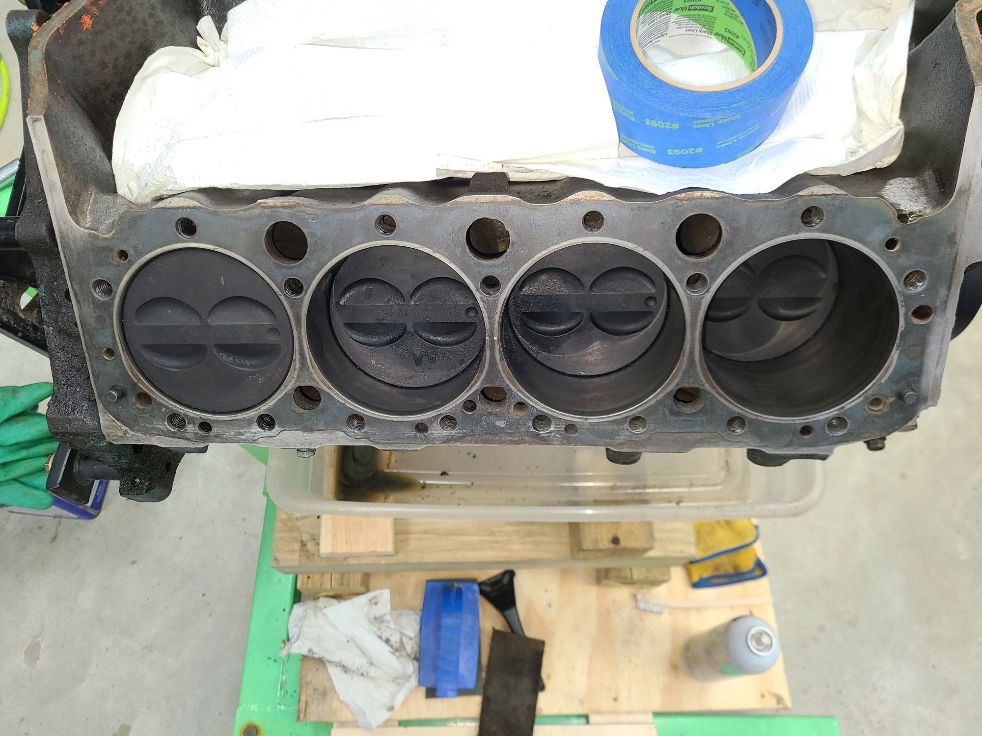

I would advise the hard stone hone. You can see if the bores are straight and where the low spots are. You need only remove what you must remove based on the witness marks. The ball hone will rough up a smooth bore for new rings but if the taper is excessive, you will never know about it.
The old heads would go right in the trash IMO. The original heads will need a full valve job and they do not improve anything. They were crack prone even when new. I had one replaced with a later casting date on my '80 before I got the car with just 43K on the odometer. Get an estimate from the machinist to do the valve job before you make the decision. New heads will look pretty good from a cost and performance perspective.

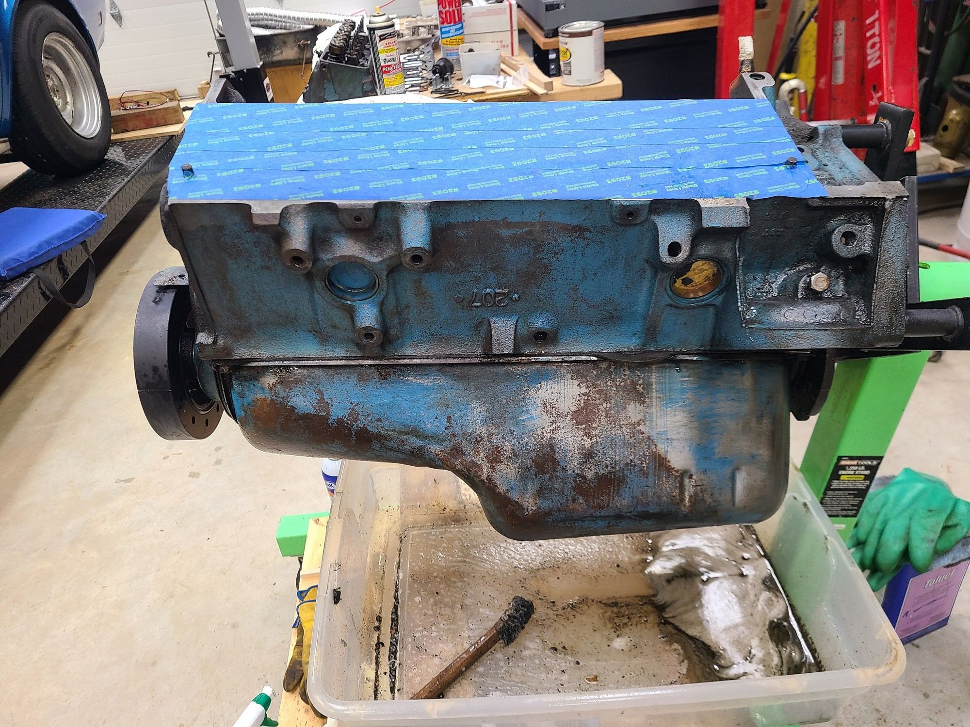

Yeah, I guess I got a bit disgusted with how dirty the outside of the block was yesterday trying to clean it. Going to try and clean it with something different today. The oil pan I can blast the outside to bare metal in my blast cabinet and prime and paint it to look like new.
JT
Try "Purple Power", it is an excellent degreaser.

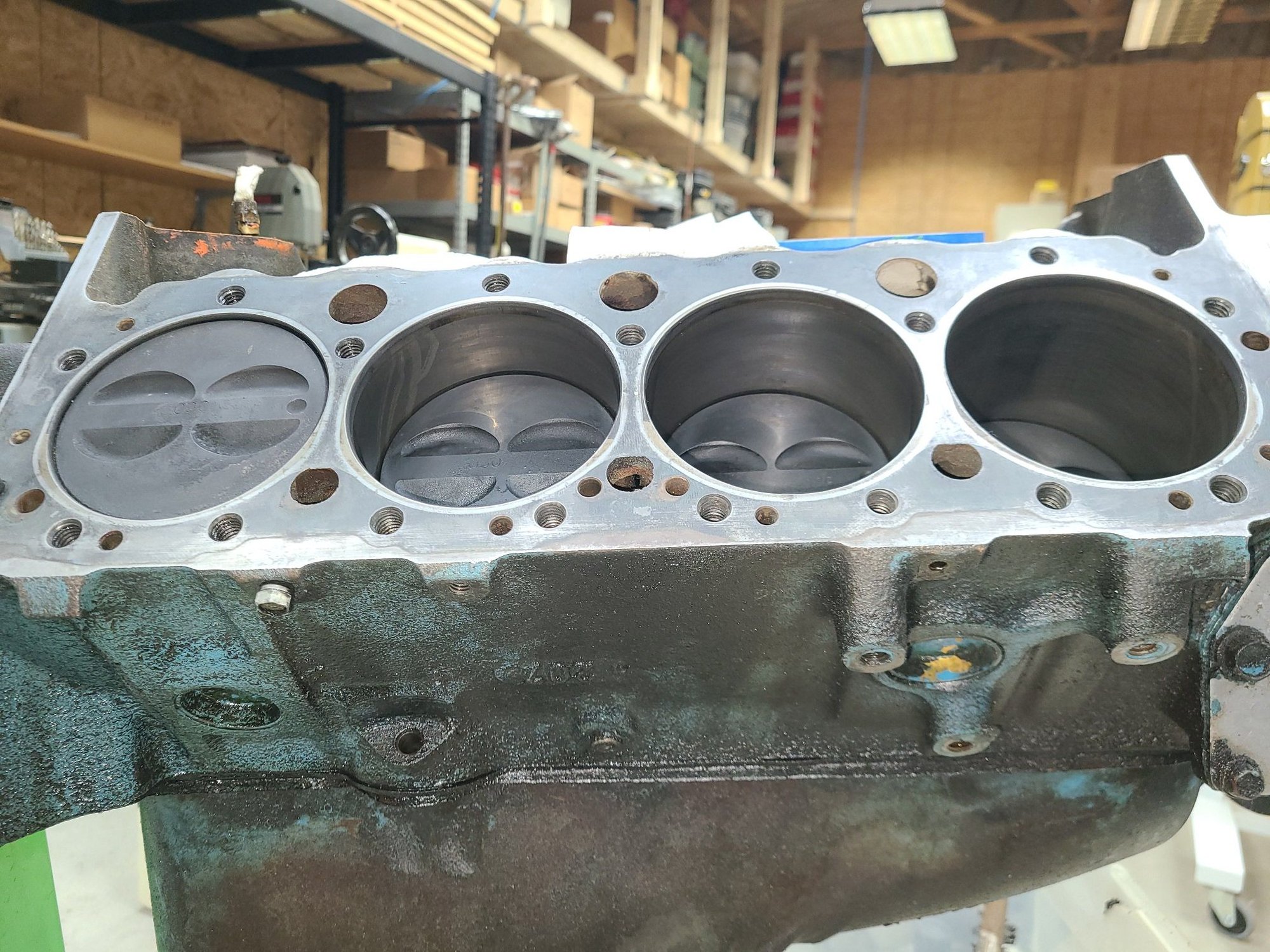

Yeah, I don't want to dump a lot of money in the L83 block. I can still see the cross hatch from the honing and can't measure any taper in the bore but a set of bearings and check the ring gap is a good idea... hopefully Bubba didn't rebuild the short block.
good point I prefer the stone hone also but the dingle ball version is the one that always seems to be the fav here which was why I had mentioned it.

Ok, I'm feeling better about getting the outside of the block clean. I'll just take my time and get it clean then take the oil pan, harmonic balancer and timing chain cover off and take a peek inside.

If it was mine, I would pull all the core plugs out and remove all the pipe plugs too. Then run a thread chaser thru ALL the block threads. You want to clean all the threads before you take it to the shop. Makes your job easier when it comes back.

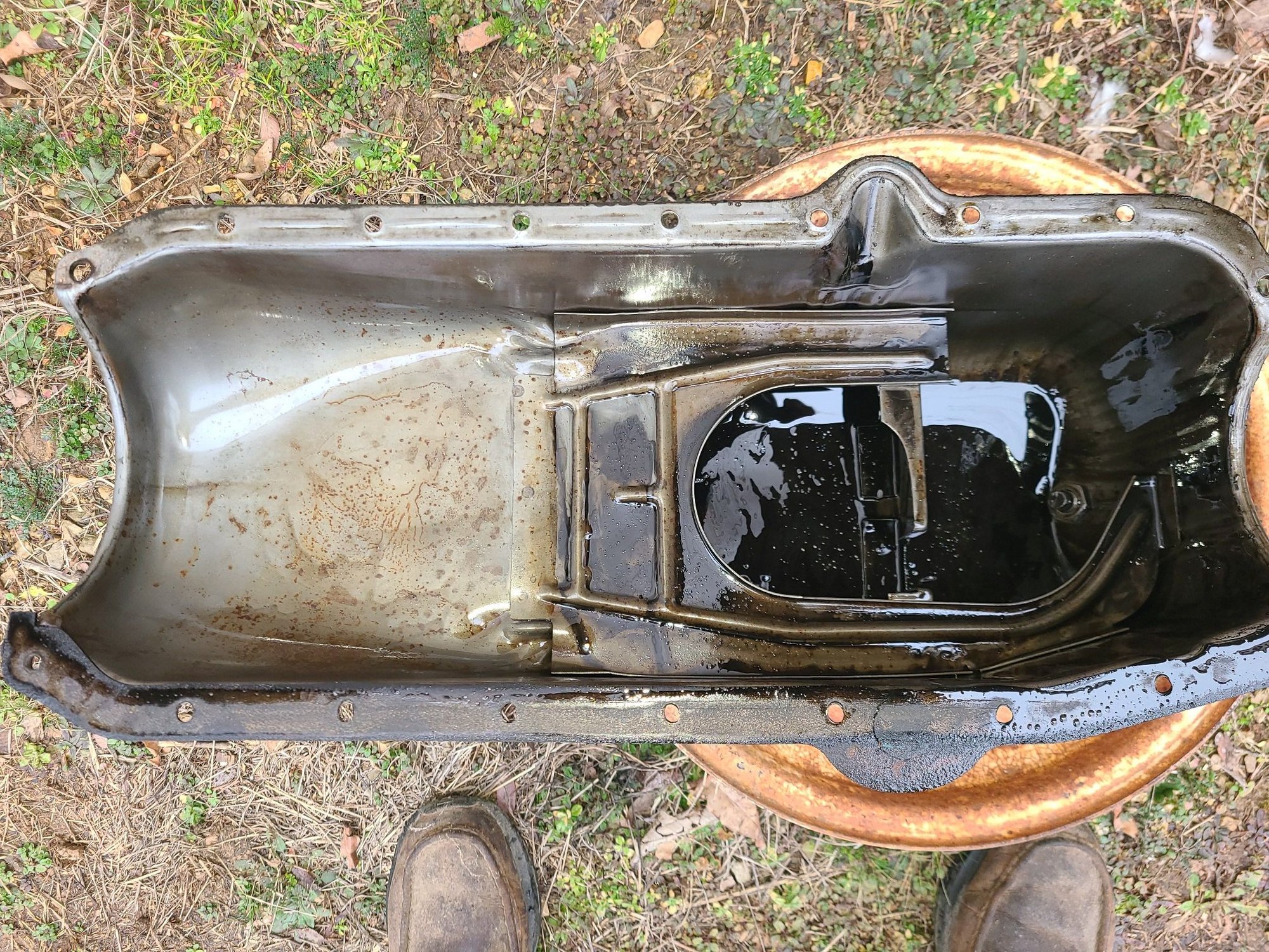

I was surprised at how much oil was still in the engine after letting it drain for two days, more than a cup full came out when I rolled it over. Then I had to roll it back upright to empty the oil in #7 piston and I'm letting it drain for a while.
The oil pan bolts were not tight at all and not even the correct type (socket head cap screws) so no wonder it leaked. The bottom of the oil pan has some black goo in it, that could be the reason the oil went black so quick.
I need to clean my shoes it seems...

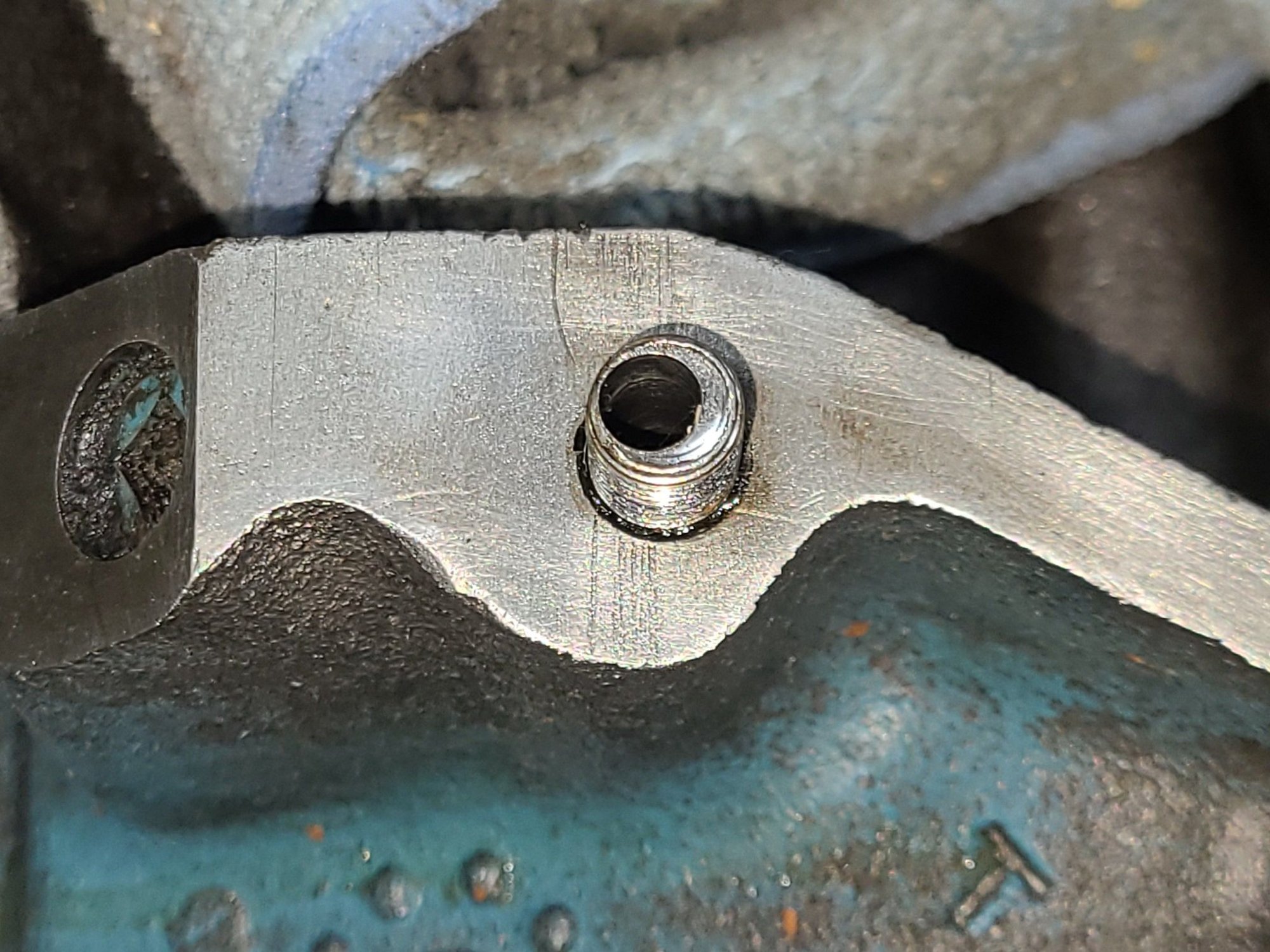

And last photo for today is the oil pressure nipple, is that a pipe thread? Does it screw out? I don't like the looks of that one with the hole way off center.
JT

The chain does have slack but any chain is going to have slack after some time. Yours isn't terrible but you going to replace it anyway.
Oil pan, I've seen worse.
Yes, it should be a pipe thread. Run pipe tap through it loaded with grease to catch shavings to clean it up.
JT
O-M-G....get that OUTA THERE....
JT
? Is there a short windage tray attached via main cap bolts ?
That oil gallery, with the wonky nipple, pretty sure that's the gallery with the 'hidden plug' located about an inch or so up, from Bottom of that hole.
First --- Measure WHERE it is located; Both from top AND from bottom.
Then, To remove 'hidden plug':
Remove #5 cap.
Remove wonky nipple
From top: insert rod (about 2 ft long) into top
drive 'hidden plug' out bottom
after thorough block cleaning, drive 'hidden plug' into position From Bottom.
That looks a lot like a GM-aftermarket replacement double row timing set; and budget-grade as well. 58 links = small pitch (perhaps roller OD about 0.222" as well). No need for (monkey see-monkey do) a double row anyway. And, a larger pitch double row will likely require grinding-clearancing behind/around chain. Suggest a Quality, Large pitch, Heavy-Duty (46 links), Single Row chain with seamless aka solid rollers. Good uns' rollers have about 0.333" OD. No block grinding either. Part numbers upon request.
Select tapered thread oil fittings with a jaundiced eye; some are relatively weak pot/white metal castings.

Educate me on timing chains.
I'll be out of town today so I'll look tomorrow for the hidden plug when I get the wonky close nipple out.
JT
