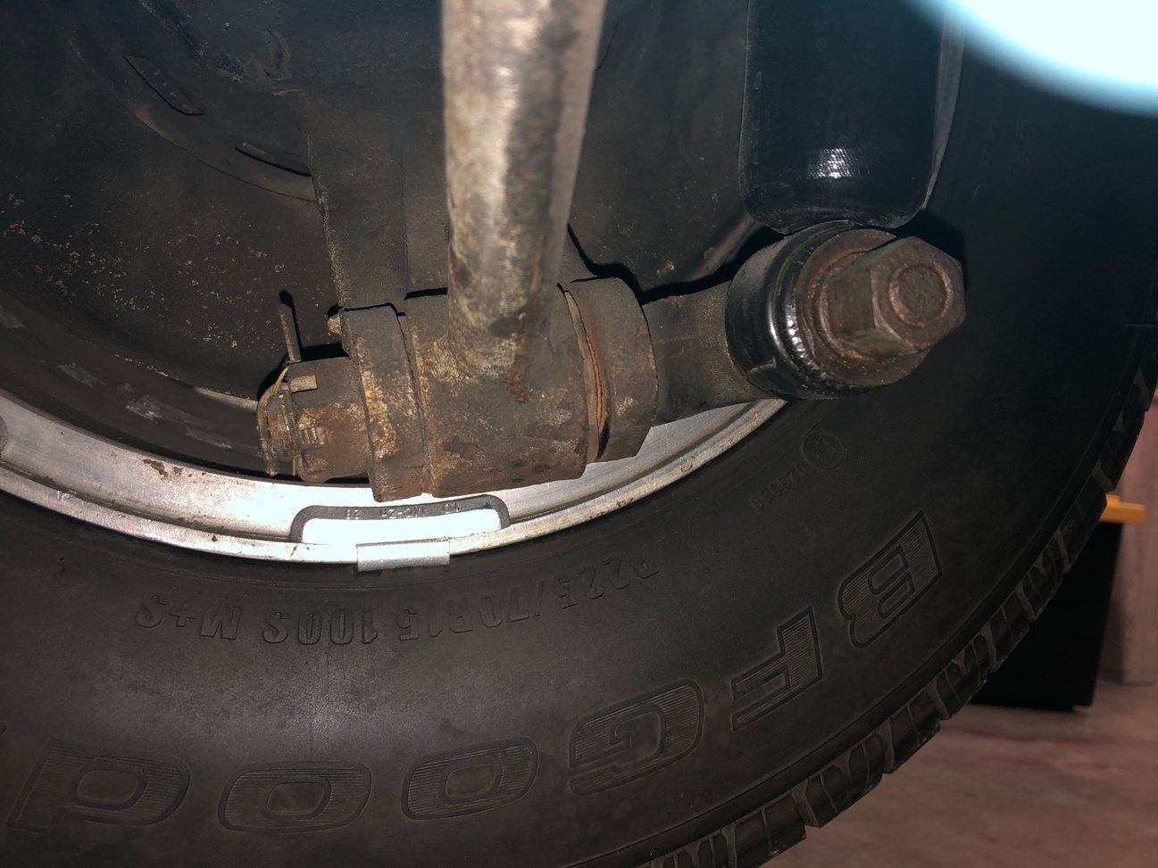

I started back working on my corvette, and I noticed that the rear wheels are laying out at the bottom. Anyone have an idea of what could be causing this?And just how expensive should it cost to fix? The right side, the bottom is sticking out 3/4 of an inch more than the top and the left side is bottom is 1.25 inches out versus the top.

Sounds like you have excessive negative camber. The strut rods adjust this via an eccentric at their inner mounting point. You should be able to get under the car (on a lift or jackstands) and loosen the eccentric nut then turning the eccentric bolt so that the strut rod is pulled inward. Some cars will have aftermarket strut rods with adjustments on the rods themselves; if you have those you can adjust them like you'd adjust a tie rod end.
While you're at it, check for excessive play in the suspension. While the car is in the air, see if you can move the wheels in-out or side-to-side. There should be very little play.
The problem you have could be as simple as an adjustment or as major as needing a full suspension rebuild. Start with the easy stuff first, though.

1- Check camber
2-Inspect the bushings, all of them
3- Check the inner axle endplay- common issue
4 -Check the outer axle bearing play
If the car was maintained over the years, has a correctly built differential, good outer axles, it can be simply loose strut rod bolts or worn bushings. If the car is an original one, never touched look for those things mentioned. If the car was worked on by hacks, many out there today and since the time I put a wrench on a vette- 1978, then you may be for a whole new experience. If you do your own work all the better, if you bring it to a common shop, repair work could cost more than the cars value. So it all comes down to you doing your homework carefully.

Wear of the differential stubshafts is the biggest reason you see some alignment shops bend the stock strut rods. Post #6 and post #10.
If your stock strut rods (with good bushings installed) can't be adjusted in far enough to get the camber back to stock then you can bet the stubshafts are worn excessively.
Also a sagging/worn rear spring will cause the ride height to be lower in the back resulting in excess negative camber. Post a side view shot of the car if possible and one from the rear.
The use of heim jointed strut rods can usually get your camber back to stock but if your main issue is the fact the stubshafts are wearing then unfortunately, at some point in the future, the stubshafts could start wearing into the side of the differential.

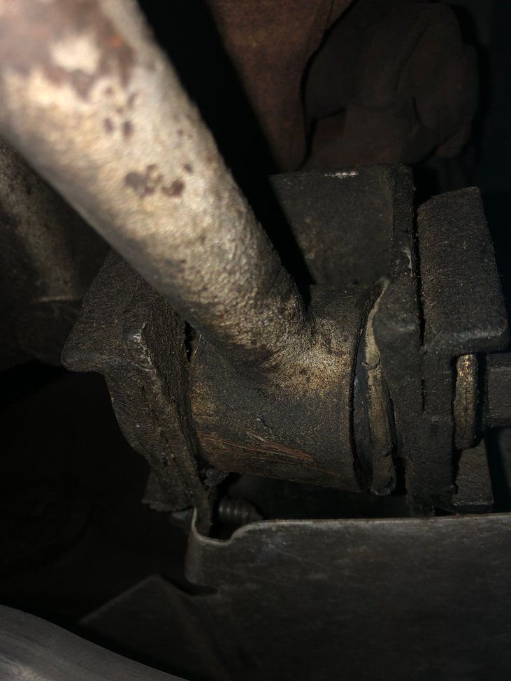

can you take lots of pics or videos in regards to what folks are saying?
here's a few subjects discussed.
