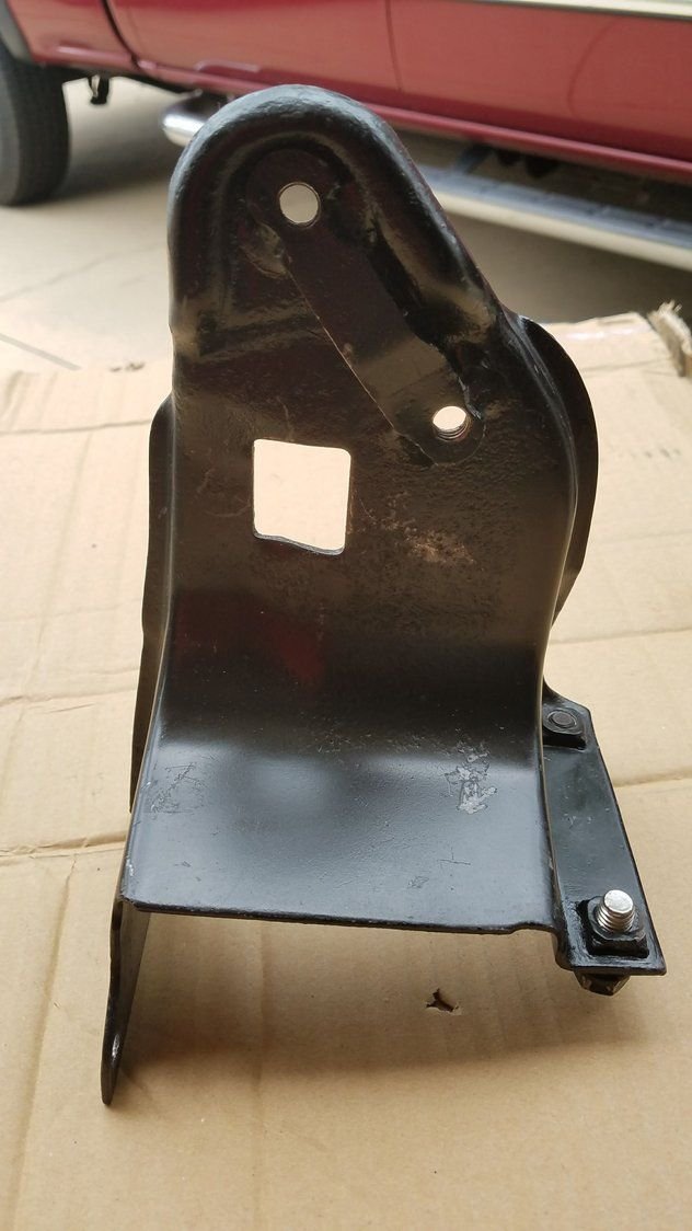

When my shifter went wonky, it was the threaded holes in the shifter mounting bracket. They had stripped as they aren't nuts, they are just threaded into the 1/8 thick bracket material.
I welded actual nuts to the bracket and now everything is nice and tight.
Notice the threaded holes in the bracket image I found, they strip easily.

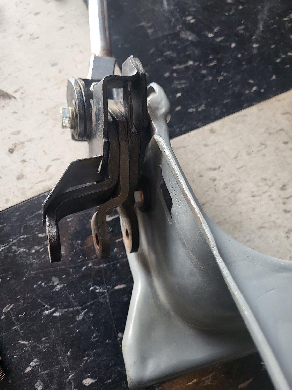

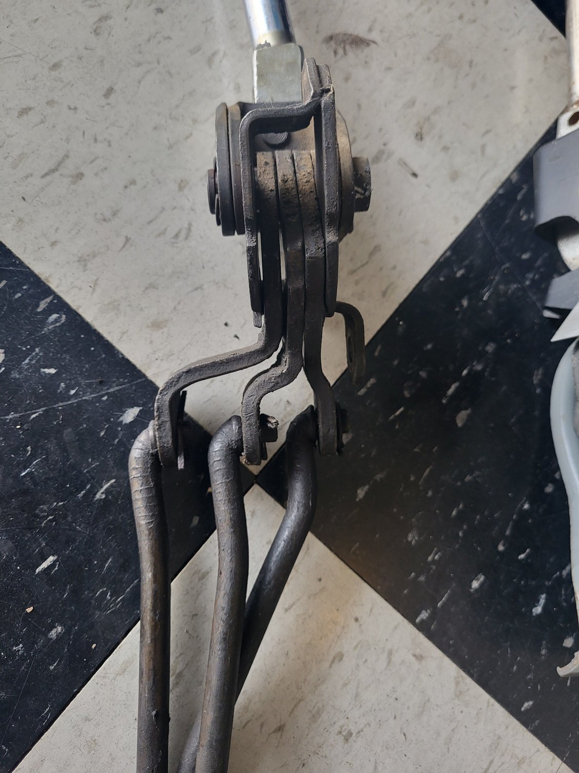

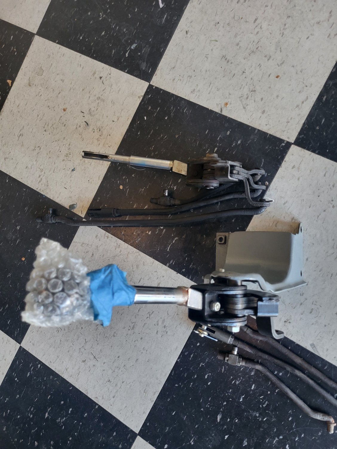

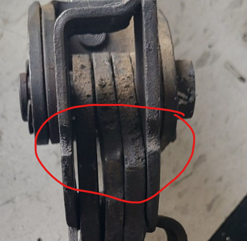

Just an update... I removed my old shifter, pretty straight forward 2 hour job all in, taking it out I could definitely see it was loose and sloppy with lots of play and space between the gates.
I got fortunate looking on offer up and found a 72 shifter assembly advertised as "rebuilt" I went and looked at it and tight as can be... got it for $100
I will install the new one tomorrow.

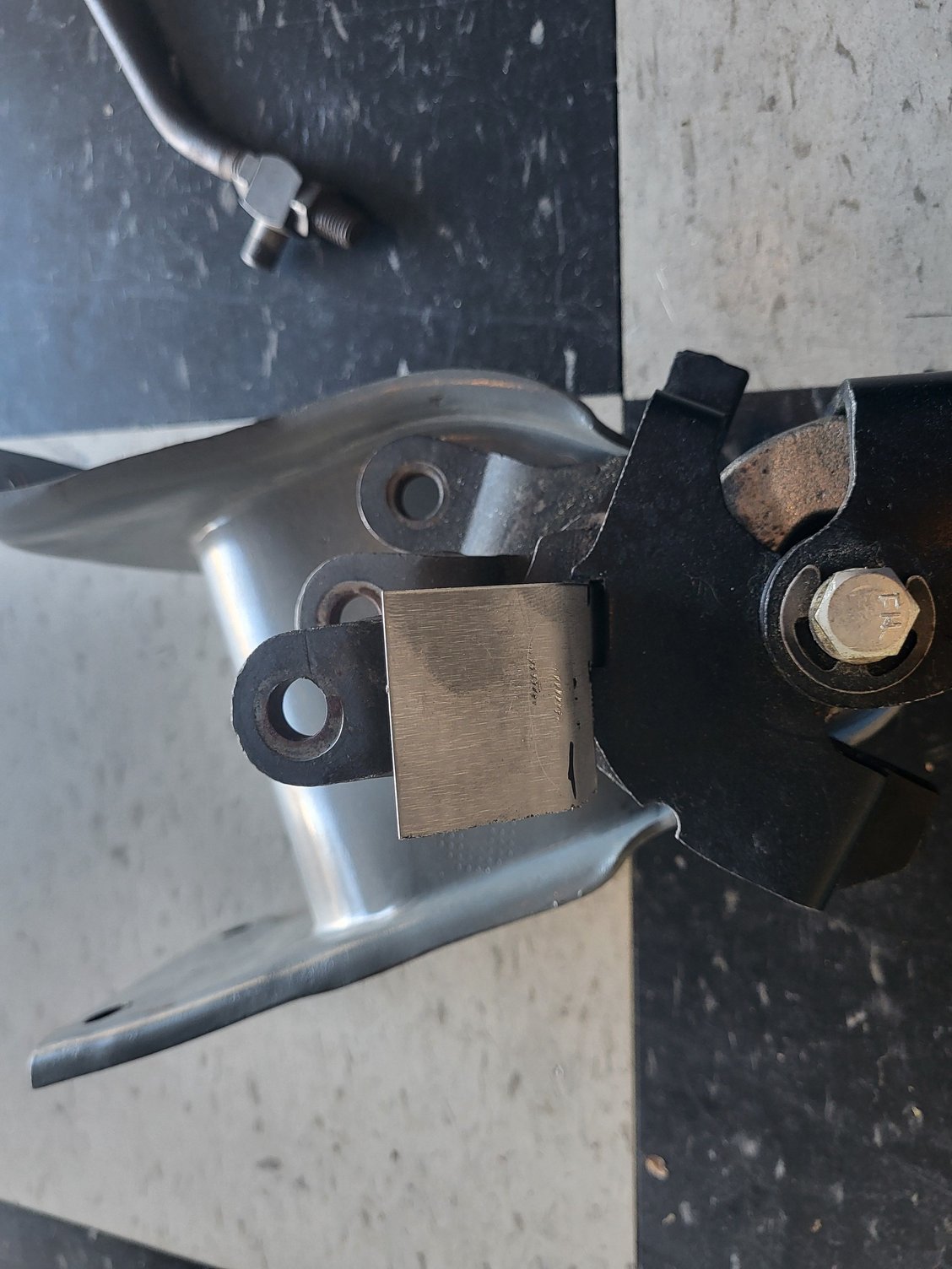

Quick question... I made a gauge for lining up the gates... the linkage holes do not line up correct?

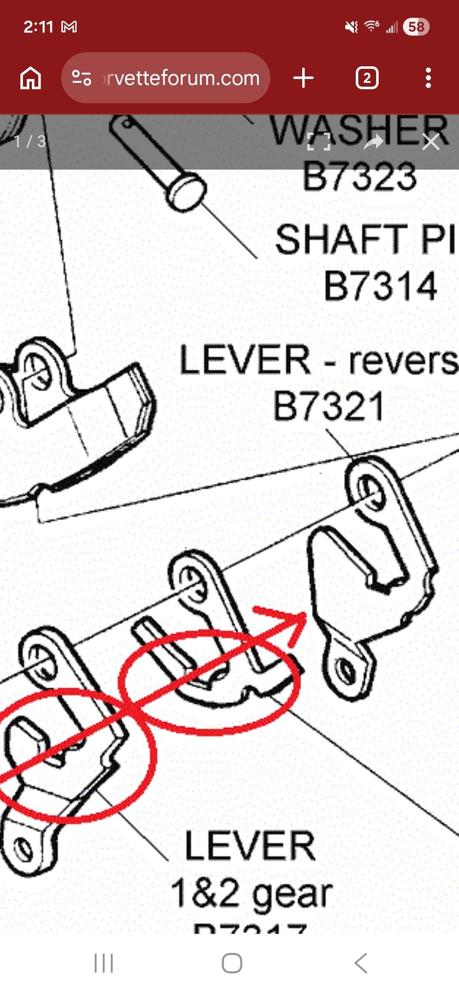

Look at the diagram in this link to make sure all 4 levers were reinstalled correctly and none are reversed.
Shifter
Shifter
thanks for sending me that... the levers are all correct to that diagram and interesting enough now that im looking at that compared to this new one and old one... my old shifter doesn't have the reverse lock out spacer plate between the reverse lever and the 1st/2nd gear lever
The guage does go through all and locks all levers together as well as in place
Thanks for all the help everyone, had dirty cloths on so just went ahead and installed the new shifter... I put some paint stripes across the bottom of the gates and housing with the gauge in so made it easy to line up and put the gauge back in after the install. I will attach the rods to the trans levers tomorrow but got them pretty close to lined up... couple small adjustments.

These notches pretty much line up when the gauge is installed. Good visual indication when lying on your back.
And just looking at your picture it appears that two of the plate looks bent to me.
