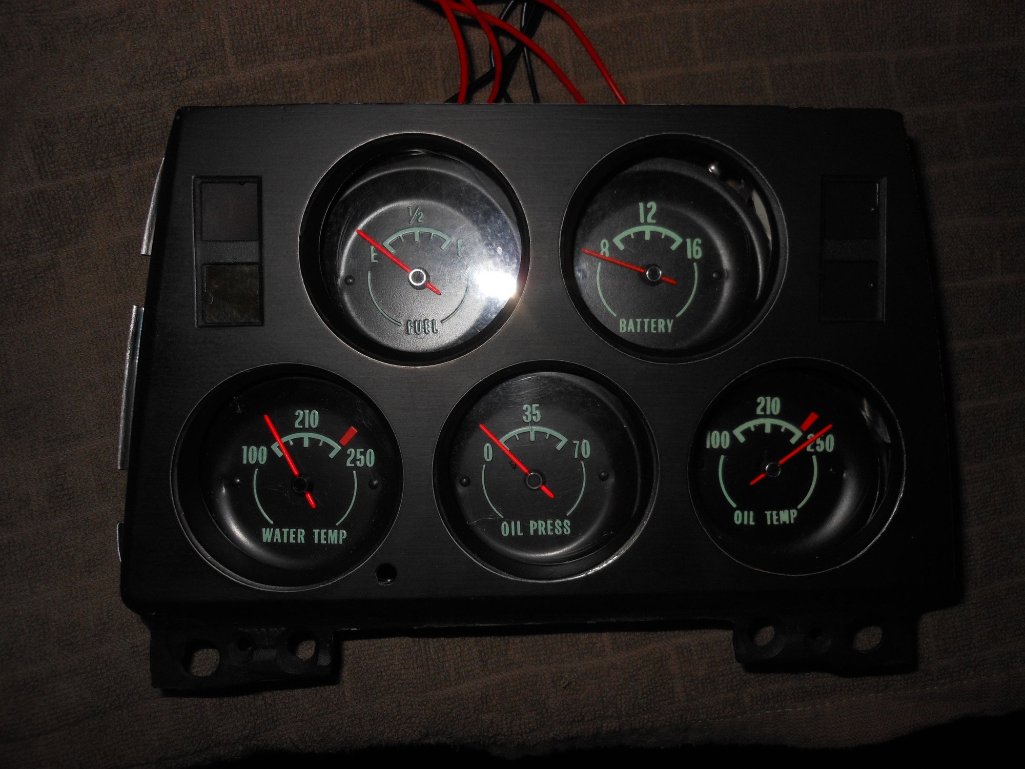

Yep. And they make one with the green numerals for 68-71 so it will look factory.

Anyway, ditch the clock. replace it with a voltmeter and keep the ammeter. I like to know which way the electrons are flowing.
BTW, the ammeter is a bit of a wiring trick that one needs to know about when adding big power hogs like electric fans. In that case it may be simpler to change it to a voltmeter. Just a bit of an aside!.

Voltmeter!!! I ditched the clock but went with a Oil temp
