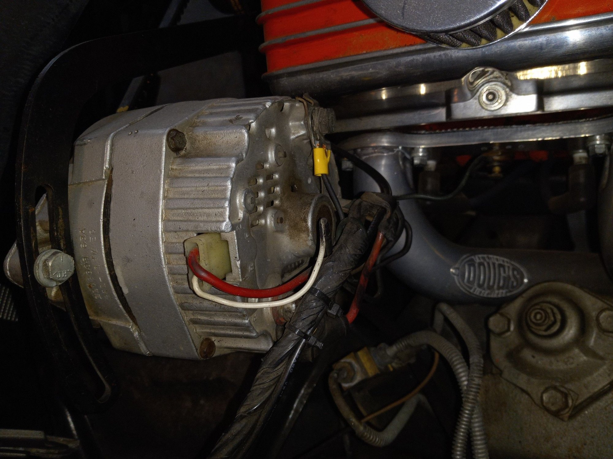

I have a 1973 coupe, L48, 4-speed. When I purchased it about 10 yrs ago, it was basically stock, but wasn't numbers matching, so I decided to do some upgrades to make it the car I dreamed of in high school. I started with side pipes!
Anyway, a lot of new things have come along since high school, so I added F.A.S.T EFI, electric fuel pump, electric fans, and electric headlights. It also had Vintage Air installed before I purchased it. Just for info, I had a shop install all those things because I'm not very knowledgeable when it comes to auto electrical! (This shop messed me over really bad and I didn't know it until it was too late! They charged me $200 for a 130 amp alternator, which I never got! I really don't know what else I was charged for but never got. I'm learning about the car and checking things as I learn!)
That is really all the upgrades I ever intend to do. I have no interest in some fancy sound system.
But with those upgrades, I figure I need a better alternator. According to my research, my car came with the alternator installed on the passenger side and the A/C compressor on the driver's side; but I'm assuming the PO moved the alternator to the driver's side because he installed Vintage Air, and the A/C compressor is now on the passenger side.

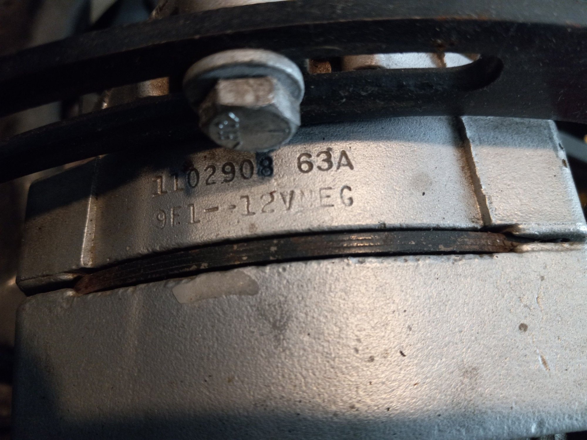

I'm providing this info so I hope you'll have what you need to help me! I'm a dummy when it comes to anything electrical, and auto electrical totally confuses me...and I'd like to upgrade my alternator to a 100 to 120 amp.
As I said, the alternator is now on the drivers side. It's apparently a Delco-Remy, 63A, internally regulated, #1102908 used in late 70's Corvettes.
I'd like to be able to replace it with a decent alternator that's very close to the same setup, preferably unbolt the old and put in the new; but I doubt that will be possible, so as close to "plug and play" as I can get and still have a good higher amp alternator. So I'd like your thoughts on what alternator you think would be the best and easiest to replace it with.
Any help presented in really easy to understand terms would be much appreciated! I'd also appreciate any guidance on wire upgrades during/after the install. I've read about the "Big 3" upgrade until I'm blue in the face, and I'm more confused about it now than when I first started reading about it!
Thanks in advance to anyone who responds!

You can switch that out with an updated alternator easily putting out 120 amps. There is some wiring upgrades that must be made. I would go to Mad Electric and read their papers on upgrading. They also sell inexpensive wiring and relay kits. Good luck. Jerry

Don't know where you did your research but all C3's had the alternator on the Driver's side and AC compressor on the passenger side.
Have you considered testing the actual alternator output in case the guts have been changed and the stamp is meaningless?

nohurry
Your 73 is probably quite similar to my 68. I first converted it to a 12si 94-amp alternator but there is no benefit to going for the intermediate step.
For either one of these solutions you SHOULD upgrade the lead going from your Horn Relay Bus Bar to the Starter Post with AT LEAST a 6 gauge lead. It's short run from horn relay to the starter post. To keep it simple you can use a 10-gauge Fusible Link for protection. I picked one up a 6-gauge lead at the local boneyard that came with a fusible link....not that it's a big deal either way to solder one on.
ANYWAY-- as far as alternators:
SINCE you want to keep it simple I would recommend going with a 140-amp CS-144. That way all you need is an adapter with the proper resistance to hook up your supposedly 12si-equivalent connector.
IF you want to make it even better then I would recommend a 145-160 amp DR44G..... and all you need is PWM controller (about 20-30 bucks) but you need to do a little wiring.
I also have F.A.S.T EZ-EFI 2.0, electric fuel pump, electric fan, and A/C...... since you are quite similar to me you DO need more than 63 measly amps.
If you are interested in either of those I can share links for doing one or the other.
also---alternator should be on the driver side.

As far as alt being on pass side, I got that through an AI search....figures the info would be wrong! I thought there might be something changed since the number on the alt isn't listed as being installed in the '73's.

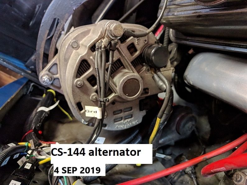

I would suggest picking one up at a boneyard but just the way you describe your experience with electrical you're probably better off buying something from a store. IF you are willing to go to the boneyard the selection should be quite wide nowadays.
You want to get a cs-144 with the mounting tabs 180° apart with the electricals connections hopefully away from the exhaust.
You can even get one of the 3-legged goofball from transverse engine GMs and mount it--- that's what I picked up just to see if the body would fit in the alternator mount..... then I got it tested and it turned to be in great shape. Those were in a TON of vehicles... you just need to ensure you are getting a CS-144, 140-amp.
If you go to the boneyard then pick the best looking newiest one you see. I would look anyway... especially if you're going to go the boneyard to pick up six feet of 6-gauge lead with a 10-gauge-fusible- link pre-attached (or metric equivalent) just about every newer car should have something like that..... or move on to the next one.
From what you describe I reckon a CS-144 would be your better option to make it as "plug and play" as possible. I really do think the DR44G would be a better option but would require more fabrication.
Here is a link with info for the connector you need to hook up the CS-144.
BUT --- let's ask: Does the 73 have an ammeter? Does the 73 have a "batt" light? If it has an ammeter and does NOT have a "batt" light then the adapter I mention is more than likely correct. If you want to do more ohmeter checks then I can send you a link to verify that but other than that it should work with this:
https://www.corvetteforum.com/forums...lternator.html
You will need to swap over the v-belt pulley but that's no biggie.

nohurry
here is a picture of the CS-144 before I replaced it with a DR44G. Note the location of wiring. Plenty of room.

FWIW-The CS144 in my previous post fits ALL THE OEM BRACKETS for the 12SI alternator and is superior, by far, to the 12SI OEM alternator, regardless of amps. AS mentioned, again, high output 12SI alternators will struggle at Idle with providing higher amperage AND will run MUCH hotter than a 140 amp CS144 which provides 80-90 amps at idle, barely breathing.
Lastly, just buy a "welders" 4 GA EXTREMELY FLEXIBLE cable to run the to the starter:
Amazon: What ever length you need!
4 AWG Gauge Fully Assembled Battery Cables, 1-15ft Lengths, Positive or Negative Wire, Pure Copper Battery Replacement Cables, Solar Car Truck RV Camper (8ft - 5/16” Lugs, Single Red)
https://alternatorparts.com/
Call them^^^^they will clock it for you and get you the small diode easy to connect with the current wire in line, plug and play.​​​​​​
Do it once, buy the Cs144 140 amp standard amperage alternator..all you will ever need and the last alternator you will buy.
