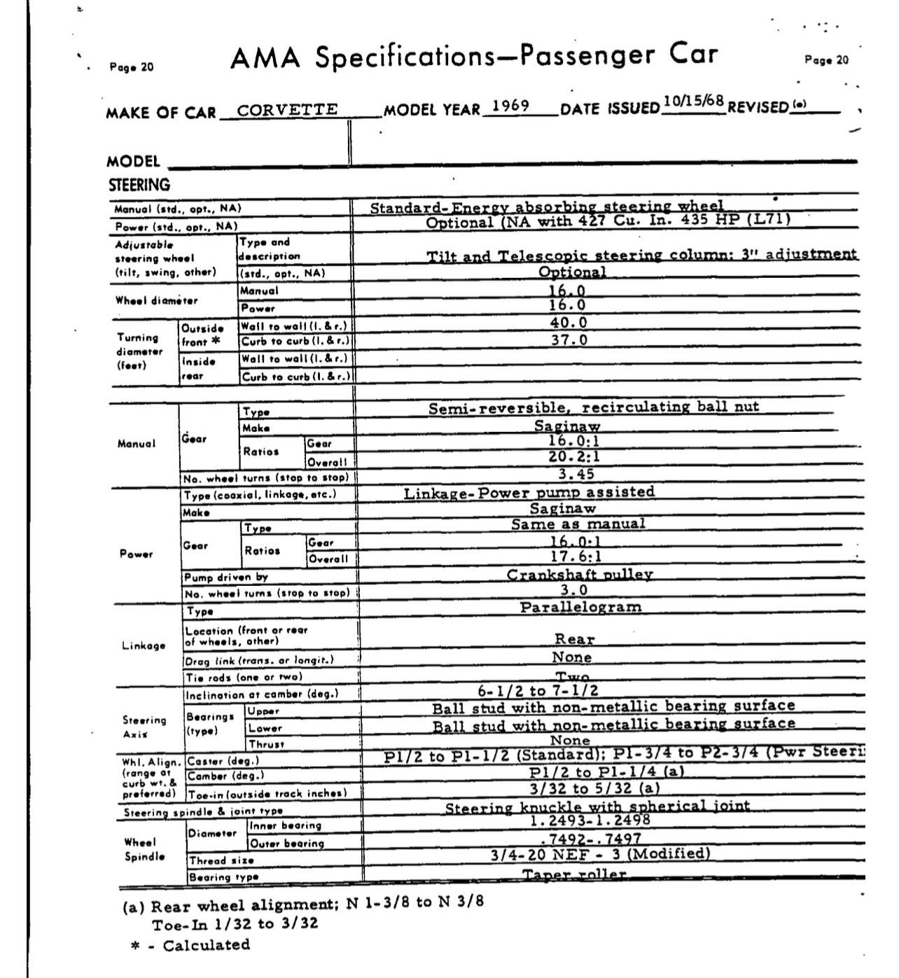

My car was a factory non PS car and I installed the tie rods back in to the fast holes when I re did the front suspension. It didn't make it that much harder to drive at slow speeds but it was more fun to drive at regular speeds. Now that I have done the Borgeson conversion it turns right NOW.
I'm truly curious about this…
Can you enlighten me on the Borgeson conversion?
Specs / parts research both show Borgeson and Saginaw at 16:1 (stock ratio for non-P/S).
I’ve got a Saginaw box and was considering a rebuild. But if there’s a clear advantage to the Borgeson, I’d put that on the “considerations list”.
Thanks for the input on tie rod location - I had a feeling it wasn’t as extreme as I suspected. You make a strong case for 2-hole, and I can experiment with the feel.

Borgeson set up is a direct power steering versus the power assisted steering as when compared to a C3 and a lot Ford cars of 60's vintage. IMO, a less complicated set up as the power steering is the gear box itself rather than a ram assisted set up.
Aha! Now I can see what the conversion means from digging into my searches.
Correct me if I’m wrong, but I'd still need:
  • P/S brackets
  • Reservoir / Pump & Pulley
  • Add’l 3rd track pulley for the Crank (?)
  • Belt
  • and some of the kits come with hoses, pump, brackets (?), etc… for install
And then there’s the rag-joint / coupler + ‘collapsing the column’ portion of the install [if I read that correctly, here on the forum - sorry, no link at the moment].
So it’s a bit more than I initially thought …or is it?
I'm not opposed to keeping the manual-steer for now, so the Borgeson sounds like a nice upgrade plan in the future.
If (IF) I did decide to go that route…
Has anyone done that upgrade WITH a hydroboost system, too?
We're getting into strange (but curious) territory here…
And I’m only asking about the hydroboost* bc I’ve seen the vacuum booster conversions and “cut n drill the firewall” is not in my plans.
*Hydratech makes kits for non-power/brakes that install in the stock location; I’ve already talked to them, and am considering that …in the future.
