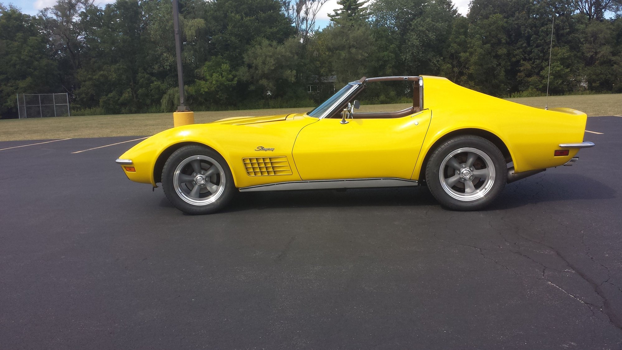

Give Eaton Detroit Spring a call. They will make the spring to your desired ride height. Stock, lower 1", 1 1/2", or 2" or higher than stock in the same increments.

You’ve a beautiful Vette, and the front wheel gap looks great. I’m fine with cutting 1/2-coil if I have to, but I was hoping to avoid that.
