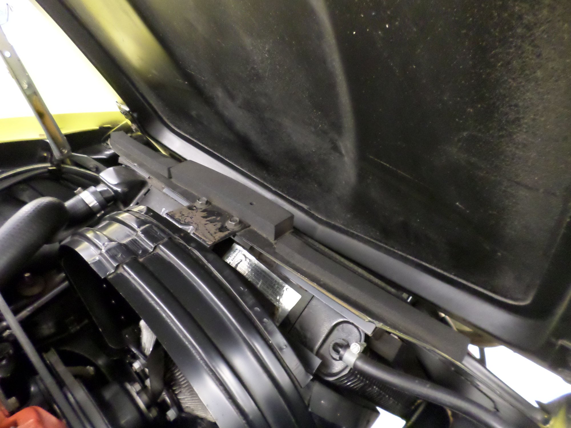

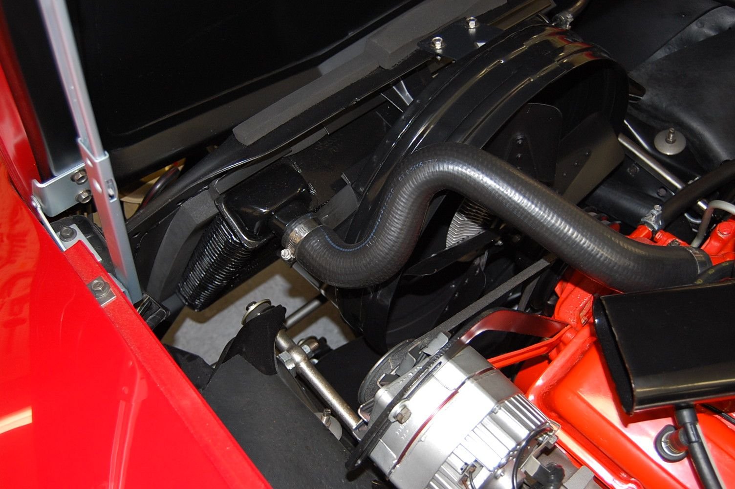

This answer your question?

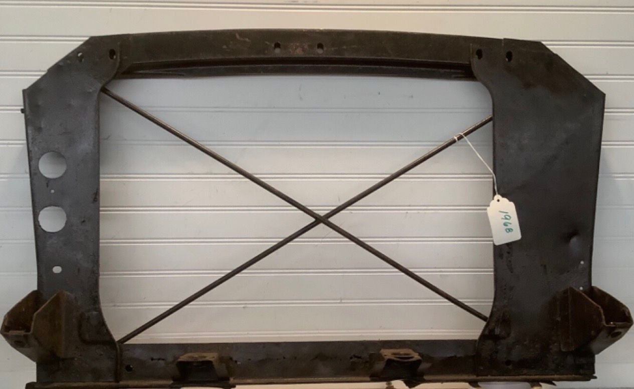

68 small block, no AC
Support

Hello,
I agree with MW and 69L
The support is typically flat.
The base engine, 4-speed, no a/c car's RADIATOR is FLAT across it's width and height
It fits snuggly against the radiator support.
The metal fan shroud is flat too.
Regards.....

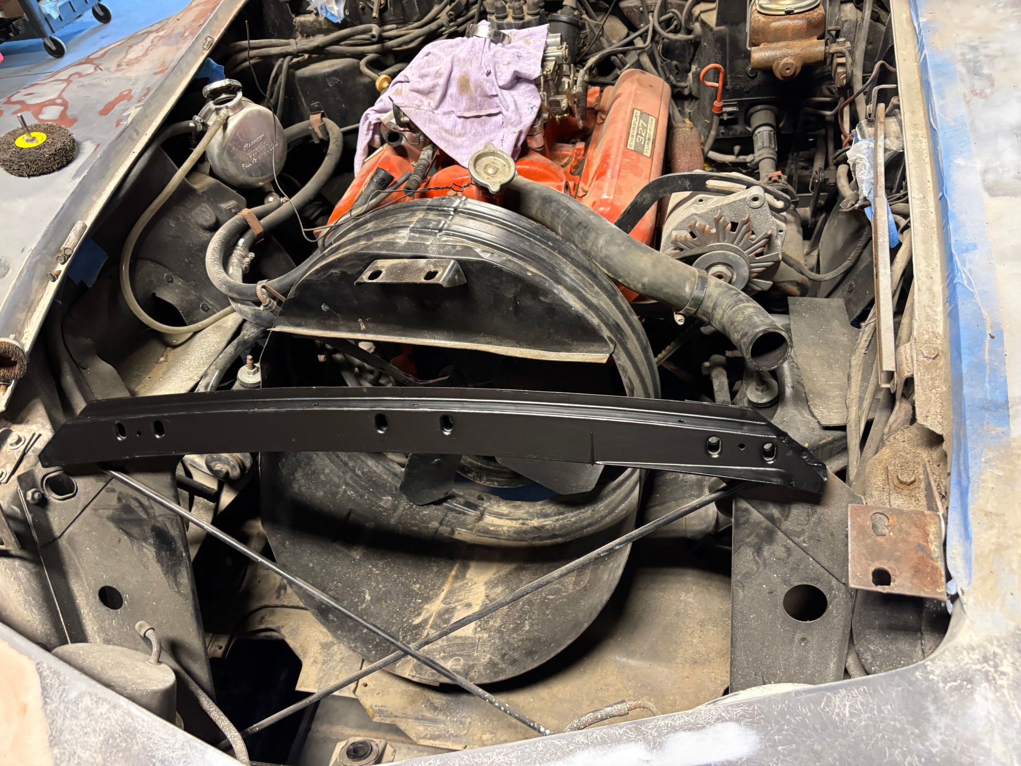

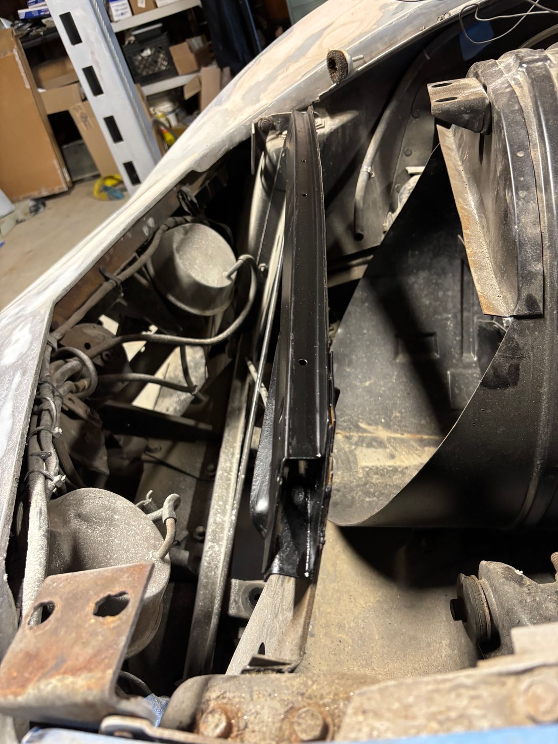

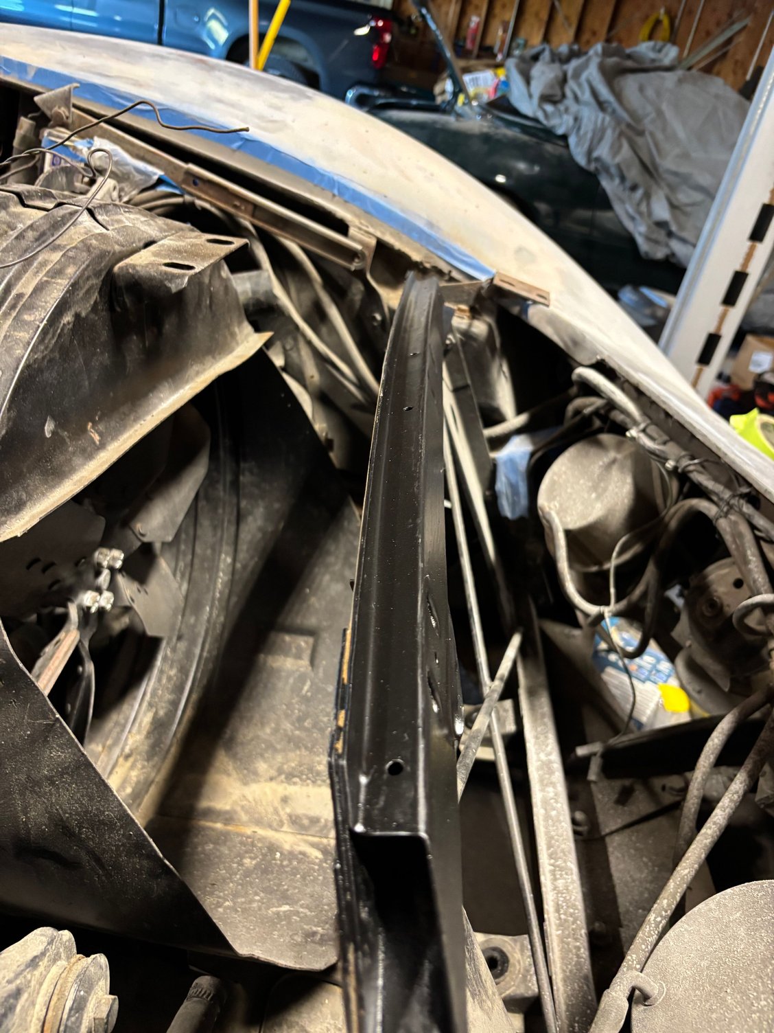

These are the photos I was looking for, I think.
I’ll take a few and post, but it looks like a bit of straightening is in my future.
radiator is already out, so removal of the brace should be a bit easier.

great news for me. I took a better look when I was going to take photos and found that the support is straight after all. I guess that the curvature at the top gave me an optical illusion combined with the backward lean
thanks to for the help.
of the radiator.
