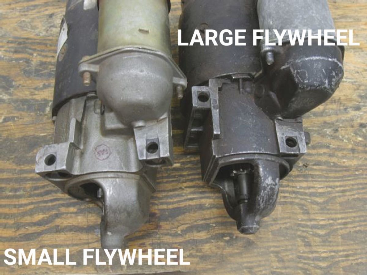

Staggered pattern vs inline pattern.
Staggered pattern for big flywheel vs inline pattern for small flywheel.

Thx again Stingr, my L48 has the large flywheel.

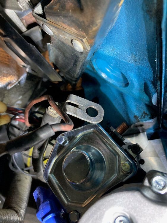

Pictured starter looks as though it may be a Hitachi-style Denso-style with main terminal stud On Side of Starter.
PG260 has terminal studs located approximately same configuration as OE 10MT. On End of solenoid.

Originally Posted by Rebelyell
Pictured starter looks as though it may be a Hitachi-style with main terminal stud On Side of Starter.
nice..
wish i knew that when trying mine
https://www.rockauto.com/en/parts/wa...ter+motor,4152

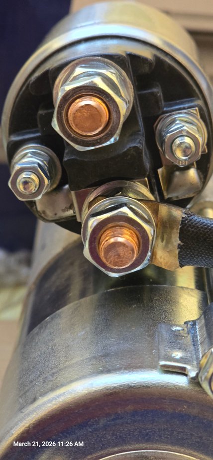

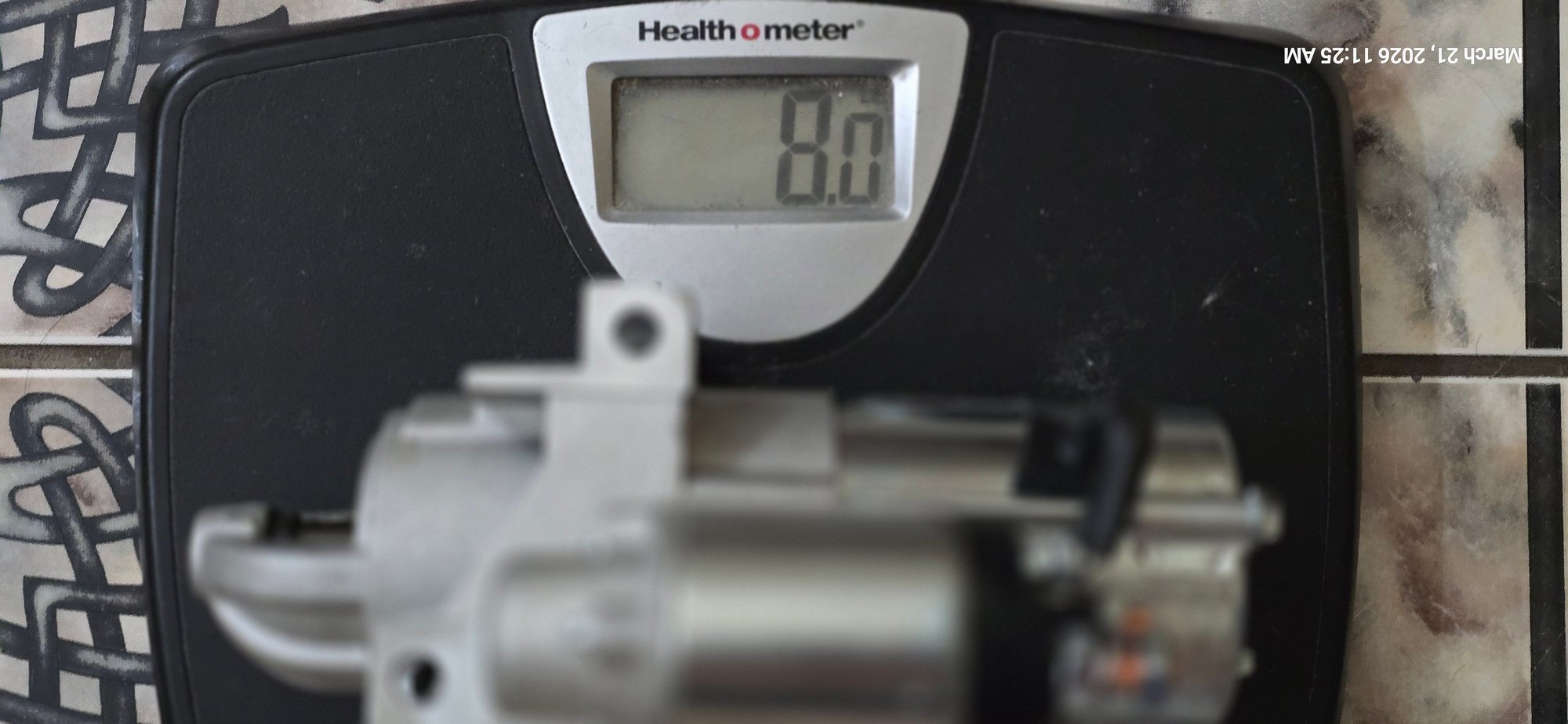

Good news, I just received my new starter from Rock Auto. I also received my new starter wiring harness leading from starter to upper connection. The only problem I see is that connections are not labeled on starter. The big bolt is obviously Battery, the black to ground, the little ring terminal to which side? The right side? Both little terminals have a nut on them and it is lose. Also as you can see the starter weighs a whole 8lbs and it does come with the installation bolts. Super light.

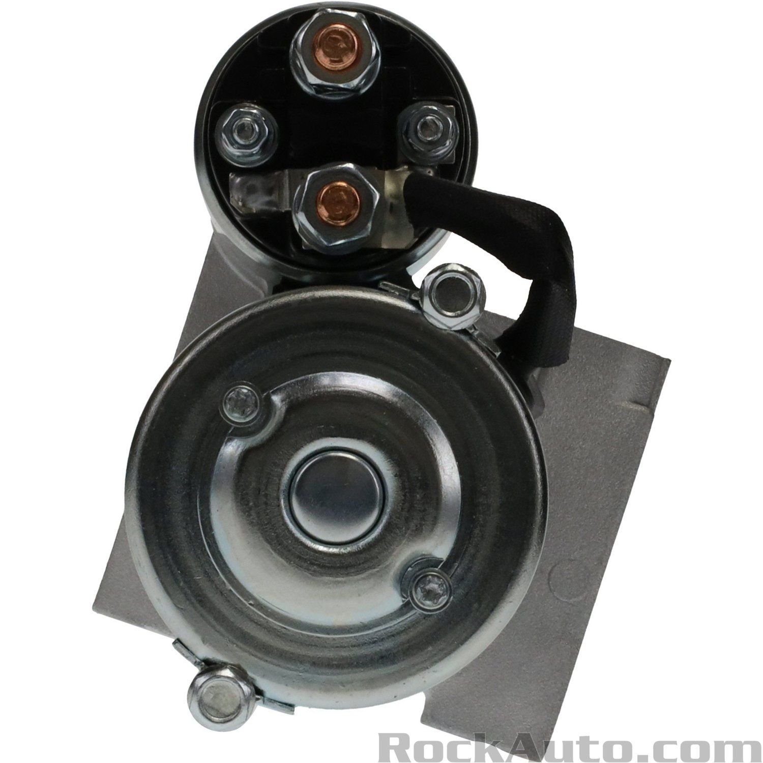

Okay I found this on the internet. Still confused left or right? My guess is mine is the newer style so the right one nearest block.
Old Mar 21, 2026 | 04:16 PM
Rebelyell's Avatar
Rebelyell
Joined: Jun 2025
Posts: 1,713
Likes: 596
Your guess is correct.
older cars and those with points ignition DO use the R terminal.
Newer cars with electronic (aka HEI) ignition Do Not use the R terminal.
However, Both older And newer use the S terminal to energize their starters' solenoid and start their motors.
Your 3510 NPG works with Both older or newer; because it has the R terminal that's necessary for points ignition. If you don't need R terminal, simply ignore it and do Not connect anything to it. IIRC, R terminal is energized Only when key is held in START position.

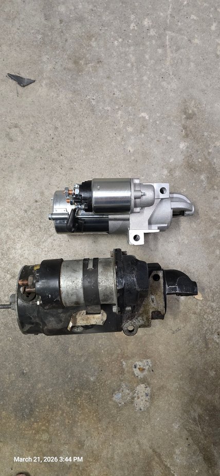

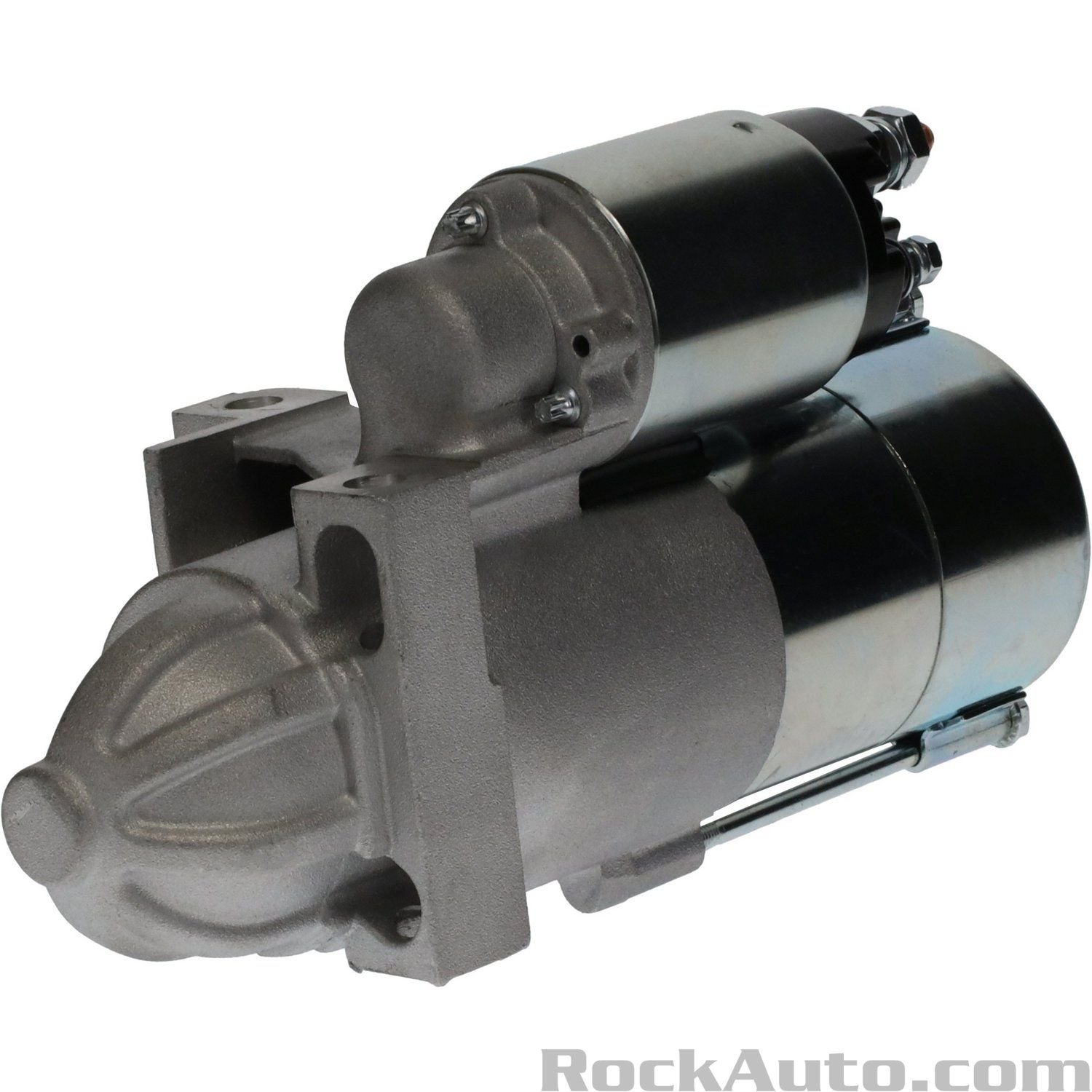

New Wai 3510NPG starter or PG260
Original style OEM Starter
Side by Side comparison.

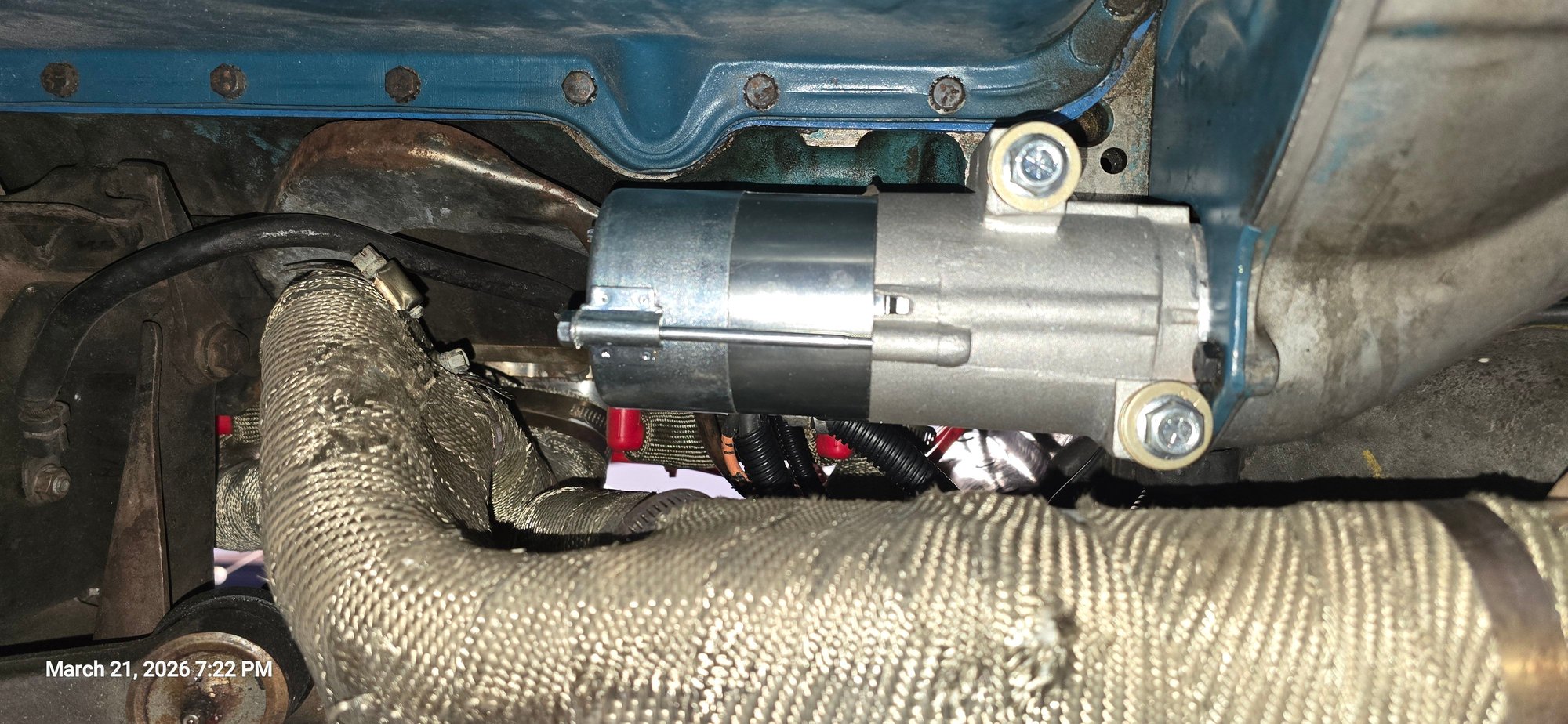

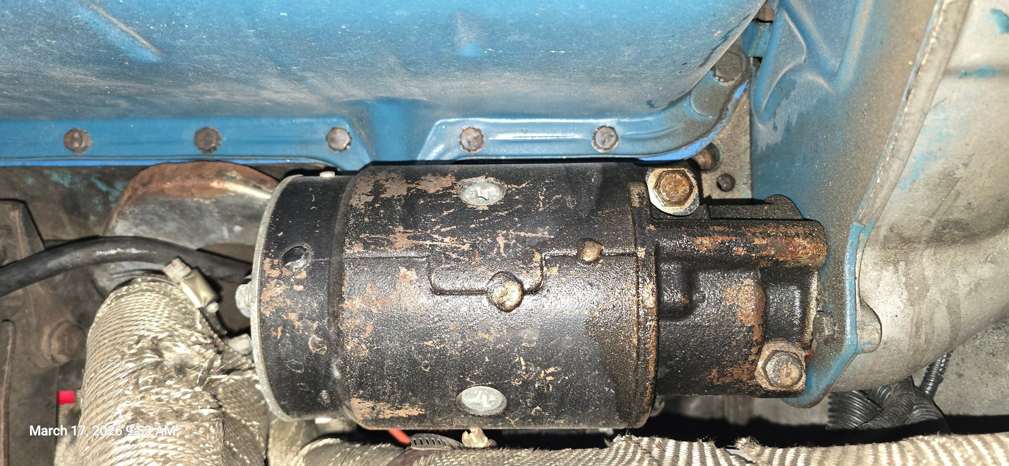

What I learned installing new starter. You will have to grind the around the nose a little to make it fit properly. Not that big of a deal. The bolts are included with the new starter, but you will have to put some flat washers because the bolts are a little too long. I used 2 flat washers per bolt.
Also your car will definitely sound different when cranking to start engine. My car now sounds like a new diesel truck very strong. Lol
Old Original starter pic from the bottom.  Amount of space taken up by old starter
New Start and the amount space taken by new starter
New Starter and amount of space taken.
