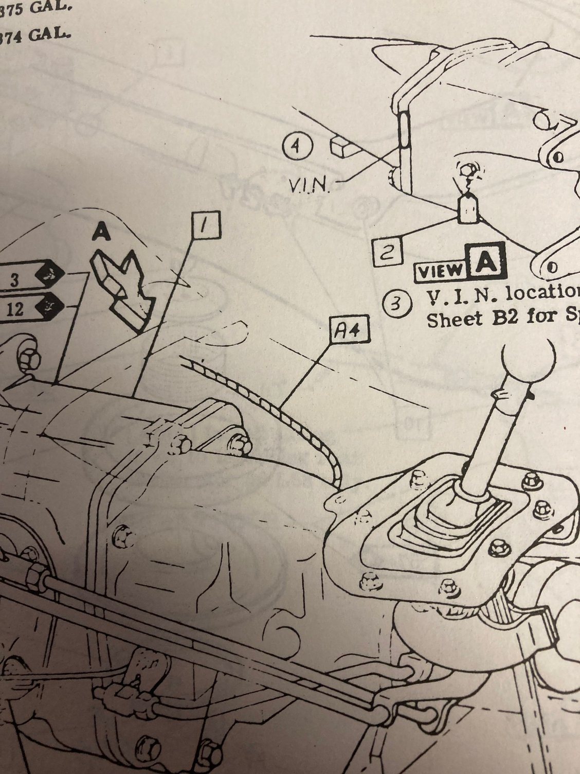

Ok I have checked the AIM, and I am…. Confused.
First, this shows speedo cable, but not where ot connects on the tranny itself
It states this simple as speedo cable “routing”

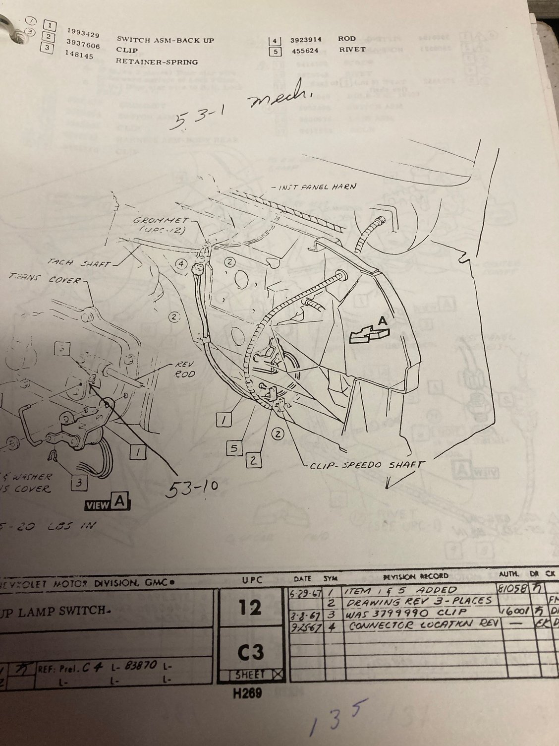

This appears to show the “existing speedo cable” coming over the top of the transmission, from the passenger side, going to the driver’s side

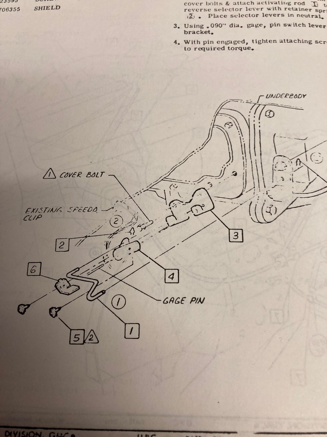

This appears to show the speedo cable coming from the passenger side running through the tranny tunnel, and coming up and going in from middle to enter the cabin.

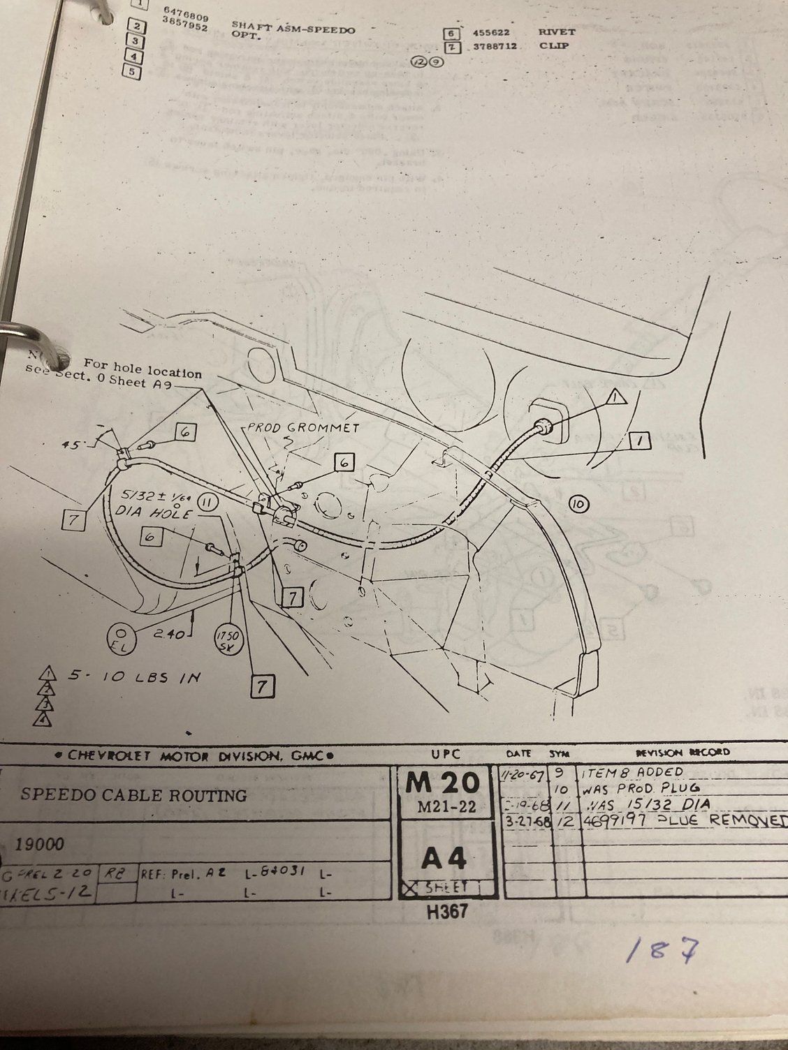

However, this view shows cable coming up on the drivers side and going in from the left, not the middle. Any help here?
