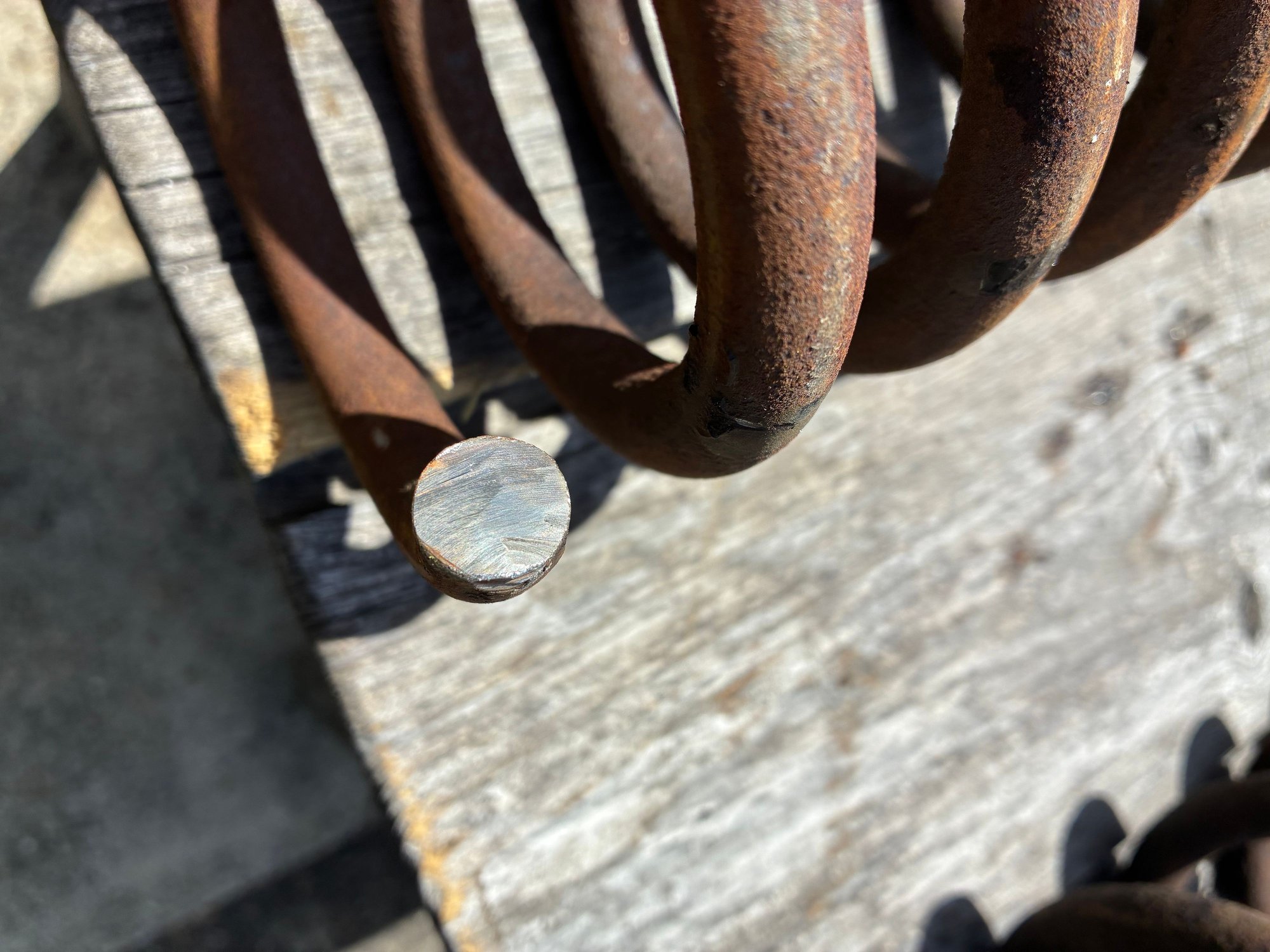

Got tired of looking at the nose up stance on my small block 73 coupe with manual transmission and no a/c. I suspected that the weight reduction from swapping out cast iron intake, heads, water pump and copper/brass radiator for aluminum units was the likely cause. The front ride height measured from the top of the wheel arch is 29”. I’d prefer that it be 27” so I figured I’d just pull the front springs out and cut off one full coil, simple, right?

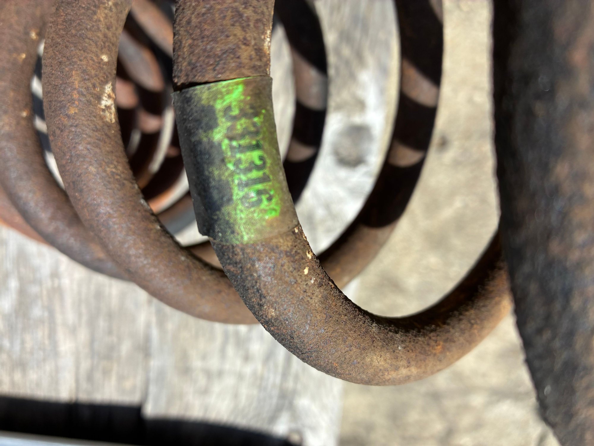

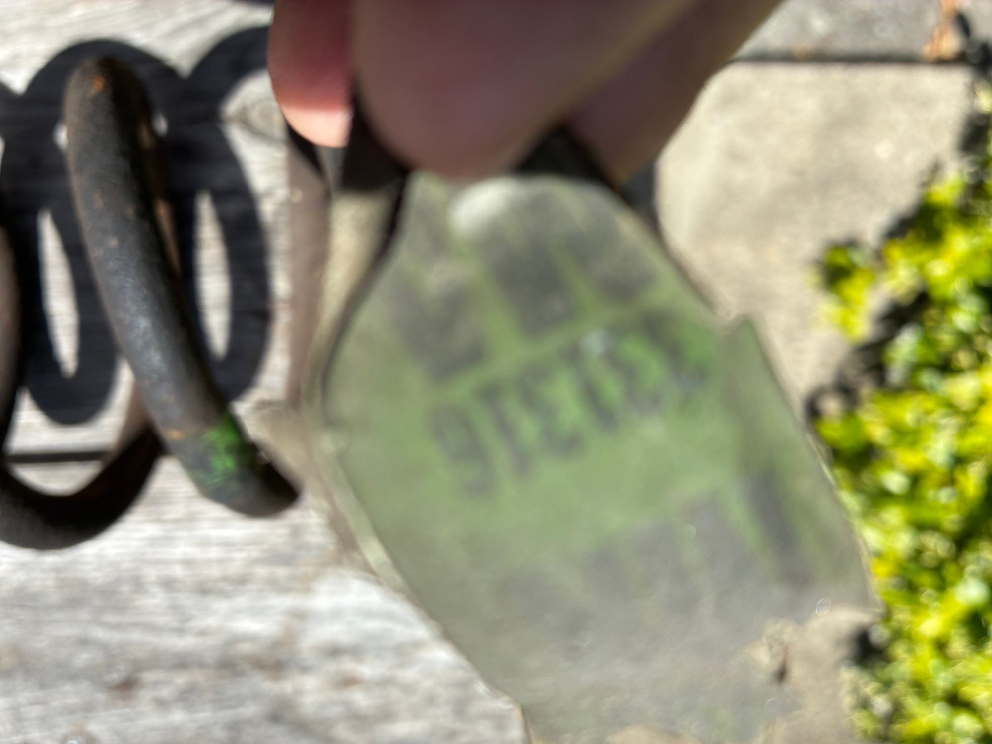

I just pulled them and was happy to see that both still had their green tape tags on them (331316 MA) but I noticed that one spring was shorter than the other. The shorter one off the passenger side had already been cut (fresh shiny surface). It looks like one full coil was removed based on the clocking of the ends relative to each other. The shortened one measures 15 3/8” and the other one is 16 1/4”. My research tells me that 331316 is the correct spring for my car and its free length should measure 15 7/8”.
I have no reason to believe that these are not the original springs and the front suspension retains all the original riveted ball joints which I’m going to R&R while it’s apart.
The car sat level side to side with 29” at the wheel arches despite having one coil off the passenger side. Why would someone in the past have done this? Should I just cut one coil off both springs as planned to achieve the 2” reduction in ride height and forget about what I saw?

Shortened spring
Shortened spring
Shiny cut end
Shiny cut end

Original PN tape tags

Hello Ken,
I agree that the ride height dimension of about 27" is good if the wheel/tire height is near stock.
Have you noticed that original front springs have some more CLOSELY wound coils at one end.
Which end of the spring you found had been cut?

Hi Allen,
yes I noticed that the top end coils are closer together. That is the end that had a coil removed and it’s the end that I anticipated cutting to achieve the desired 2” drop. I’m concerned that cutting an additional full coil off might yield more than 2” on the passenger side.
