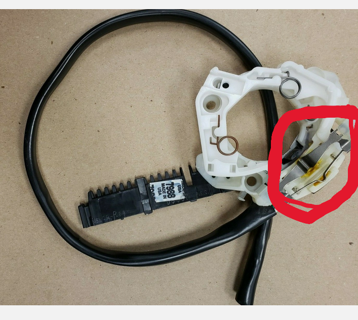

FYI, the 4 way flasher function of the TS switch is circled in red. The 4 way flasher **** is mounted in the center of that part of the TS switch. As you know, it's just a simple pull out to turn on, push in to turn off.
