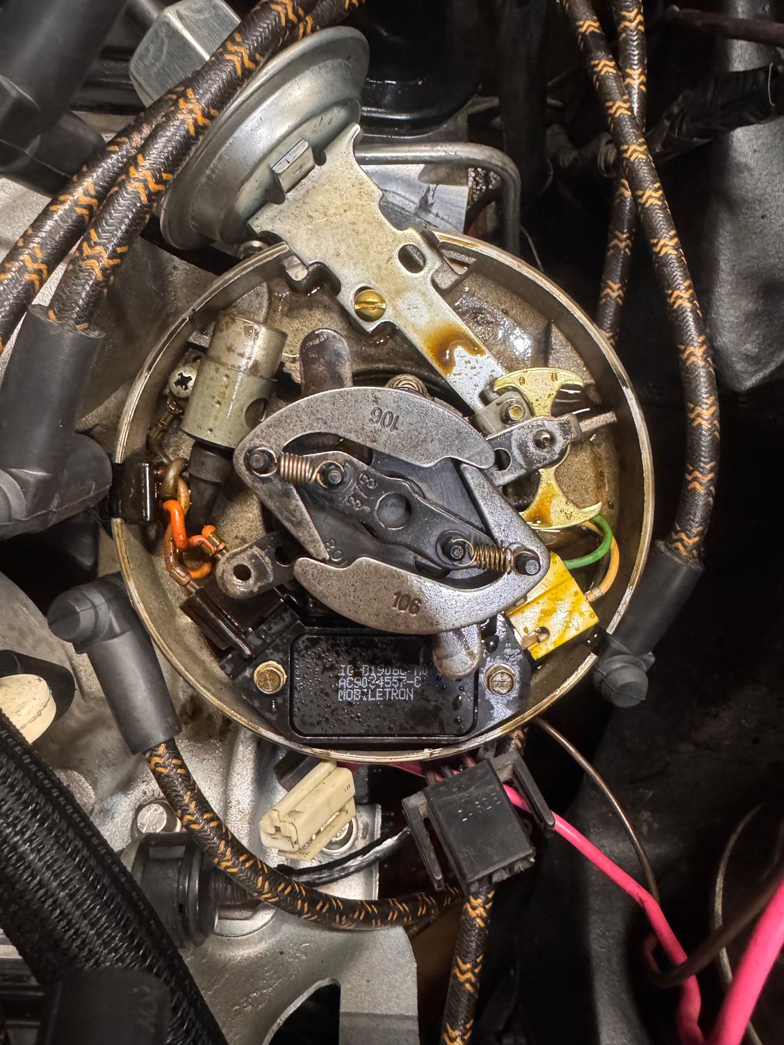

I checked the timing, it had advanced itself a bit. Idling at 34 degrees at idle. Set that back to 28, checked without the VA, 16. It drives better once it’s started obviously. But still not able to idle.

What is all the liquid in the distributor - antifreeze?

Oil, the only way it can get in there is from the inside through the seal with too much crankcase pressure. Same thing that’s happening in this thread.
I pulled the plugs on the passenger side, the drivers side was still too hot. It seems after my cleaning they look much better, nearly brand new again.
I’m looking into an adjustable valve, and new coil/module/pickup to try in conjunction. Looking into this, because it probably makes more sense at this point.
That link thread seems to be a different oil leak problem — his issue was oil between the distributor to intake surface mounting. How are you getting oil inside the distributor cap? For crankcase pressure to do that it would have to come up the shaft and get flung around. That seems like an insane amount of blow-by pressure such that it'd be pushing the PCV out of the grommet and have major oil leaking at every gasket, especially the valve covers.
Do you have a functioning PCV system?

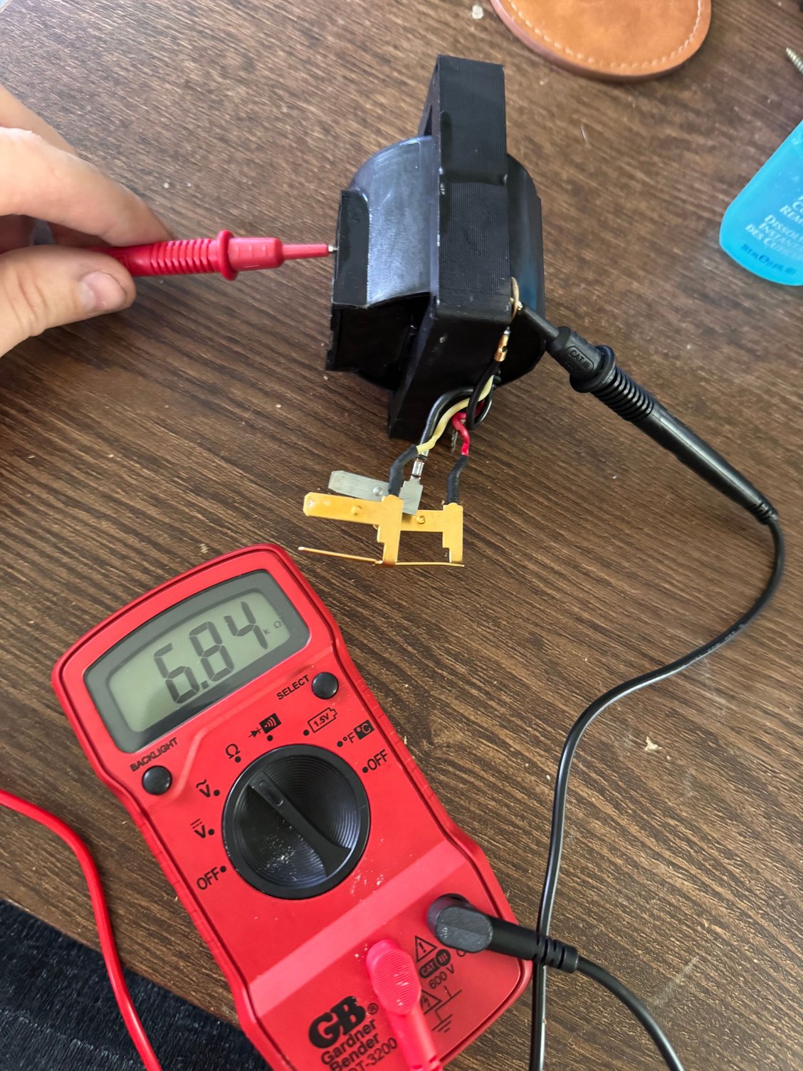

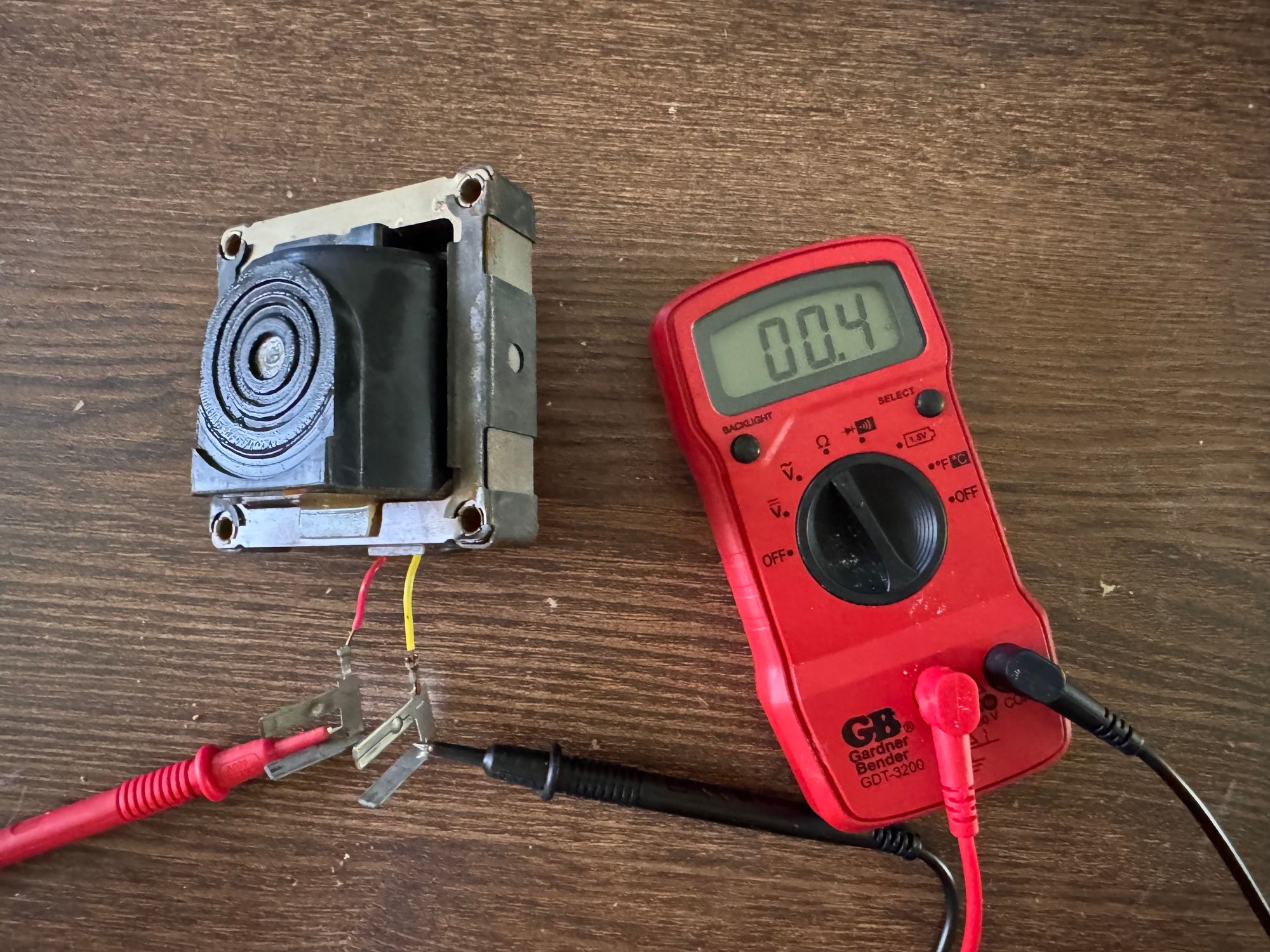

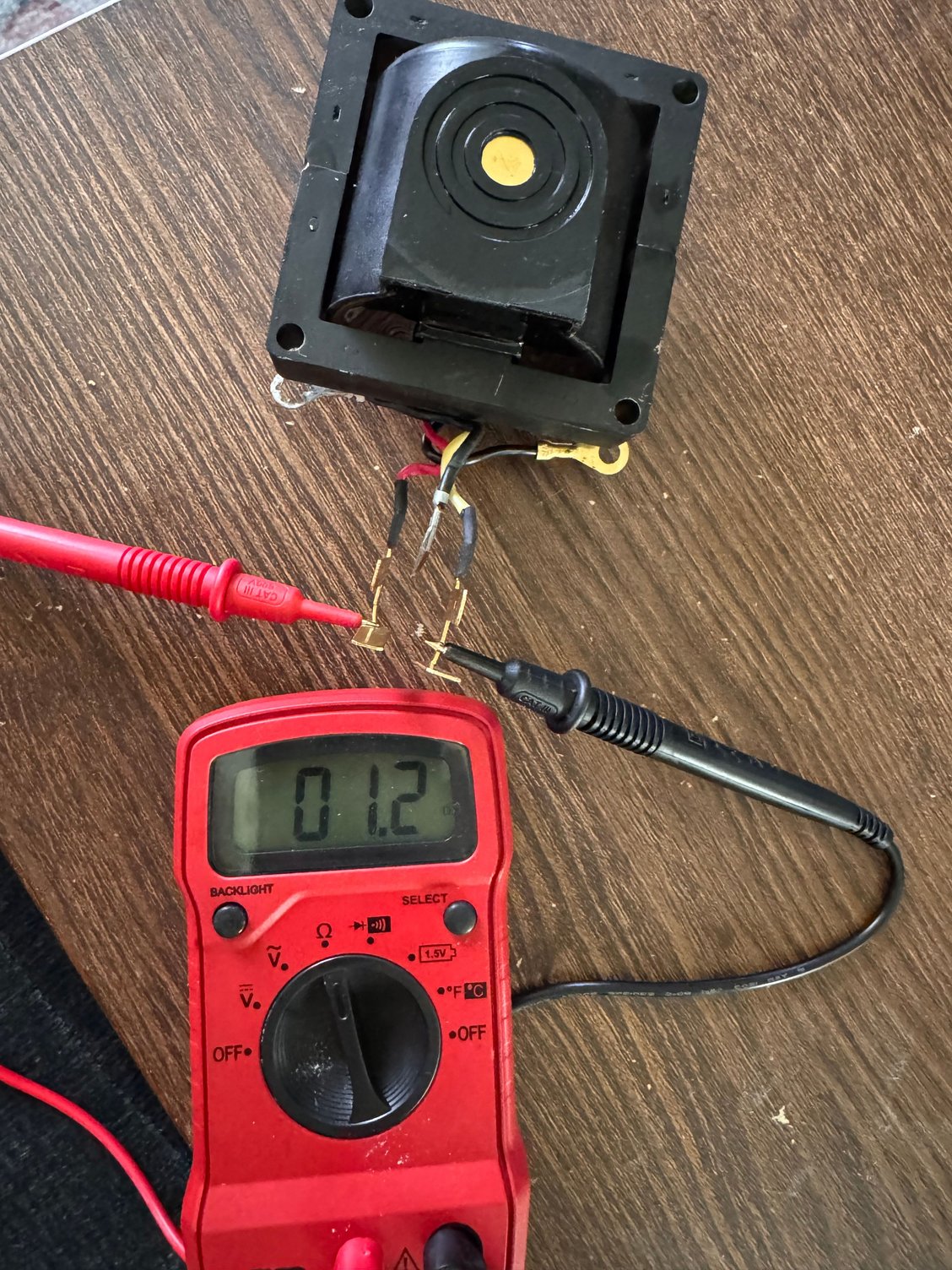

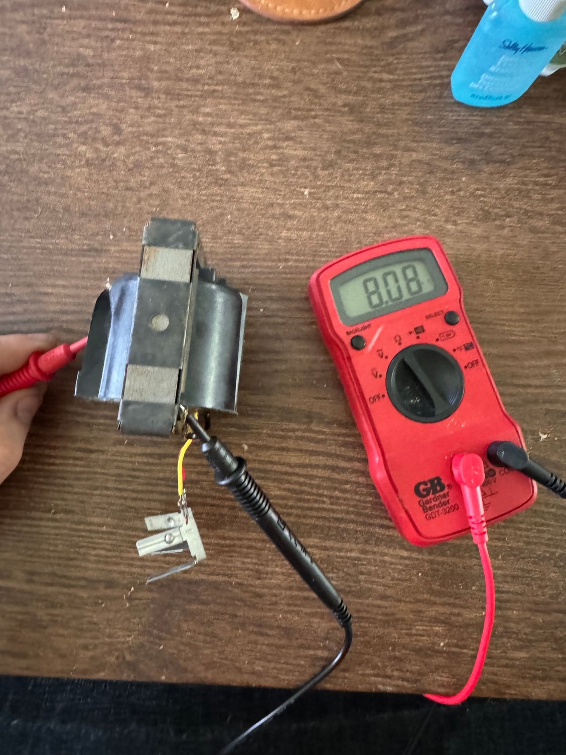

Originally Posted by Bee Jay
Ok, I started the car tonight. Ran it only long enough to set the timing. Then I look at the base of the dizzy, dammit, there's oil there. But I don't think it is leaking past the gasket seal. It looks like oil is making it's way up to the base of the dizzy, and leaking oil under the dizzy. There are four small holes there, and the oil is dripping out of them. WTF? Over.
Bee Jay
This sounds exactly like what I’m experiencing. Up into the housing then down onto the intake and back of the block. I wasn’t having these issues before though, I believe it’s related. PCV is in the drivers side valve cover with a breather in the other.
I checked the circuits in my new coil, they looked good.
Primary circuit, .6 to 1.5 is considered good
Secondary circuit, 6k to 10k is considered good
Old coil primary, no bueno
Secondary circuit looks alright, but that doesn’t really matter at this point.
I’ll clean out the housing, and try a NAPA/Echlin module to see if it makes a difference.

Put the Echlin module in. Started it up. It ran rough. On the test drive it was quite shaky, like it wasn’t firing on all cylinders.
Plugged the #3 spark plug wire back in because I forgot I unplugged it last night.
Running like a top now. 100% better.
