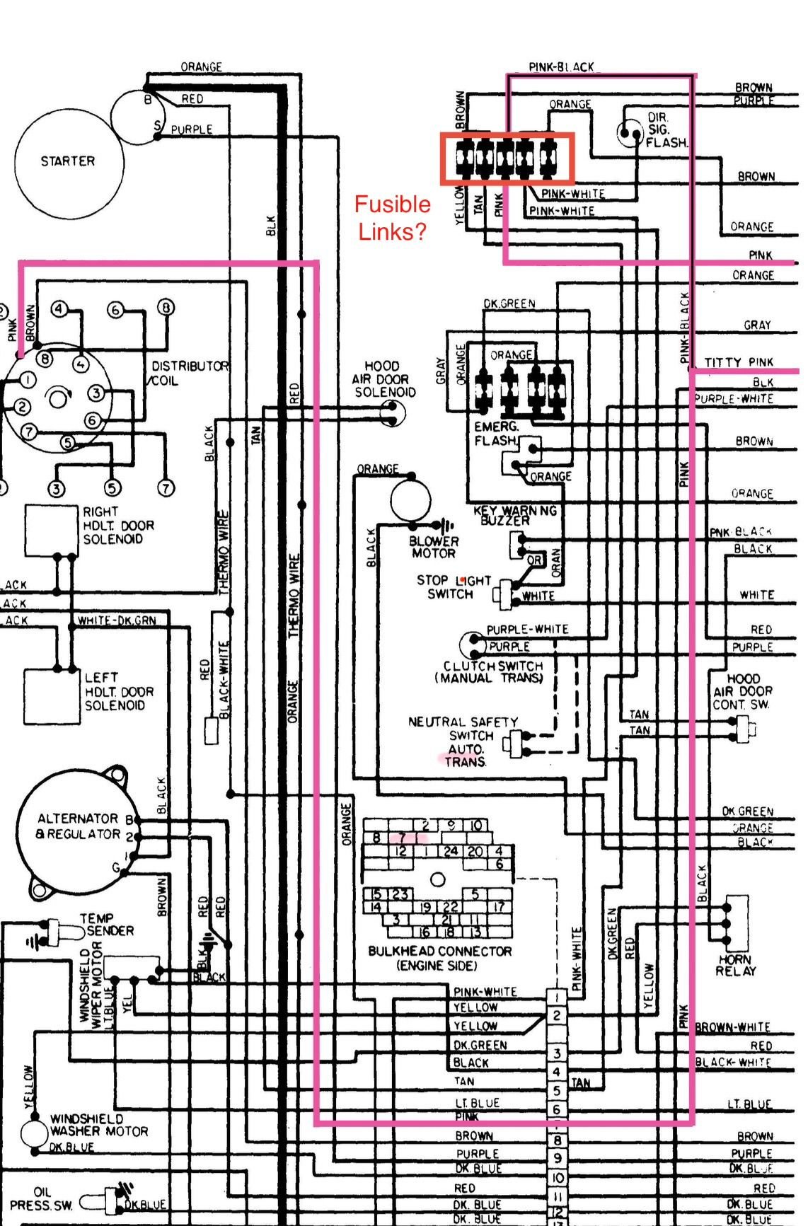

After tracing the wiring diagram it looks like the distributor power wire also powers all the gauges. Could an intermittent ground or failing fusible link be causing my issues? If running the distributor directly off the battery didn’t make the engine run better I wouldn’t think so, but it could possibly explain how the two issues are connected.
It looks like the titty pink wire is what connects to the switch in the steering column. If anyone has any pictures of what titty pink is supposed to look like my PMs are open.

The Titty Pink wire is what I believe people refer to as the fusible link wire that controls the voltage in the old points ignition systems.
Its always been a problem for people who switch over to electronic or HEI distributors because it cuts the voltage from 12vdc down to 10.5vdc to protect the points.
It’s generally in the electronic or HEI installation instructions to replace that wire and run a new wire from a 12vdc source at the fuse block.
Many people don’t replace the wire and may not have any starting or running issues for a long time, then suddenly they have starting and running issues until the fusible link pink wire is replaced and connected to a good 12vdc source.

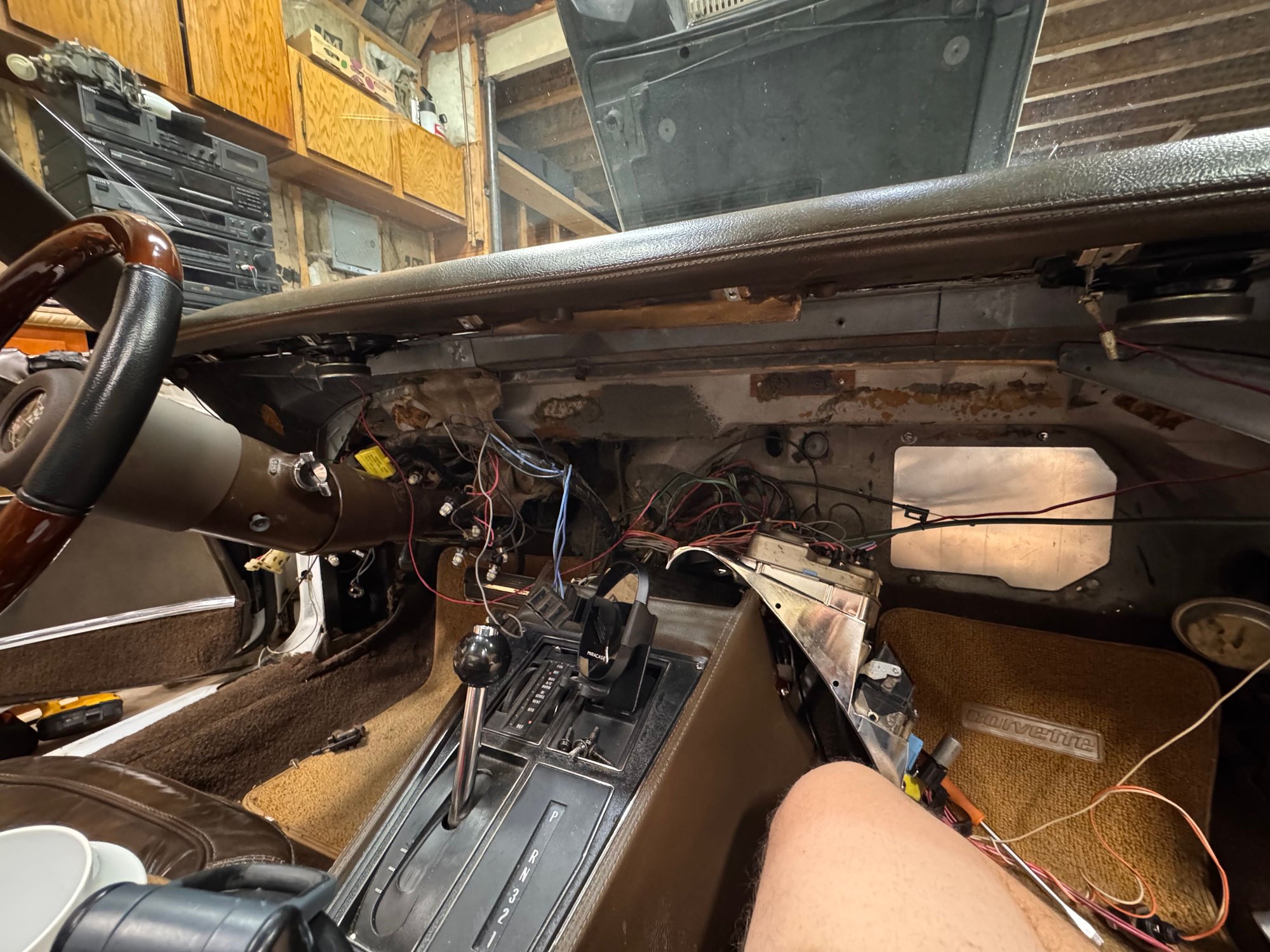

I took the passenger side dash out to gain access to some of the gauge wiring. I don’t have any HVAC in the way so I could actually see quite a bit. Didn’t see any burnt wires or anything else out of the ordinary though.

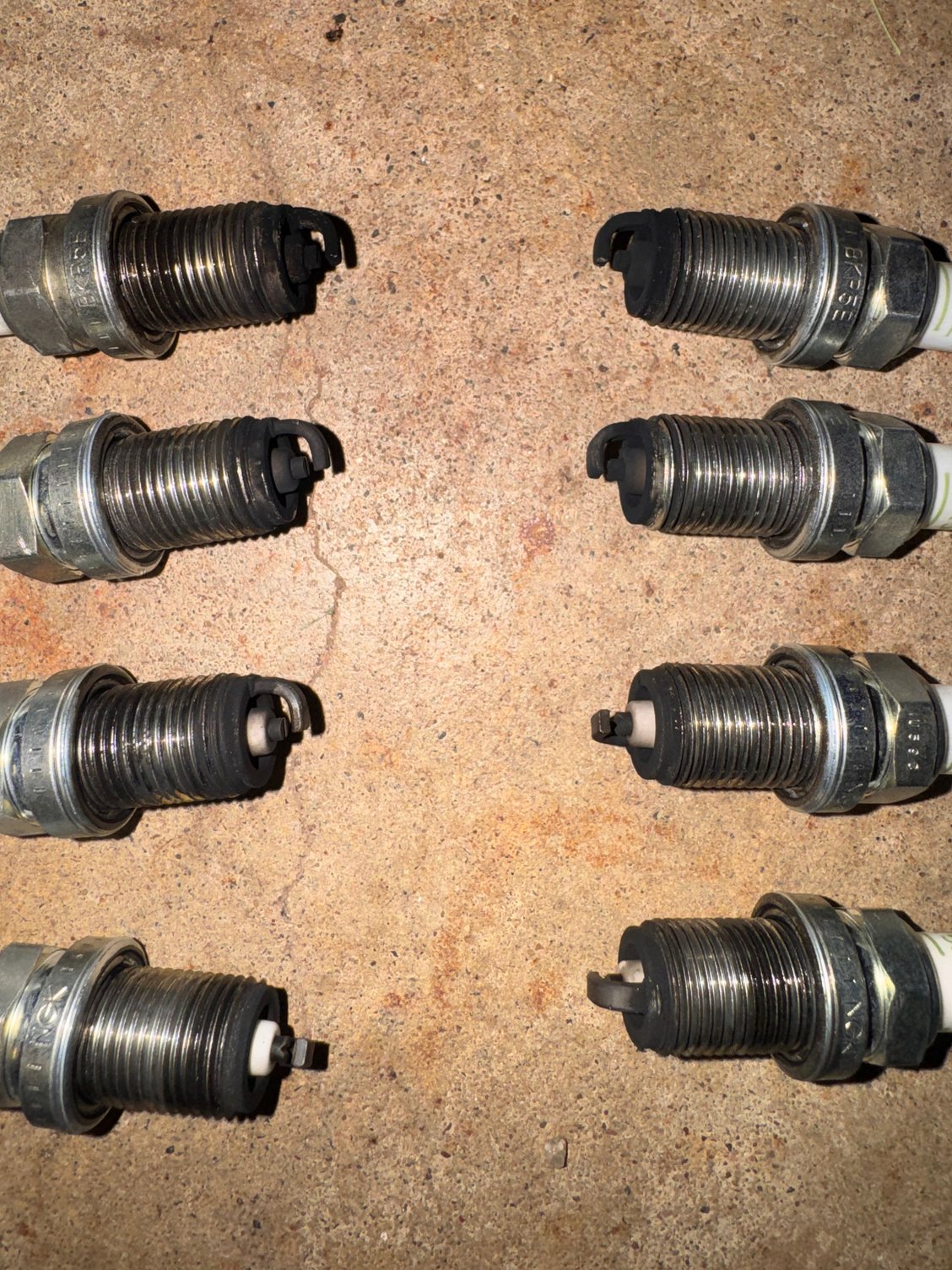

Well the new coil seemed to do the trick. Much smoother, although with a little bit of engine shaking missing still. Well enough to take on a trip around the block and revving it up a bit. Afterwards it got even better, so I suspected the new plugs were fouled from running with a bad spark. Sure enough, we had some good ones and some bad ones.
The darkness of the plug was directly proportional to how hot the header tube was where it came out.

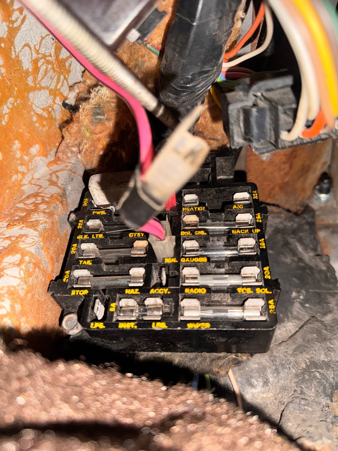

As for the gauges, I tried an another fuse which worked for about half a second. Then I found this. I’ll have to get my wiring diagrams out again to see how it truly goes, but I don’t think the black/pink wire is supposed to tie into the (titty pink?) wire in two different spots then house wire nut into a scarily thin red wire which then plugs into the lamps terminal of the fuse box.
Rest assured this will be fixed before I hook the battery back up or start the car again.

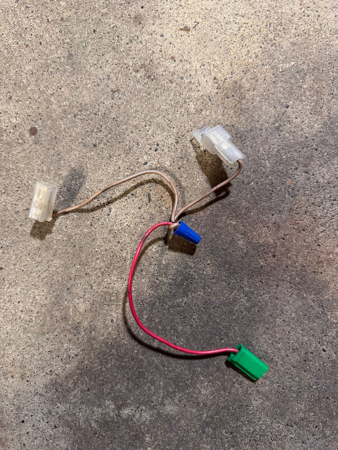

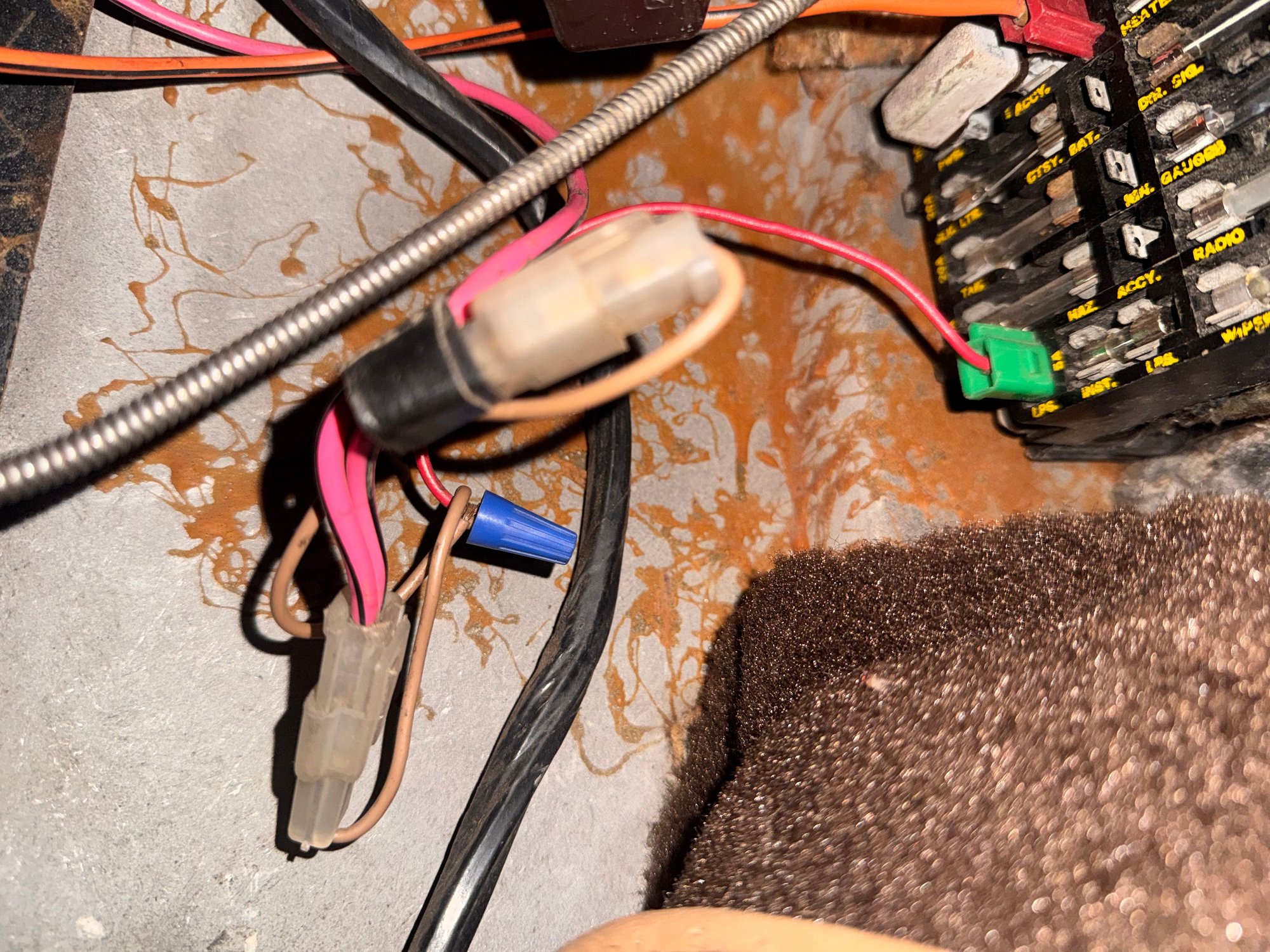

What even is going on in that picture? Does that red wire get REALLY hot (and immediately burn a fuse)? AFAIK, PNK/BLK is related to the ignition key and seatbelt warning buzzers. Perhaps these got repurposed by a PO? Or the buzzers have a dead short? If you pull that red lead out, does your fuse still blow? Do you lose any functionality?
Old May 5, 2026 | 10:29 PM

My post #22 shows the black/pink wire being the spot where it splits from the ignition switch and goes to power the gauges. The other half of that T is the power wire of the distributor.
I took the weird octopus out and hooked up the black/pink wire directly to the ignition terminal. Is this how it’s supposed to be? I’ll look for my more detailed wiring diagram book here shortly.

I know the OP didn’t do it!
Never, never use twist on wire connectors.
They are manly designed and used for solid household ac wiring and not for stranded wiring.
Either use solder, solder splices or proper crimp on connectors.

I suspect the “creative” wiring modifications were made when a previous owner made the power windows able to be used with the ignition off. Luckily with the ignition hooked into the proper port I didn’t run into any issues. The car is running pretty good at this point. Still not all the way as well as before, there’s some occasional misfires, but with an Italian tune up and some WOT runs I hope to clear the carbon deposits from the combustion chambers.

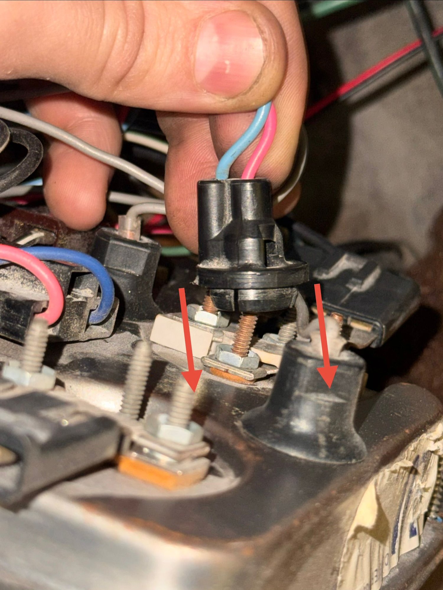

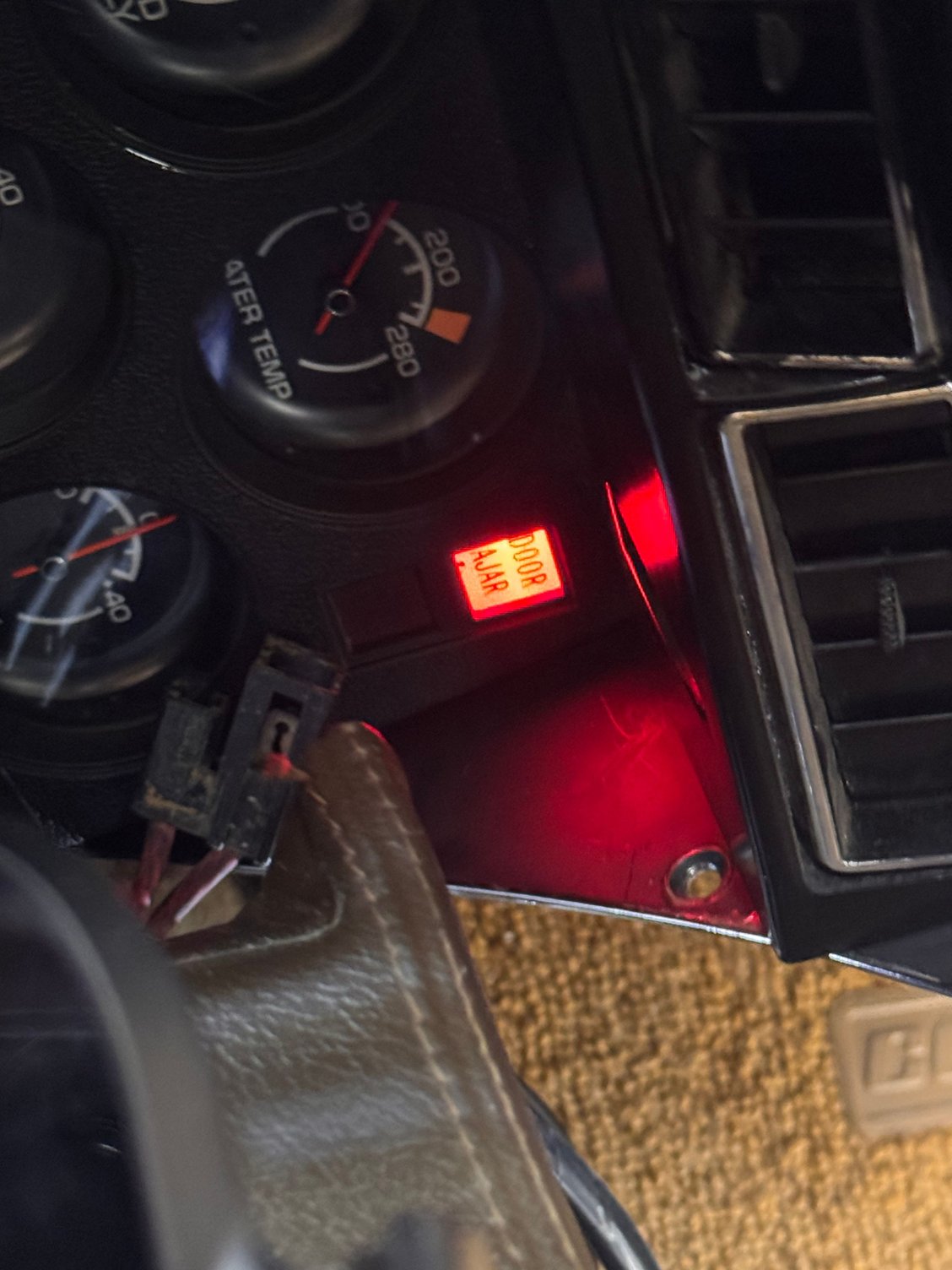

I think I’ve solved it!
Some idiot at some point couldn’t get the door ajar light to turn off, so he removed the light bulb. When I took the gauge panel out I found the socket all the way on the stud for the temperature gauge.
That definitely seems like it could cause a short. Fed the box my last 10 amp fuse, and it worked! The oil pressure and water temperature gauges went to their default positions rather than maxed out in either direction. I broke a socket for a different bulb, so I’ll have to replace that first, but once it all goes back together I’m fairly confident it’s a good fix. What a weird/awful coincidence that this happened at nearly the same exact time as my dead battery.
Luckily I didn’t have to tear it down too far to find this.
