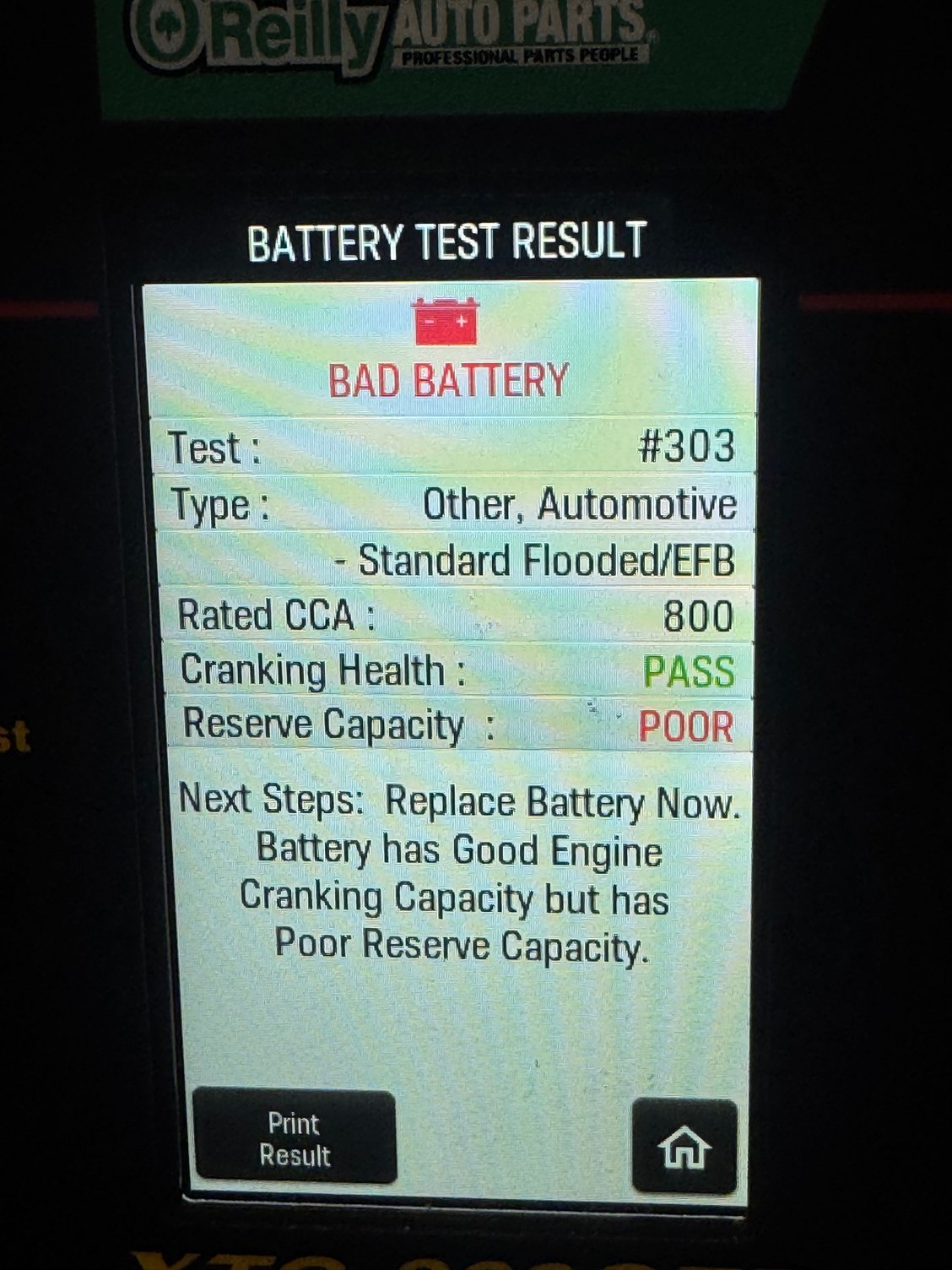

Fusible links looked good, took the battery in for a load test. This was the result.
Off to Costco for a new one.

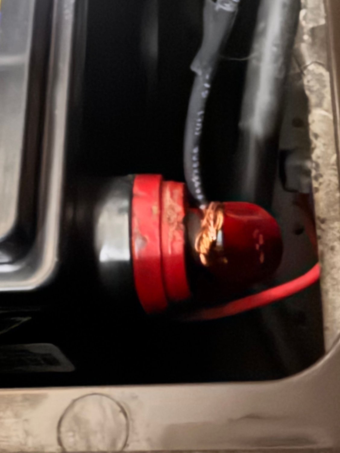

Jump came from a box (this one) and was put positive to positive then negative to negative.

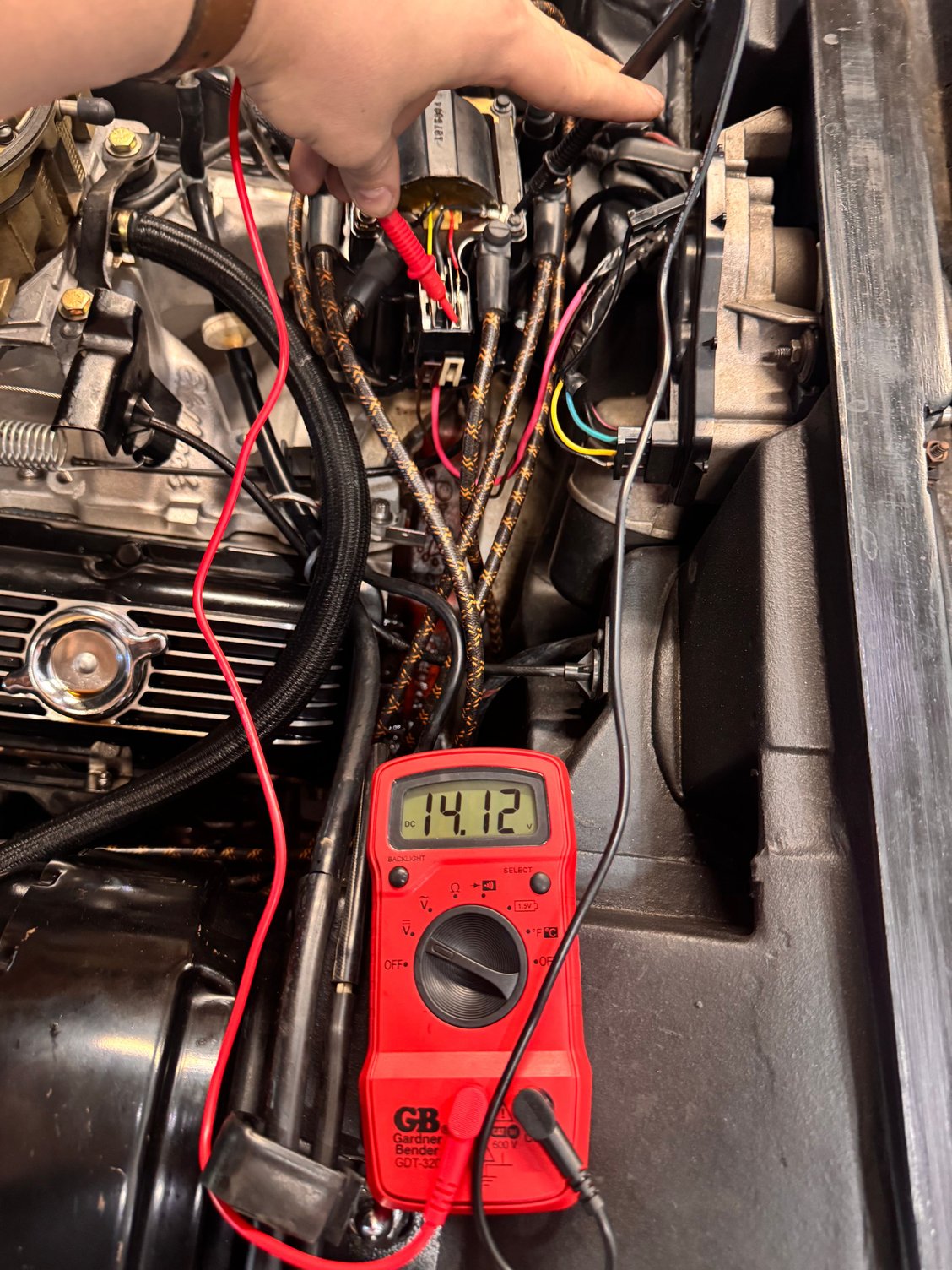

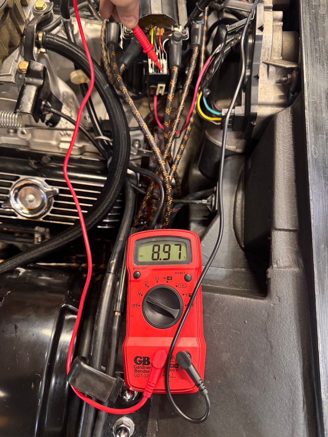

Reading at the distributor I’m getting between 8 and 14 volts. Not good I would assume.

14.2 V at the alternator sounds good. If it goes up a lot when reving the engine that could be bad. Doubt your issue is with the alternator. Good clean voltage to the distributor is important however.

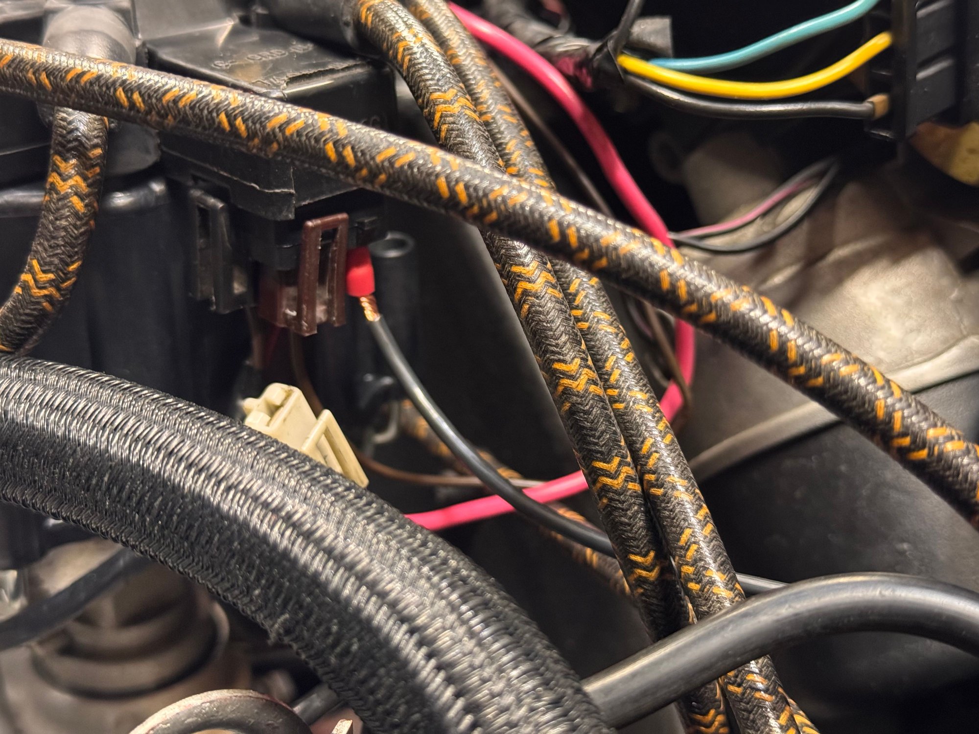

A quick and easy test. Take a couple yards of wire. Crimp a female 1/4" spade terminal on one end. Connect the other end to the positive terminal on the battery. Run wire out the window and to the distributor. Plug it into the positive terminal on the distributor.
Now the only way to shut down the engine will be to disconnect this wire.
Start engine.
How does it run now with constant 12 -14 volts?

Runs with a consistent 14.2 volts at the distributor when set up like this. No issues being able to shut it down though. It still won’t idle without constant throttle.
