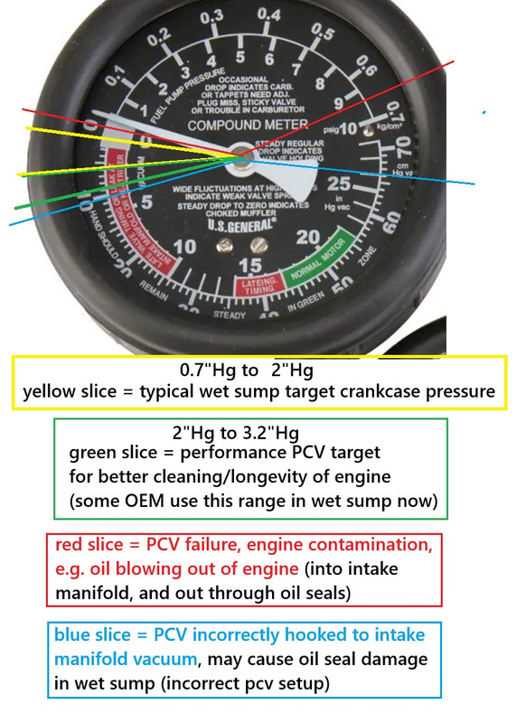

PCV valve flow depends on the specific engine make up
For example when the piston rings are worn and blowby has increased, a larger pcv valve orifice is needed to flow more crankcase byproduct volume
A PCV valve is not one-size-fits-all and needs to be modified or adjusted (sometimes by running two pcv valves in parallel for example)

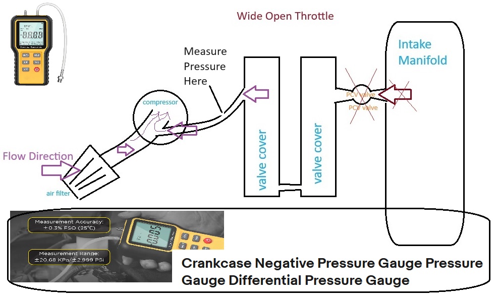

The correct way to determine how much pcv flow (crankcase flow) is needed at idle, cruise and wide open throttle, is to measure the crankcase pressure
Crankcase pressure needs to be set to approx 0.8" to 2.5"Hg at all times to maintain a vacuum in the crankcase at all times
Anytime crankcase pressure rises above roughly 0.25"Hg to +0.01psi (above atmospheric) crankcase gas will contain large oil droplets and push oil through seals causing oil leaking, engine smoking, oil pushed into the intake manifold, oil spray, etc...
This is target Crankcase pressure as shown on a pressure gauge
you can use a 1-bar map sensor to get an idea of the crankcase pressure
for example
https://forums.holley.com/forum/holl...nhg#post417512
Or use a pressure gauge of appropriate resolution
wide open throttle crankcase pressure is measured after the air filter where the air filter tube attaches to the crankcase on all OEM engines and this should be set and maintained more precisely as the engine becomes more performance oriented.

It only works at part throttle by design.
I appreciate your love for pcv but lets add to that. The OEM pcv systems work at part throttle and wide open throttle by design.
The way it works is the crankcase is tied to the air filter tract which all OEM air filtering by design pulls 0.8" to 1.5"Hg at wide open throttle on the crankcase which is about the same or more than it does evacuate at part throttle via the PCV valve.
This is why people complain about oil inside their intakes after going 20 or 40k miles with an aftermarket over-sized air filter - the lack of an inch or two of mercury pulling on the crankcase at WOT causes all kinds of mayhem in the crankcase - oil stays in piston rings and is pulled up to the chamber on the intake stroke. Light hydrocarbons leave behind sticky hard carbon on rings which seize and ruin cyl walls causing smoking and ruined engines. Crankcase pressure pushes oil into every seal and causes leaking and oil floods baffles which is then picked up by the pcv valve route after WOT ends. And so on.
PCV is full time, not just part throttle, but people ruin it with ignorance.
