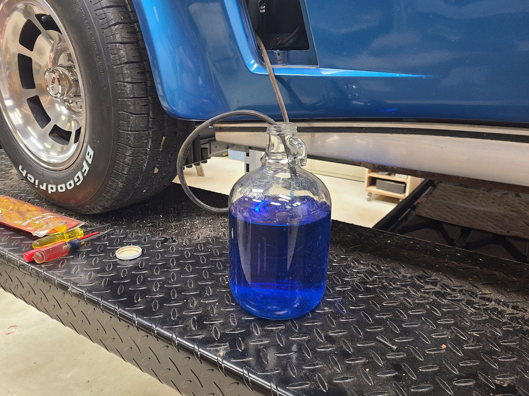

With no idea if the washer fluid tank would gravity drain one can just try. I removed the hose at the T and plugged it then pulled it out of the louver hole and sure enough it drained out. So that's step 1 to get the washer pump out. I think the color is a bit too dark...
