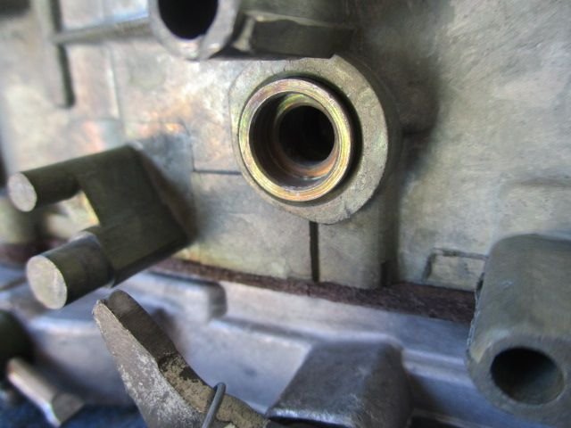

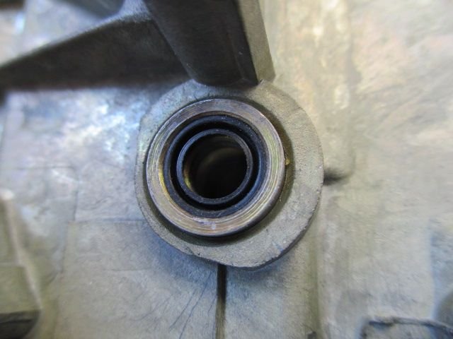

Originally Posted by stingr69
Might be good to show us the right way to install the choke shaft seals. Some Qjets have 2? None of the DIY videos I have seen show how to install them.
Your wish is my command!
The M4M (intergral choke) Q-Jets used on Vettes from 1975 through 1981 use a shaft between the choke coil and the lever on the choke actuation rod. This shaft also actuates the fast idle cam and handles control of cold fast idle. There are 2 seals on this shaft: One seal is in the carb float bowl body, and prevents dirt and dust from getting into the carb. The other seal is in the choke housing, and prevents ingestion of dirty air into the housing, since the carb pulls a slight vacuum on the housing in order to pull the hot air from the manifold heat exchanger into the housing to heat the hot air coil. These two seals need to be installed the right way in order to do their job, and the correct seals need to be installed.
The first seal is installed into the float bowl at this location:
The second seal is installed into the choke housing at the shaft penetration hole:

The seal in the housing seals against air coming in from the outside, so the "flat" part of the seal is on the inside of the housing, with the "V" facing towards the outside of the shaft hole:
