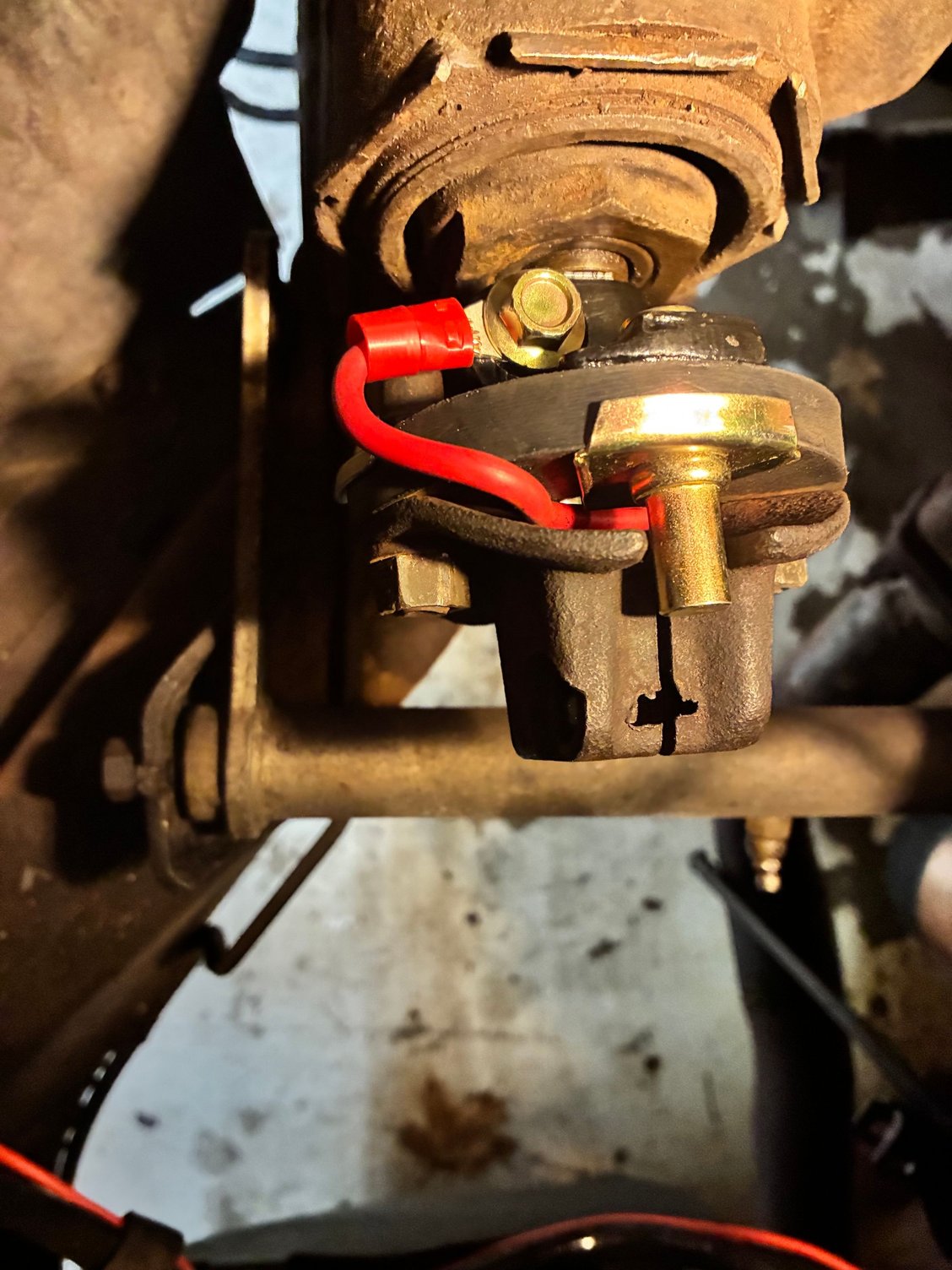

While replacing the power brake booster on my '69 Vette I noticed the 55-year-old steering rag joint was in bad need of replacement. I ordered a replacement lower steering coupler which comes with the new rag-joint riveted to it from Zip Corvettes. It looks like a good quality part with 2 exceptions, One, the bolts that were included with the coupler were both 5/16. The original has one 5/16 and one 3/8, so I removed the old ones from my original and used them. That problem solved. The other problem, the new lower coupler did not come with a ground strap to make continuity between the lower coupler and the upper. It would seem to me that the ground strap is an important component for proper grounding of the steering column
.. I know improper grounding can cause headaches, so I made up a ground strap to connect the upper and lower coupler together. I know it won't pass NCRS judging but at least my horn should work. I would welcome comments. Do y'all think this was even necessary?

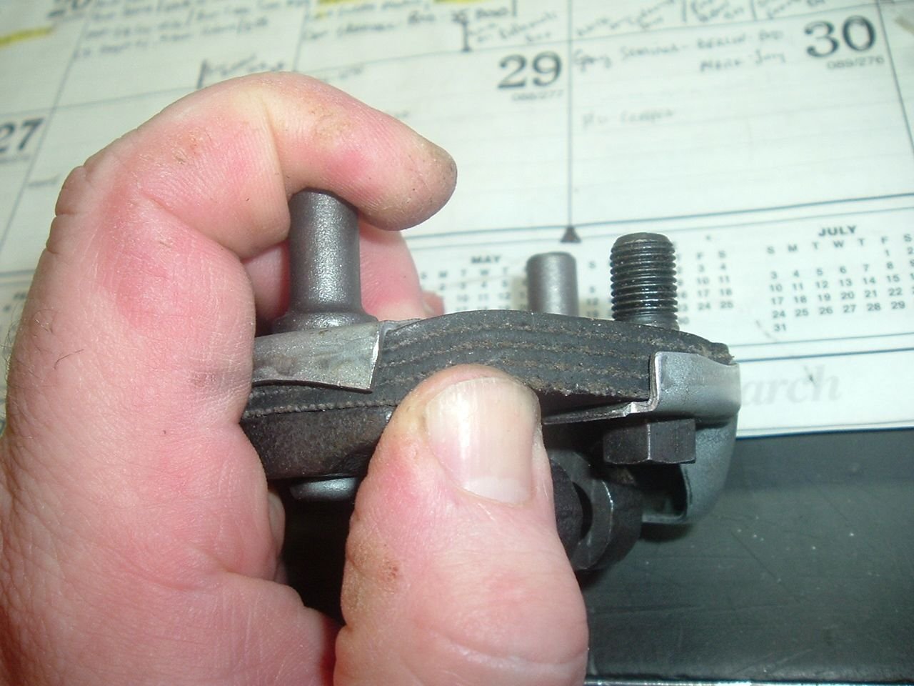

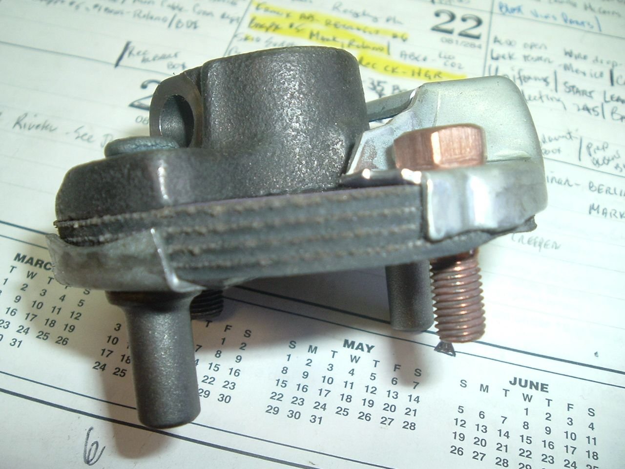

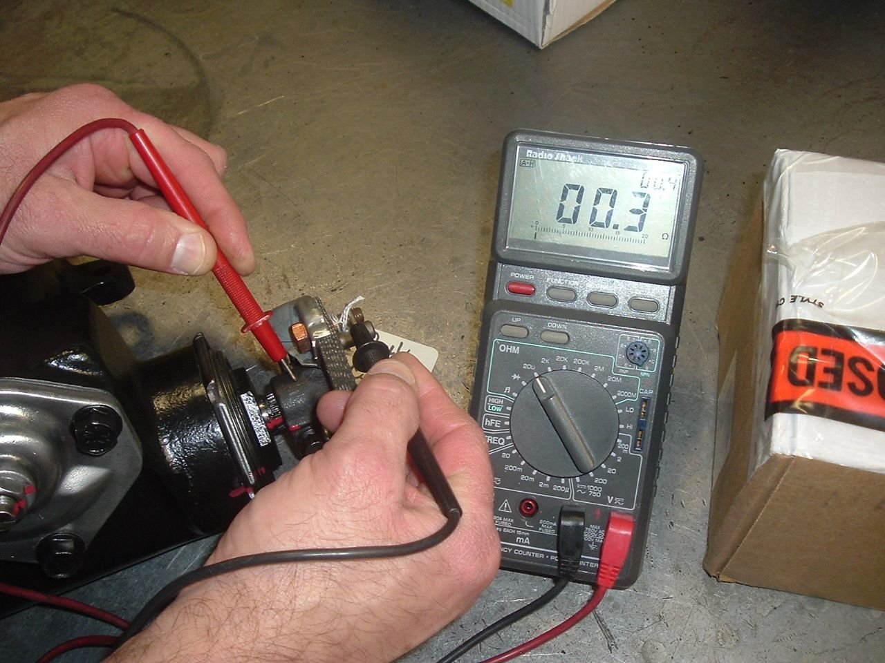

The originals were multi-layered rubber, firm like a tire. The one you have is a sold puck. They were originally grounded with a beryllium copper strap between the halves,which broke before the rag worn out most of the time. Then by '72 they were revised to an impregnated screen on the material and this worked much better. The horn would probably still work but you might get a shock on the steering wheel spoke, as I did with my car years ago.

With the solid rubber coupler, you do need a ground strap, I've done the same thing as you. Just need to make sure it doesn't catch on anything as you rotate the steering wheel.

The original style ground straps are available separately.
What you made should work just fine..

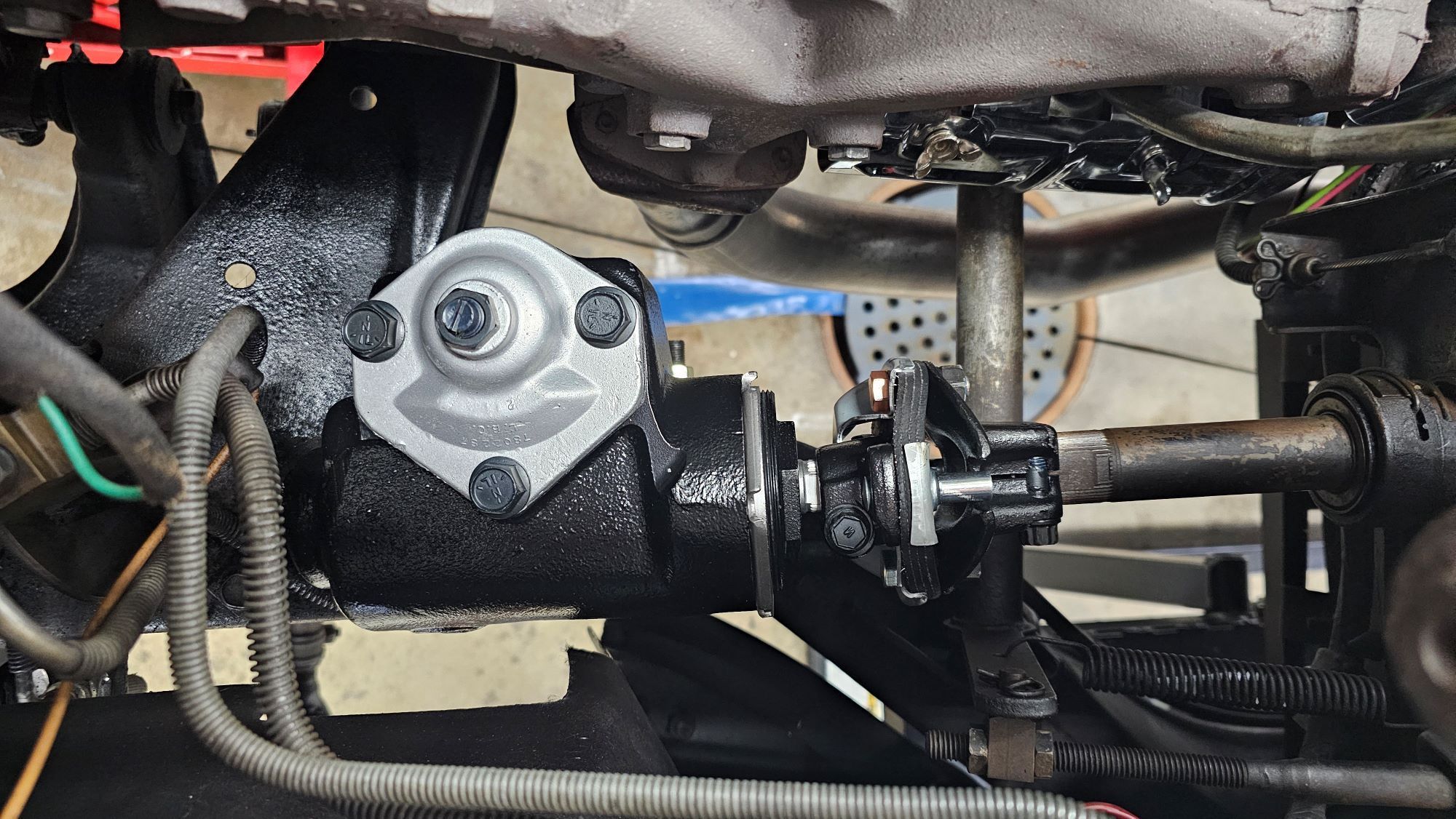

Recently replaced mine. Looks like the original.
