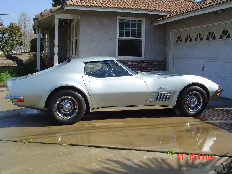

I have 235's in the front & 255's in the rear.
