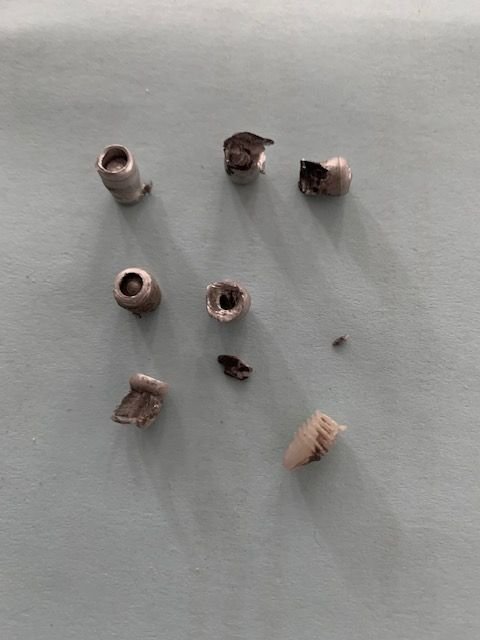

We've had some rattles in our T-tops ever since we bought the car 3 years ago. Nothing I really hear on the road but things that I could hear anytime that I took the T-tops out. Since I had them off for other reasons earlier this week, I decided that today was the day I would try to silence the rattles. I searched the forum here and found many posts similar to this one. I went the route of drilling a 5/8" hole in the rear corner of the panels in an area that would still be covered up by the rigid snap-in headliner. Here are the goodies that I got out of mine.
I found 6 rivet backsides, one plastic post (probably from the weatherstripping that many others have mentioned), and a few minor pieces of shrapnel which are probably fragments of the rivets. I don't have any idea why the picture tone looks like it does but it sure makes the rivets appear to be copper; trust me, they were definitely aluminum.
All my rattles are now gone... except for one which is some sort of item that's loose but captive. If I had to guess, it's a backing nut for a screw --- a screw which has its head under the weatherstripping somewhere. It will rattle if I really shake the T-top but it will not budge from where it is no matter how many gymnastics I put the T-top through. So, it will stay there until such time that it becomes totally free and then I'll fish it out like I got the others out.
